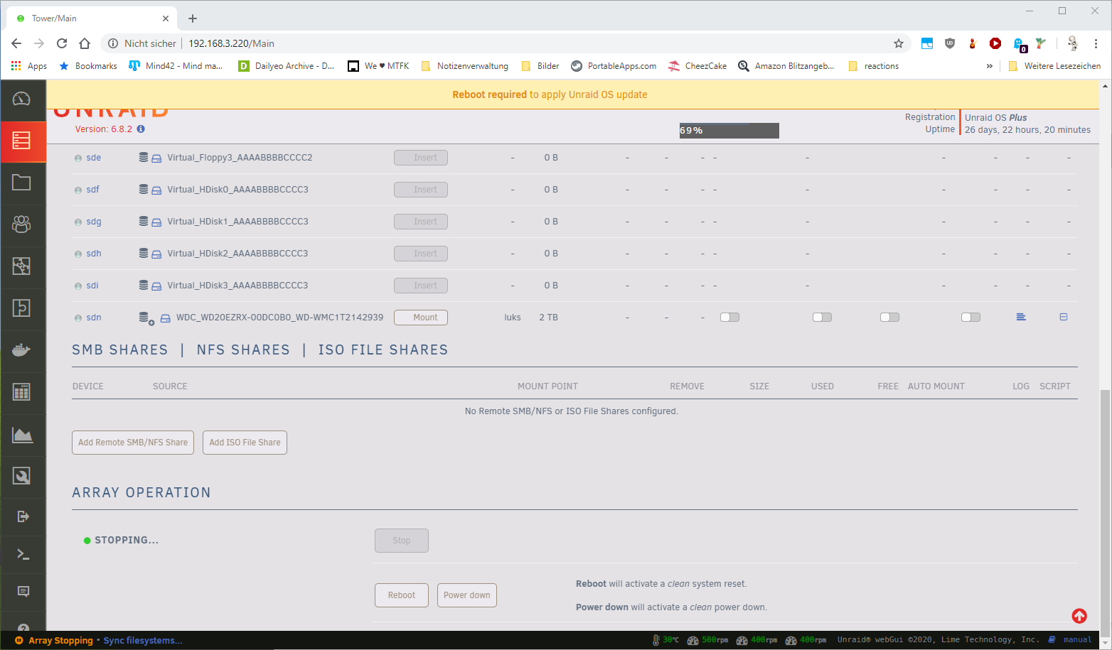

Stuck at "Array Stopping - Sync filesystems"
I downloaded and installed 6.8.3 and wanted to reboot the system because the update told me to and now the server is stuck while stopping the array.
What should I do?

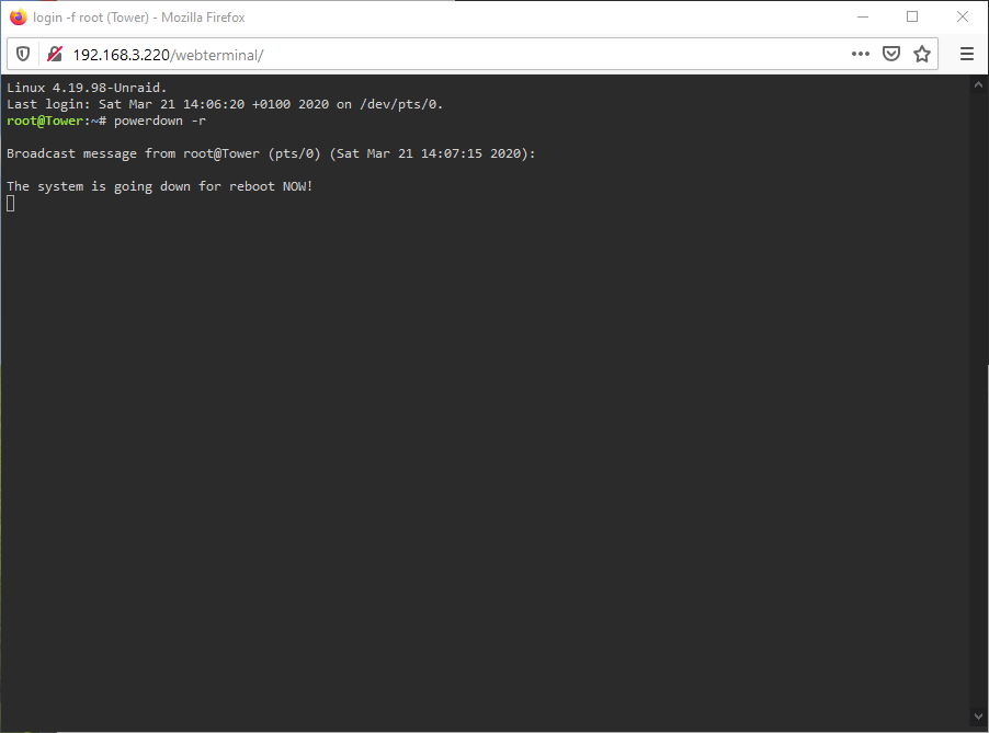

Since it's stuck for some reason, you can't really do anything other than hard reboot.  From the terminal, this *might* help
powerdown -r
(But, it does appear that the drives have all been successfully unmounted so you *should* be good.
Thanks for your answer but now it is stuck in powering down for over 10min.
