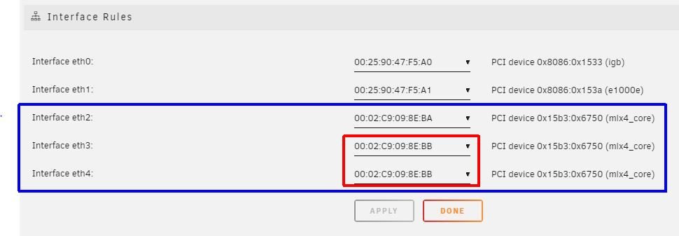

I have two identical Mellanox 10G cards in my servers (Xeon & Tower).........
The problem is that one server (Tower) seems to have created a "phantom 10G NIC" using the same MAC address twice.........
This has worked previously. I dont know at what point this has happened. The card appears to be installed ok but I can't connect to it either across SMB or a ping....

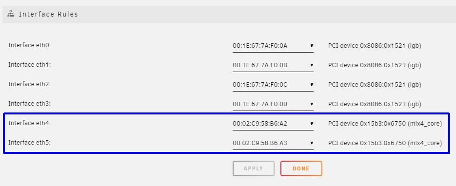

This is compared to my happily working Xeon server............
Any ideas as to what's happening here please?

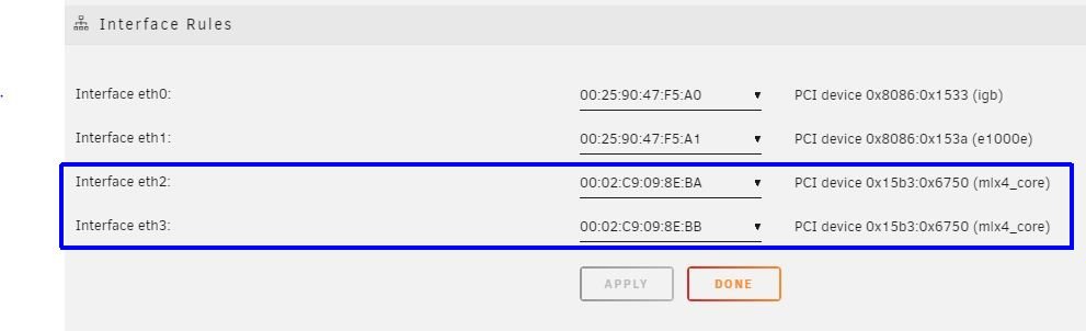

I got it back to "normal" by stubbing it through to a VM, rebooting it, and then removing it . It reverted back to just the two entries on reboot............

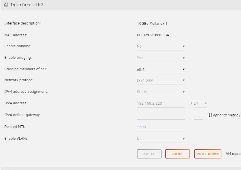

I can't address it for the life of me though........... it appears absolutely normal.......

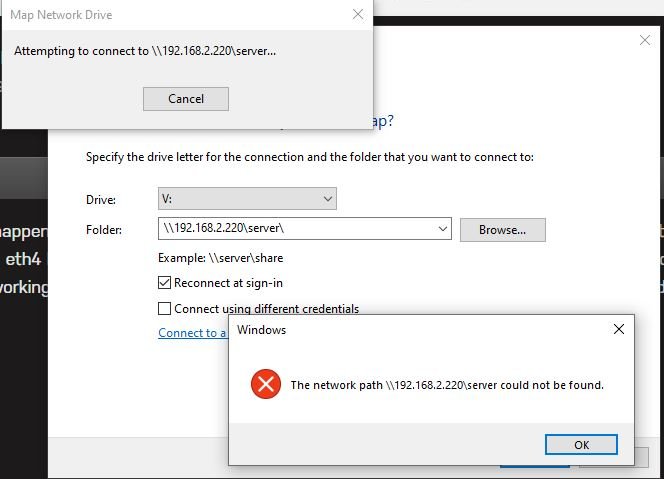

but refuses to be addressed by a ping from the other server or networking a drive from my windows pc.
The ping times out....... The windows "map network drive" looks forever and eventually times out.....
