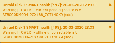

One of my disks got two warnings:
Warning [TOWER] - current pending sector is 8
Warning [TOWER] - offline uncorrectable is 8
Capture.thumb.PNG.f0036536d37059ff843a42cfb7f5aca3.PNG2Capture.PNG.9b49c8ae1e731a36952f40a54698c7ce.PNG
Don't know what it means but ran a short smart self test and it completed without errors
Is this anything i need to worry about or should i just close the warning and forget about it?

@PetterH your first post requesting help should always include the diagnostics zip file by going to the Tools tab, clicking on the Diagnostics icon, and then clicking on the Download button and uploading the zip using the choose files link below. Ideally you would also include any recent changes to your rig that may have precipitated the issue AND any troubleshooting steps you may have taken. Without further information I'd say order a replacement drive ASAP. Personally I always keep a precleared hot spare ready to go, stress testing a new drive takes a lot of time and I prefer to run with an emulated disk for as little time as possible.
You should run an extended SMART test.

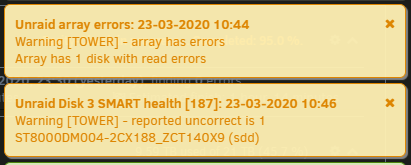

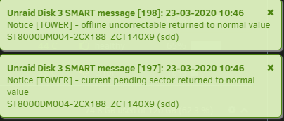

So yesterday i got these notifications and disk 3 is now only displaying this in the attributes tab
5Capture.PNG.fd38fffcaef0c955096d7060304106b1.PNG4Capture.PNG.492480022cacf9396727bb2b1347c4e9.PNG

Are the read errors before or after the SMART test? Extended SMART test passed so disk should be fine for now, but if the errors are after best to replace it.
Before
OK, then I would keep the disk for now and give it a second chance, but any more errors in the near future replace.
