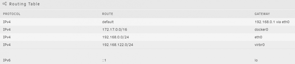

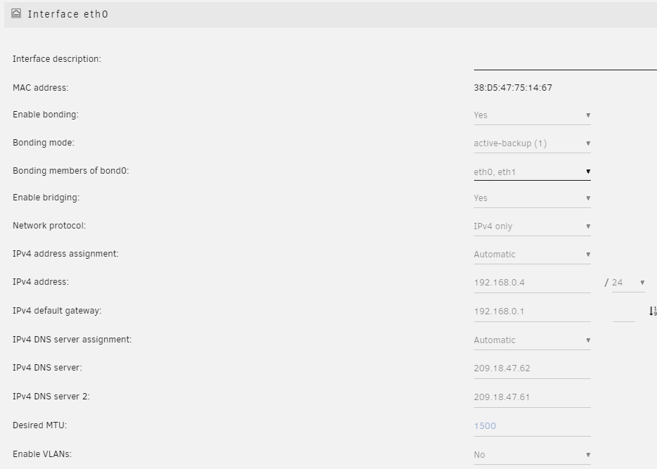

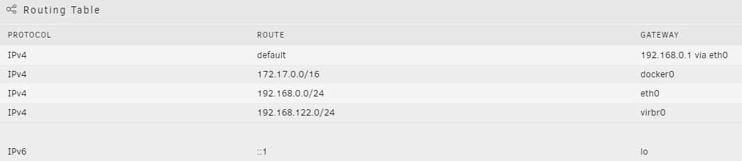

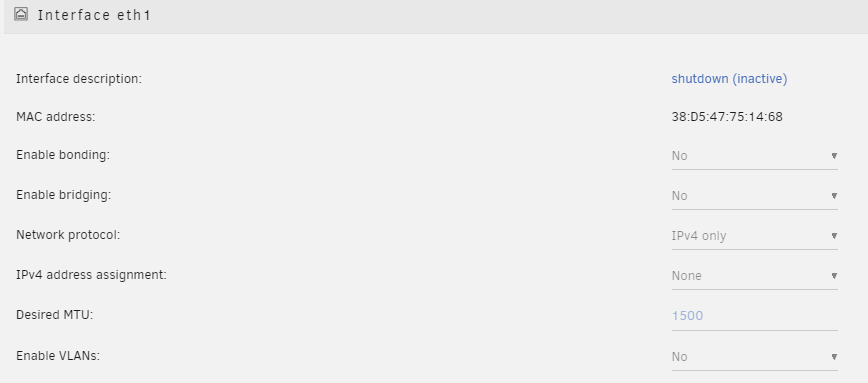

March 22, 20206 yr I recently needed to power down my server for maintenance and updated Unraid and Plex before powering down. When I powered back up, I found I could log into the Unraid dashboard fine, and the Plex docker was running but Plex app says my server was unreachable. I hadn't changed any network settings, but was getting a message that "Interface 0 was down". I've exhausted a number of things trying to troubleshoot this googling for help but have not gotten Plex.tv to see my server again. I'm at a total loss on how to get Plex reachable again. Unraid 6.8.2 # Generated settings: IFNAME[0]="" DHCP_KEEPRESOLV="no" DHCP6_KEEPRESOLV="no" BONDNICS[0]="eth0 eth1 eth2 eth3" BONDING_MODE[0]="1" BONDING_MIIMON[0]="100" BRNICS[0]="bond0" BRSTP[0]="0" BRFD[0]="0" USE_DHCP[0]="yes" IFNAME[1]="eth1" PROTOCOL[1]="ipv4" SYSNICS="2" # PCI device 0x8086:0x1533 (igb) SUBSYSTEM=="net", ACTION=="add", DRIVERS=="?*", ATTR{address}=="38:d5:47:75:14:68", ATTR{dev_id}=="0x0", ATTR{type}=="1", KERNEL=="eth*", NAME="eth1" # PCI device 0x8086:0x1533 (igb) SUBSYSTEM=="net", ACTION=="add", DRIVERS=="?*", ATTR{address}=="38:d5:47:75:14:67", ATTR{dev_id}=="0x0", ATTR{type}=="1", KERNEL=="eth*", NAME="eth0"
March 22, 20206 yr Author Yes, using the terminal I can ping 8.8.8.8 successfully. It also pings google.com so DNS resolution is working.
