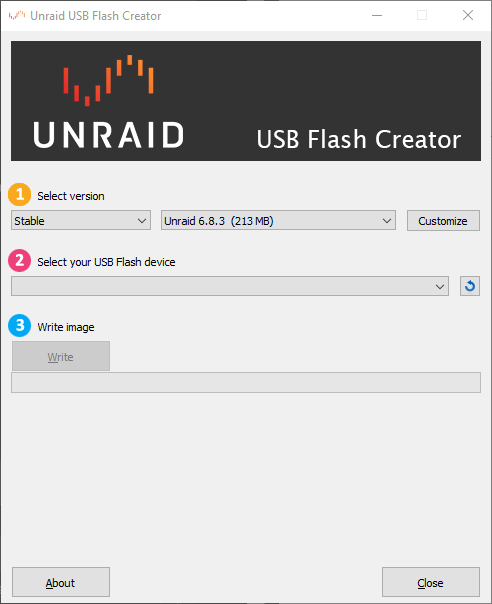

USB creator not seeing USB drive.
I have a SanDisk Ultra Fit 256GB USB drive.  It's formatted for exFAT@4k with the volume set as 'UNRAID'.  Win10, latest updates/patches.  I've tried a couple different USB controllers on my machine but it doesn't change the situation.  No listed USB devices in the USB creator.

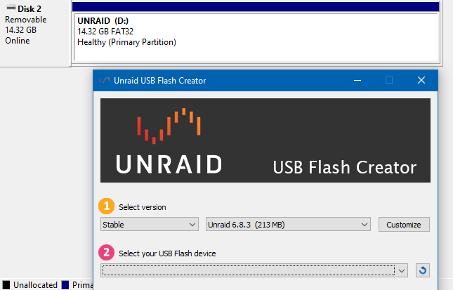

The installer seems to be a bit picky on Windows.
I had the same problem with a SanDisk Ultra Fit 32 GB USB 3.1.
Formatted as FAT32, renamed it to "UNRAID" and then UnRAID installer just refused to see it.
However.
Moved over to my Macbook, refortmatted using the Disk Utility, started the UnRAID installer and it popped up straight away. Installed no problem.
This is not the first time I've run into problems with FAT32 partitioned disks and Windows 10 either so it could be an issue on M$'s side.
Go figure. 🤷‍♂️

Interesting. Having the SanDisk Ultra Fit here, too. And its the same problem. The Creator does not find it:
I've tested executing the Creator as Admin and re-formatting the flash drive as well. I even used an USB3 to USB2 adapter cable to force the flash drive to work as USB2 device. Had no problems with other USB2 or USB3.x flash drives.
