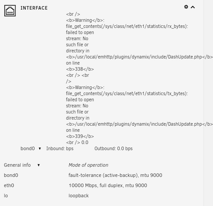

also, any ideas why this is appearing on my dashboard?
Are you running any kind of ad blocker? If so whitelist your Unraid GUI IP and server name.
Hmm, I do have Ad blocker disabled in Google Chrome but still the same error. No problems with it in Firefox and Edge.
Flush the Chrome cache and it should work
That did the trick! Thanks!
