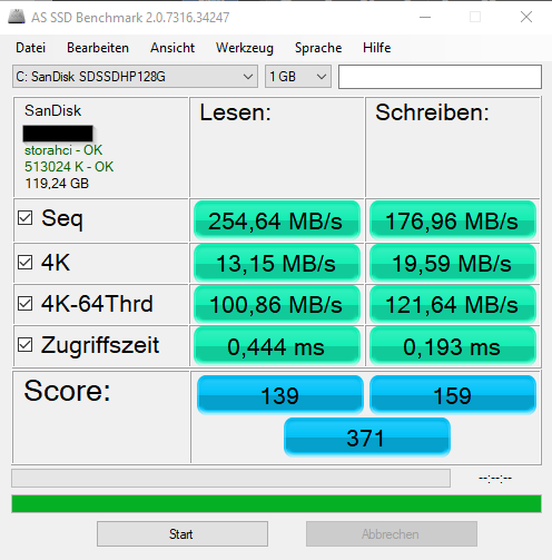

ok, it seems my windows ssd has problems... copying cache disk share > windows data-hdd = ~ 70-80MBps (still slower than write?)...
Do you have another desktop/laptop you could test with?
not today :)
ssd benchmark seems normal:
i'll keep you updated (tomorrow)!
