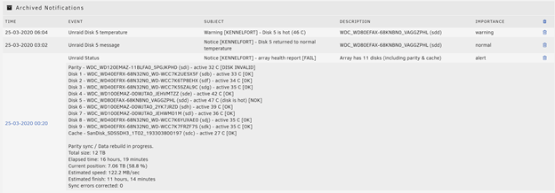

7. When I woke up I saw a single error message:
8. I also noticed that there was an alert on the drive:

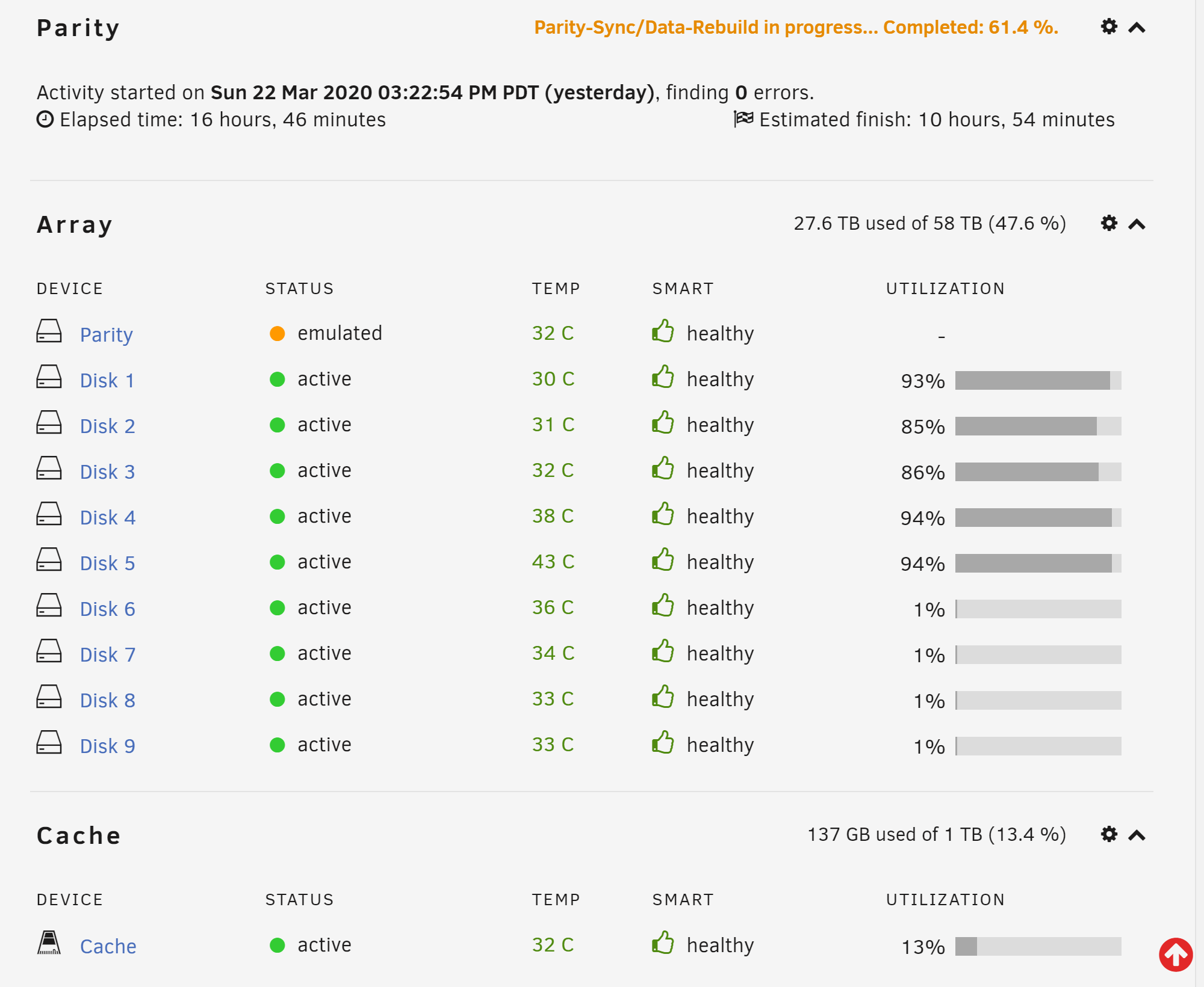

9. As you can see here, UNRAID thought it was running Parity-Sync all night and had gotten to 61.4% complete and was still going.
10. I was tempted to allow it to finish the parity sync, but after reading some posts on Reddit and here, I cancelled the check. Stopped the Array. Unassigned the parity drive. And Started the array again. The status of the array was fine. No errors.

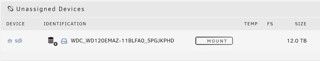

11.  The drive showed up as unmounted and unassigned:

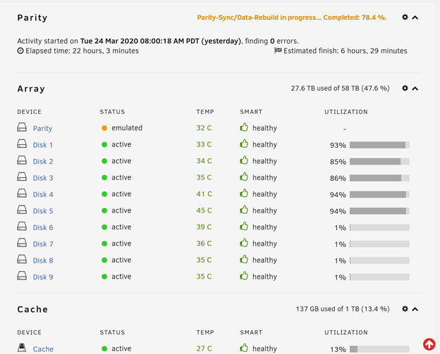

Hey @itimpi, my parity sync is up to 80% now.

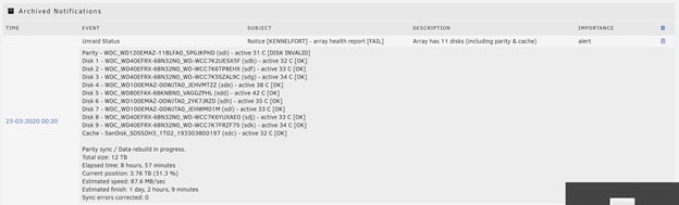

Last night I got this error and I wondered if you think it's something I need to do anything about:
This morning my array shows as healthy:
Looks like your drive got hot while building parity.  Check air flow in your case/around your drives.  This is common to happen when building/checking parity but its not really a good thing for the drives life.
