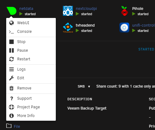

I have a strange issue atm. I am not able to update my docker containers.

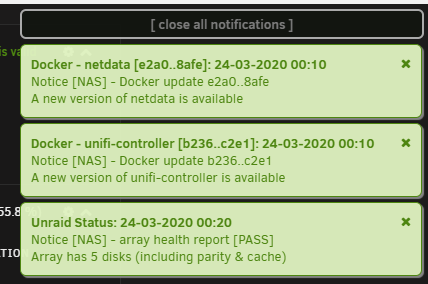

The system is reporting Updates for various containers and they show up with the blue text which indicates that an update is ready for this particular container but the button is missing in the context menu. See attached files.

If the Update option is present in the context menu when in the Docker tab, then this is a known issue and fixed for next release of the OS

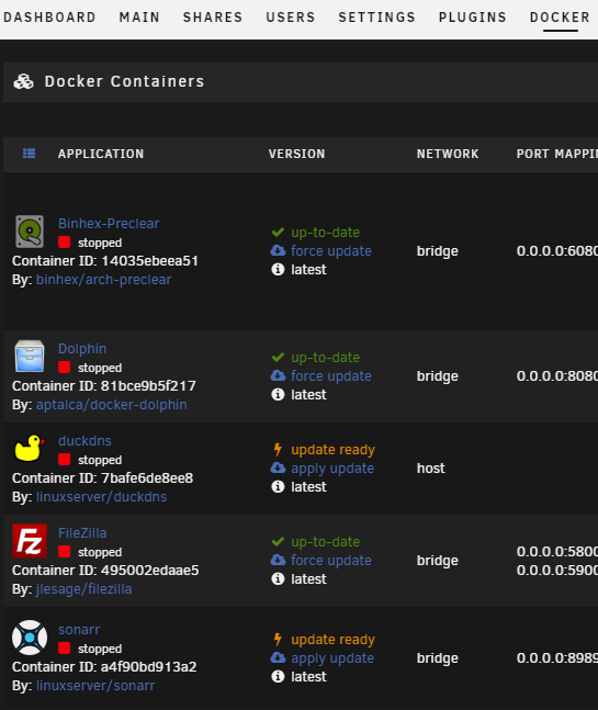

@germericanish your image is from the dashboard, have you tried going to the docker tab and using the force update option? For example from my dashboard filezilla has no update available and in fact from the docker tab it says up to date BUT there is a force update link. see below, I have no idea if this will help but it might...
Thanks for this advice. It is indeed working. I am just not used to doing it like this lol.

I have the same behaviour on my side. For some reason under the dashboard tab, the update option for dockers seems to be "inverted". Dockers with updates do not show the update option, while ones without updates do show the option. I currently update by going to the docker tab.
