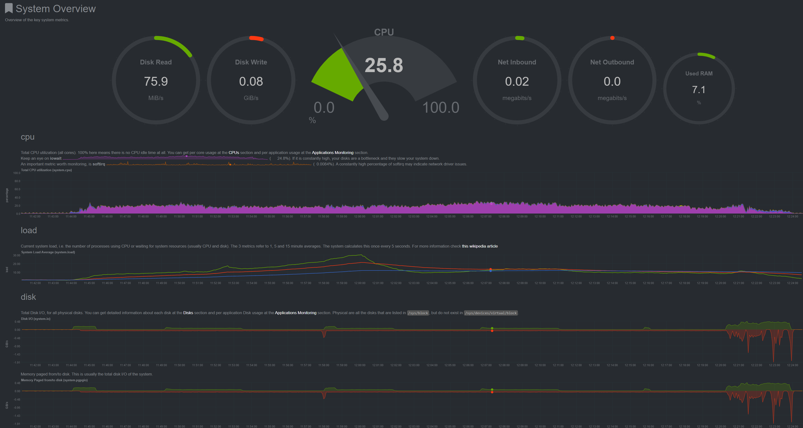

CowboyRedBeard Posted April 1, 2020 Author Share Posted April 1, 2020 Yeah, but I had Crucial drives in and had the same issue. So the brand of drive isn't what the problem is here. Quote Link to comment

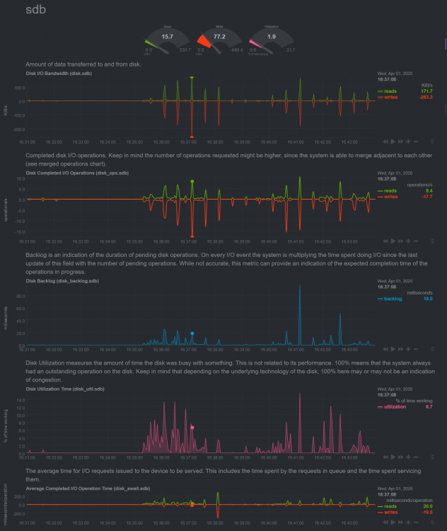

Vr2Io Posted April 1, 2020 Share Posted April 1, 2020 (edited) 1 hour ago, CowboyRedBeard said: and the part you might have missed is that this issue hasn't always happened 1 hour ago, CowboyRedBeard said: but mostly had these operations happening late at night. MX500 should a good SSD. With Samsung QVO, does problem happen more frequently ? .... I really haven't much idea if it relate time factor. I focus on "Backlog", those long response time already show overload in disk. Sometimes ago, I replace Crucial BX200 with a 7 years age Crucial M4 for BT jobs, it perform quite good ( usually 16-35MB/s writing ) and much lot fast response time during load. Both SSD support TRIM ( but not support secure erase ), TRIM on BX200 won't help, read and write speed can't resume normal. Edited April 1, 2020 by Benson Quote Link to comment

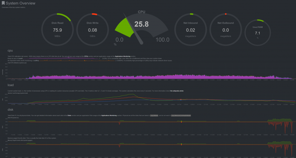

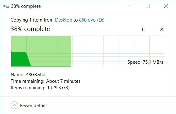

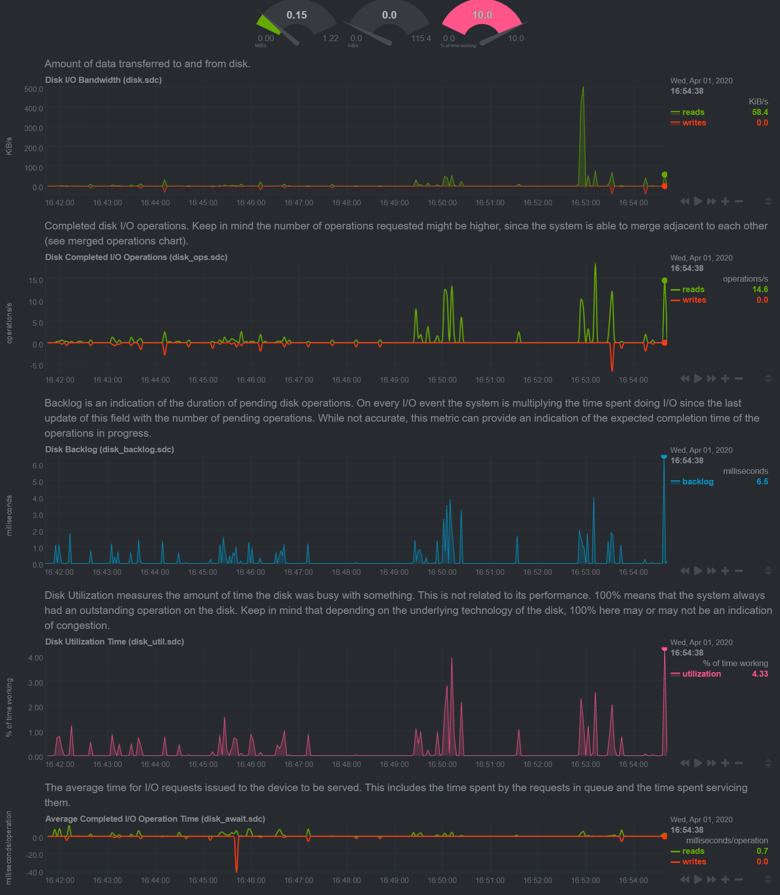

CowboyRedBeard Posted April 1, 2020 Author Share Posted April 1, 2020 I appreciate the help, but it isn't the drives. Check out the netdata graphs I posted at the start of this thread. As you can see from my first posts, I'm not getting anything near these speeds: https://ssd.userbenchmark.com/SpeedTest/667965/Samsung-SSD-860-QVO-1TB https://www.pcworld.com/article/3322947/samsung-860-qvo-ssd-review.html The issue was the same with the Crucial drives. So... I'm pretty sure it's not the drives themselves. I'm not on the same level as most of you guys with this stuff, but given the discussion thus far it seems clear to me that this is something unique to unRAID and cache. Quote Link to comment
Vr2Io Posted April 1, 2020 Share Posted April 1, 2020 (edited) 14 minutes ago, CowboyRedBeard said: I appreciate the help, but it isn't the drives. Check out the netdata graphs I posted at the start of this thread. As you can see from my first posts, I'm not getting anything near these speeds: https://ssd.userbenchmark.com/SpeedTest/667965/Samsung-SSD-860-QVO-1TB https://www.pcworld.com/article/3322947/samsung-860-qvo-ssd-review.html The issue was the same with the Crucial drives. So... I'm pretty sure it's not the drives themselves. I'm not on the same level as most of you guys with this stuff, but given the discussion thus far it seems clear to me that this is something unique to unRAID and cache. May be I am wrong, anyway 75MB/s could be max in worst case. ( BX200 even worst, 60MB/s ) https://www.pcworld.com/article/3322947/samsung-860-qvo-ssd-review.html And some figure seems quite match Edited April 1, 2020 by Benson Quote Link to comment

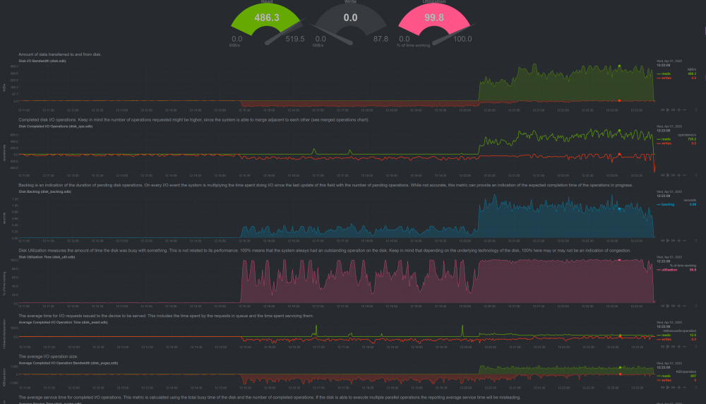

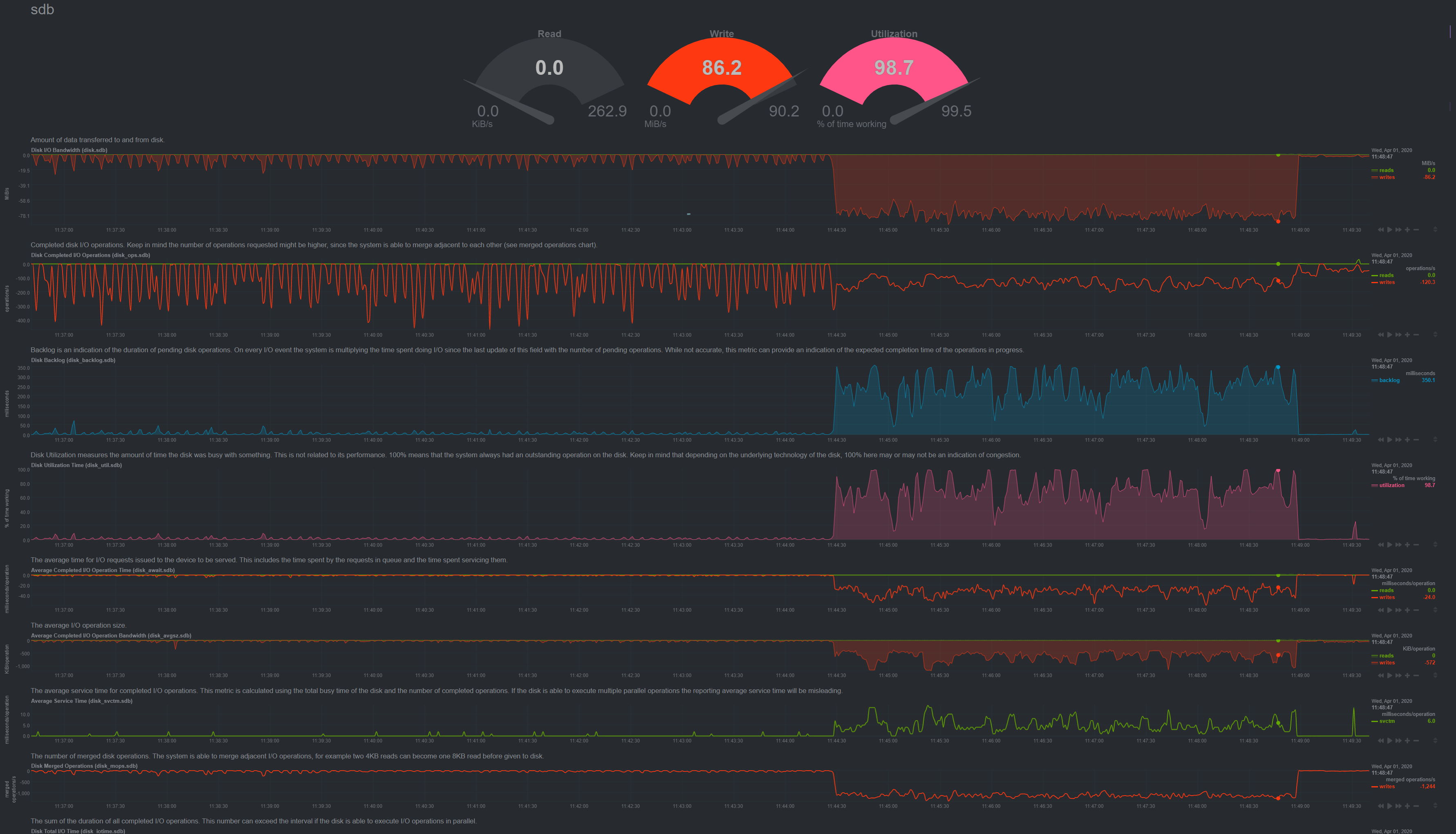

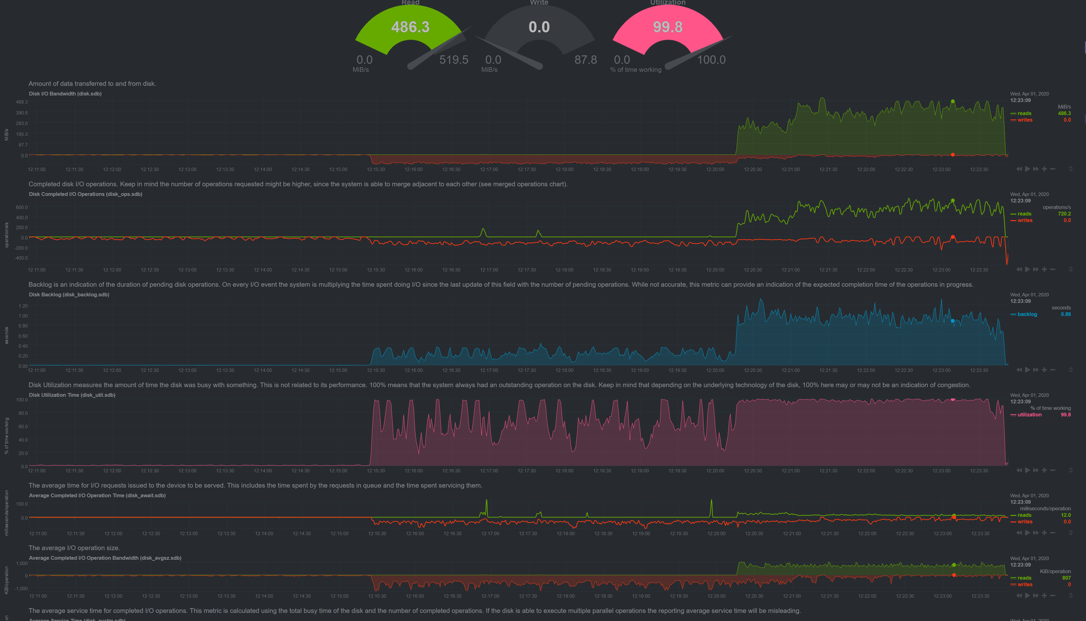

CowboyRedBeard Posted April 1, 2020 Author Share Posted April 1, 2020 For a test, here's me copying a file (83G) from the array to the cache drive (via MC in shell): And where this drive drops off utilization, you can scroll down to the other cache drive and watch it pick up where this one left off. Now this is writting at only 85MBs (+/-), it's pulling from a spinning disk... which should be able to feed it more than that. But there's your backlog you asked about. And as a test, I have a PCIE Intel Optane drive in the box that I copied this file to FROM cache: And this is the Optane, which typically seems to be able to take as fast as you can give: Hopefully this adds some light to the issue? Quote Link to comment

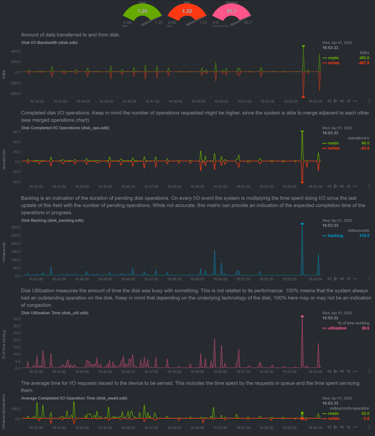

CowboyRedBeard Posted April 1, 2020 Author Share Posted April 1, 2020 And the IO during that cache write operation Quote Link to comment
CowboyRedBeard Posted April 1, 2020 Author Share Posted April 1, 2020 (edited) I mean, I'm not seeing the speeds as limited as others... although I'm unable to obtain the speeds I did in the past. The larger issue for me is that when I DO write to the cache as fast as it can... it crushes the server and other services basically stop. As seen in the first post. Edited April 1, 2020 by CowboyRedBeard Quote Link to comment

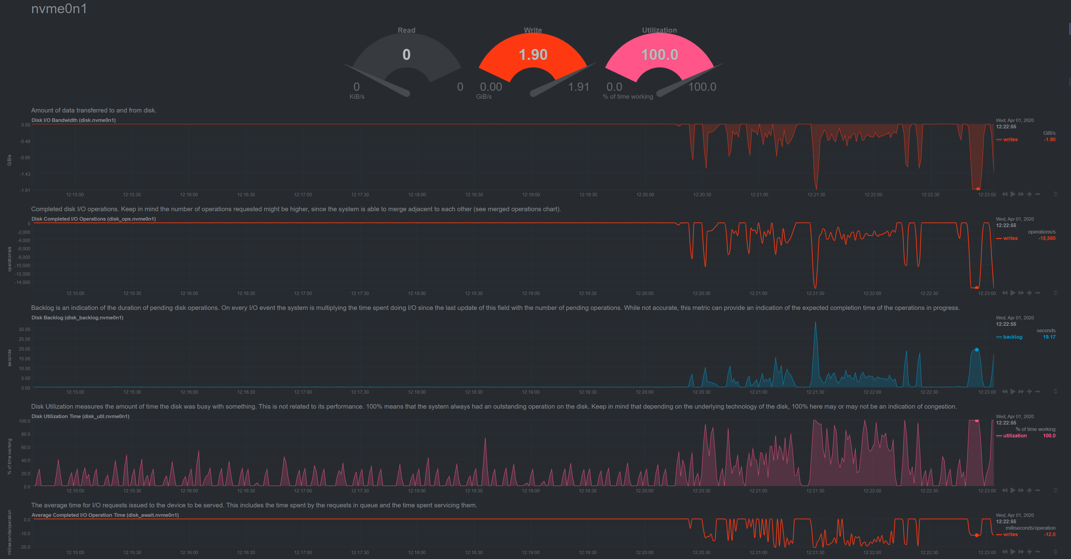

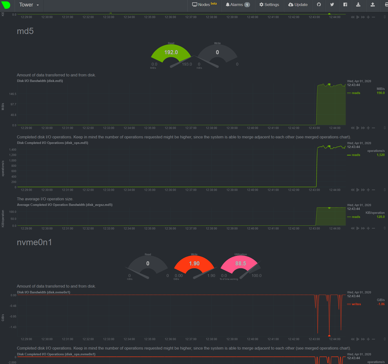

CowboyRedBeard Posted April 1, 2020 Author Share Posted April 1, 2020 Like here is that same file coming off the same disk on the array to the Optane drive at 190MBs vs the 85MBs the cache pool was able to manage Quote Link to comment
Vr2Io Posted April 1, 2020 Share Posted April 1, 2020 (edited) 1 hour ago, CowboyRedBeard said: I mean, I'm not seeing the speeds as limited as others... although I'm unable to obtain the speeds I did in the past. The larger issue for me is that when I DO write to the cache as fast as it can... it crushes the server and other services basically stop. As seen in the first post. Understand. During read / write test with Optane drive , does same problem happen ( server crushes and other services basically stop ) ? I agree there are big change from 6.7 to 6.8, so some user case may not happen at all. You mention you have try setting "Dirty ratio" and even worst, could you try LOWER it. My system also have 128GB memory, but I set "Dirty ratio" to a very high level to suit my need. Different behavior in different Unraid ver. I also report a case which about "direct I/O" and issue seems not since 6.9.0-beta1 . Edited April 1, 2020 by Benson Quote Link to comment

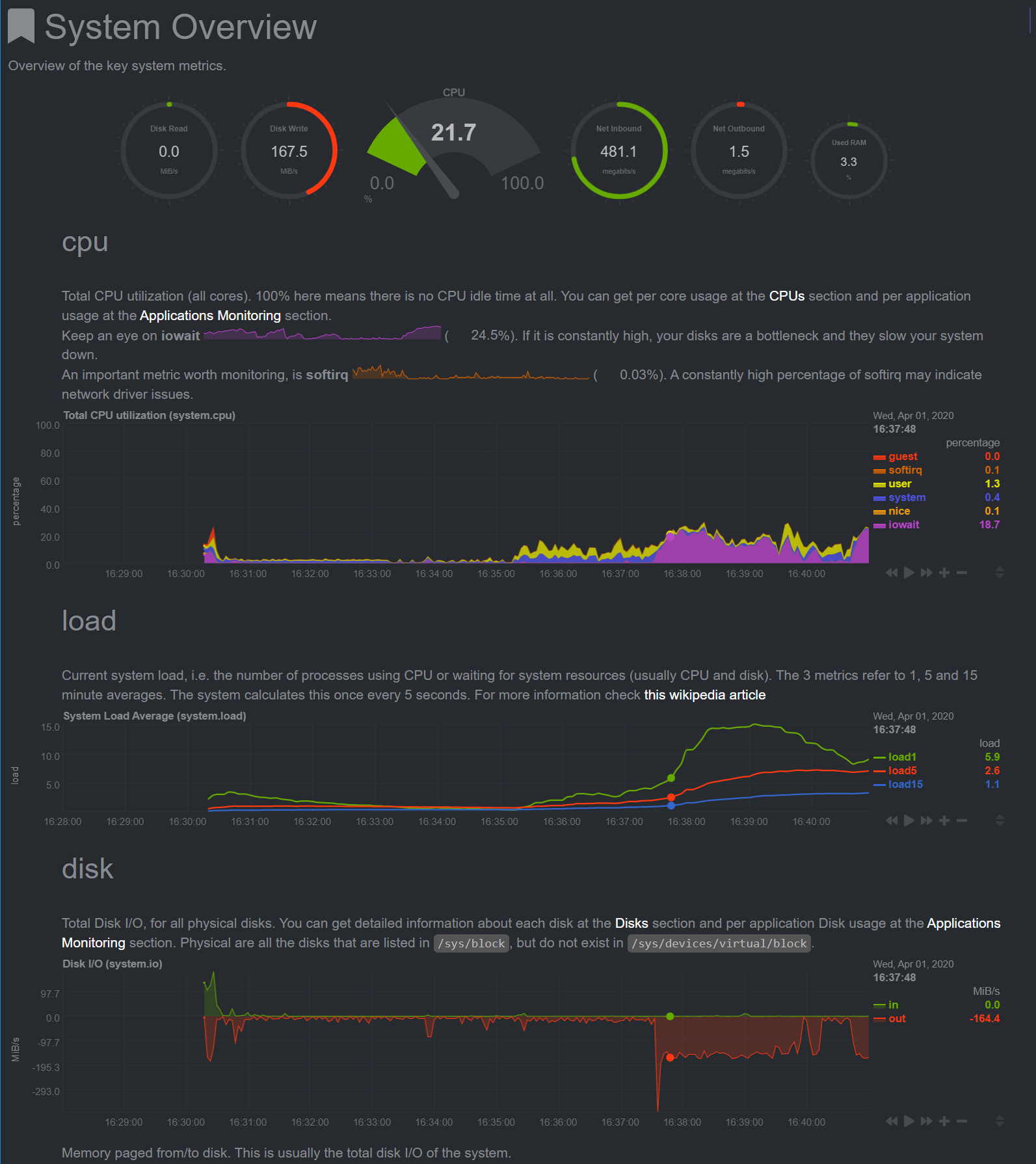

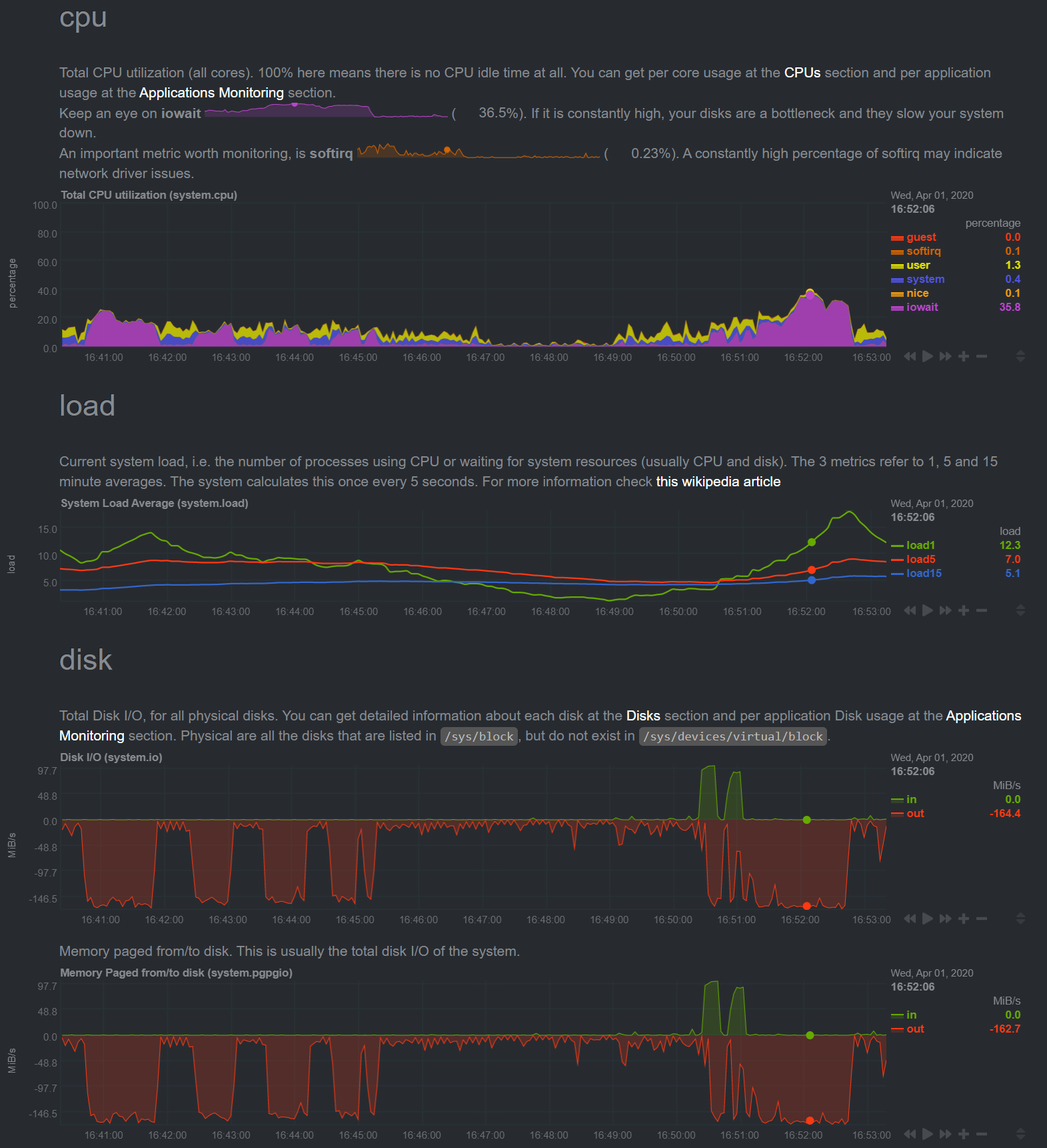

CowboyRedBeard Posted April 1, 2020 Author Share Posted April 1, 2020 So this is my latest test, I shut the system down and installed a PCIE SATA controller card. Moved both cache drives over to it (from the MB SATA3) and here was an 8G file: More or less the same issue with IO wait, however the speed might be a little better... hard to say as this file was half the size of the previous tests Quote Link to comment
CowboyRedBeard Posted April 1, 2020 Author Share Posted April 1, 2020 More files: Cache Disk 1 Cache Disk 2 Quote Link to comment
