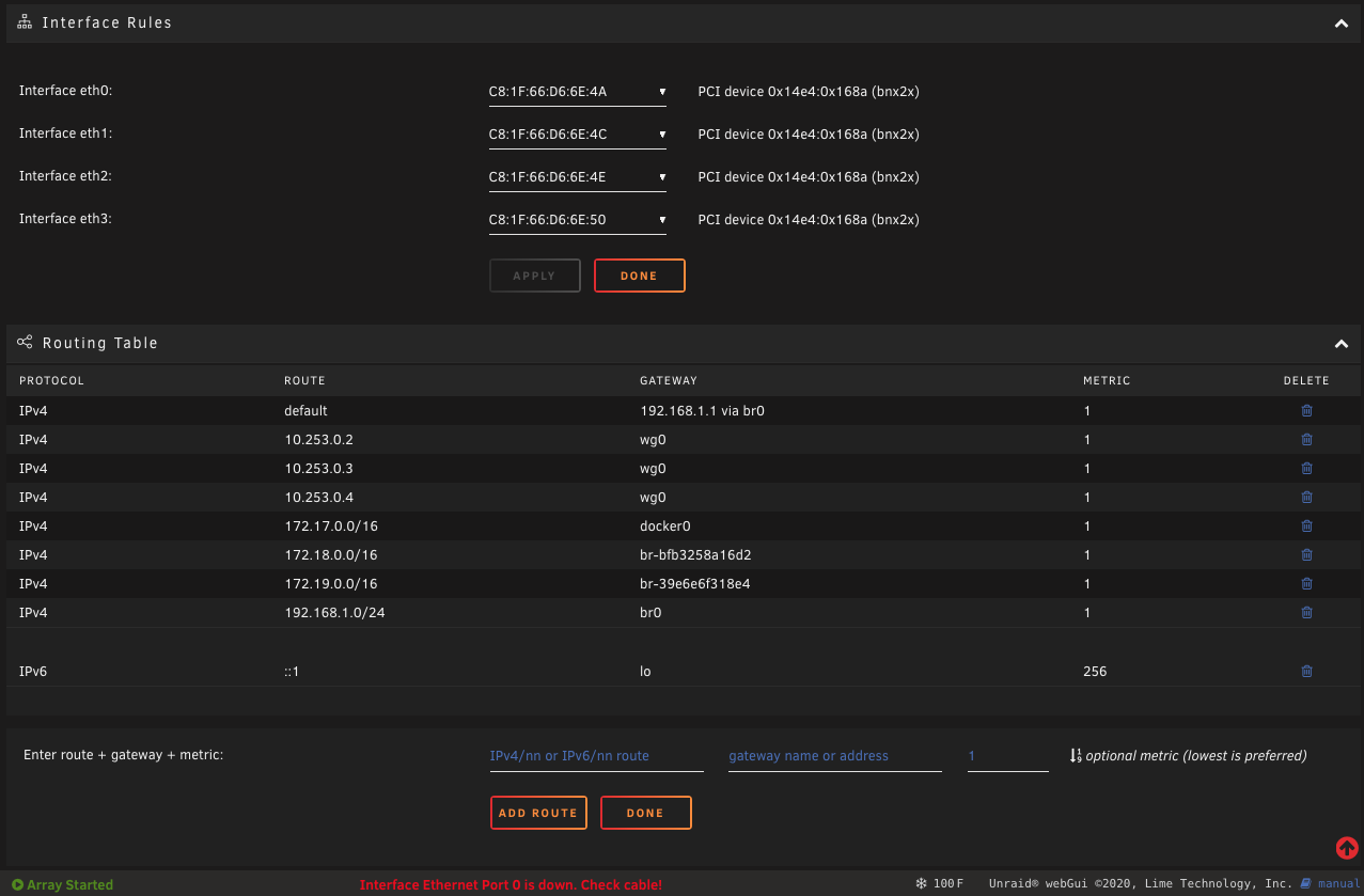

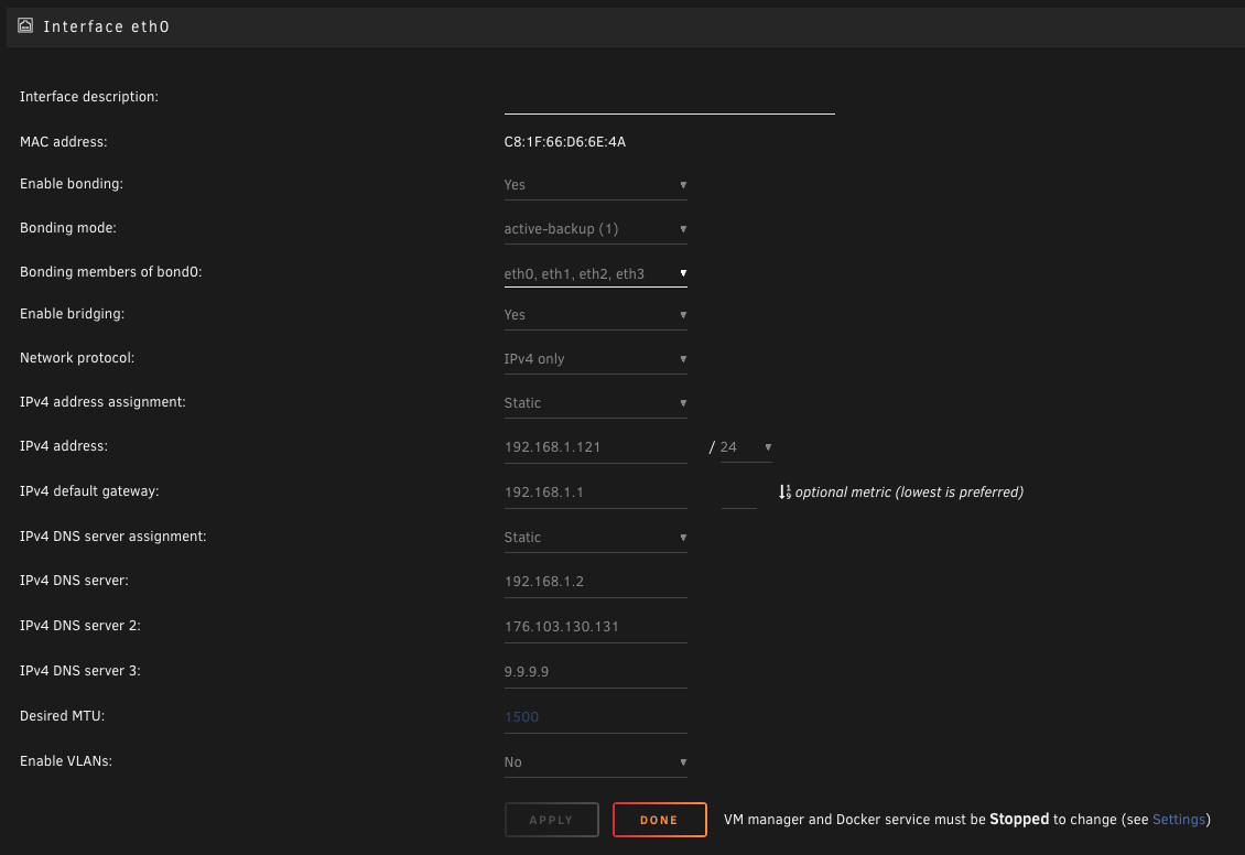

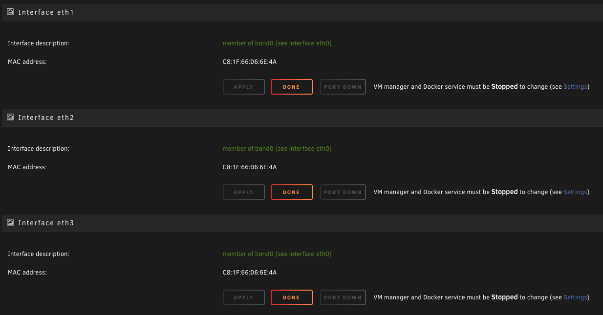

My issue is not high priority per se, as i'm not really having any operational issues here (although i couldn't get pfsense vm working and i suspect this is the cause). On my network settings, i'm getting an error in red at the bottom of the page:
Interface Ethernet Port 0 is down. Check cable!
This all started after i switched machines last year, i went from a desktop sff pc to a Dell R720 server, so essentially went from only have 1 nic to 4. On the new r720, it came with a SAS HBA assigned to ports 0,1, while regular 1gb ethernet is assigned to ports 2,3. I had gone into the idrac settings on the dell itself and tried to disable the sas controller, hoping unraid would just assign port 0 to the ethernet port i'm actually using. This didn't work though. Currently, i have ethernet plugged into port 2 with seemingly full functionality, minus the error.
I had gone into the network settings a while back (somewhere around 6.7.9 and 6.8) and tried troubleshooting with different settings and never had any luck resolving it. i've attached screen shots and logs, if anyone cares to take a look, would be much appreciated getting this sorted. Thanks in advance!

Lan is still working because eth2's link is up and you have a all NICs bonded.
BONDNICS[0]="eth0 eth1 eth2 eth3"
I know eth0 is down, that’s what I’m trying to resolve. They’re bonded now because it just happened to be one of the things I tried during troubleshooting. It didn’t resolve the eth0 problem, I just didn’t want to stop the array again to undo it since it didn’t seem to make a difference either way. But even if the nics aren’t bonded, lan still works, eth0 shows down.
if you’d like to see screenshots or logs of different configurations here, or even a specific one, I’d be happy to oblige. Thanks for the time

Set eth2 as eth0, you can do that by swapping them on "interface rules", reboot is need to take effect.
couldn't see the forest for the trees here. thanks for this!
