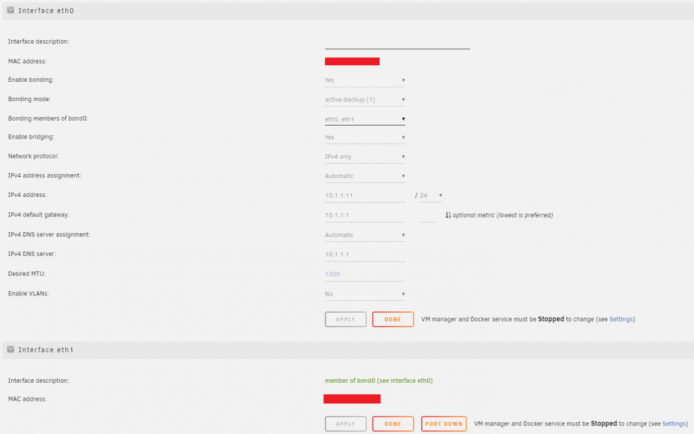

Here is the configuration of my 2 network interfaces:

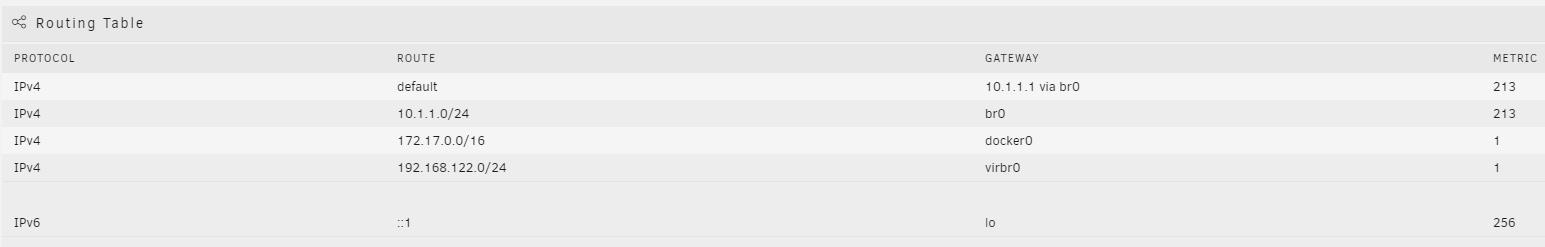

And here is pretty much what I think is the default routing table for Unraid, at least I didn't make any chance that I am aware of (and need help to understand what's really going on 172.17.0.0/16 and 192.168.122.0/24 since I don't use these networks and don't really want Unraid to use them):
