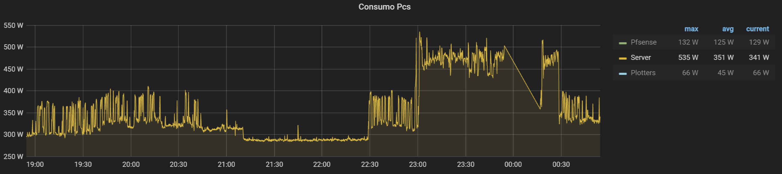

I recently updated my unraid server to AMD 3950x, but when Im Gaming on a windows VM after a few minutes the system suddendly turns off. To be able to start it again I need to disconnect it from the power and reconnect it, when I return to unraid the VMS are deactivated and of course because it turned off Badly a parity check starts, when I check the consumption does not exceed 600w (my psu is 850), could it be that my PSU is failing or overheating? It may be a configuration error.

Server shutting down is almost certainly a hardware issue, start by checking temps, if those are OK try a new PSU, also make sure to check this.
