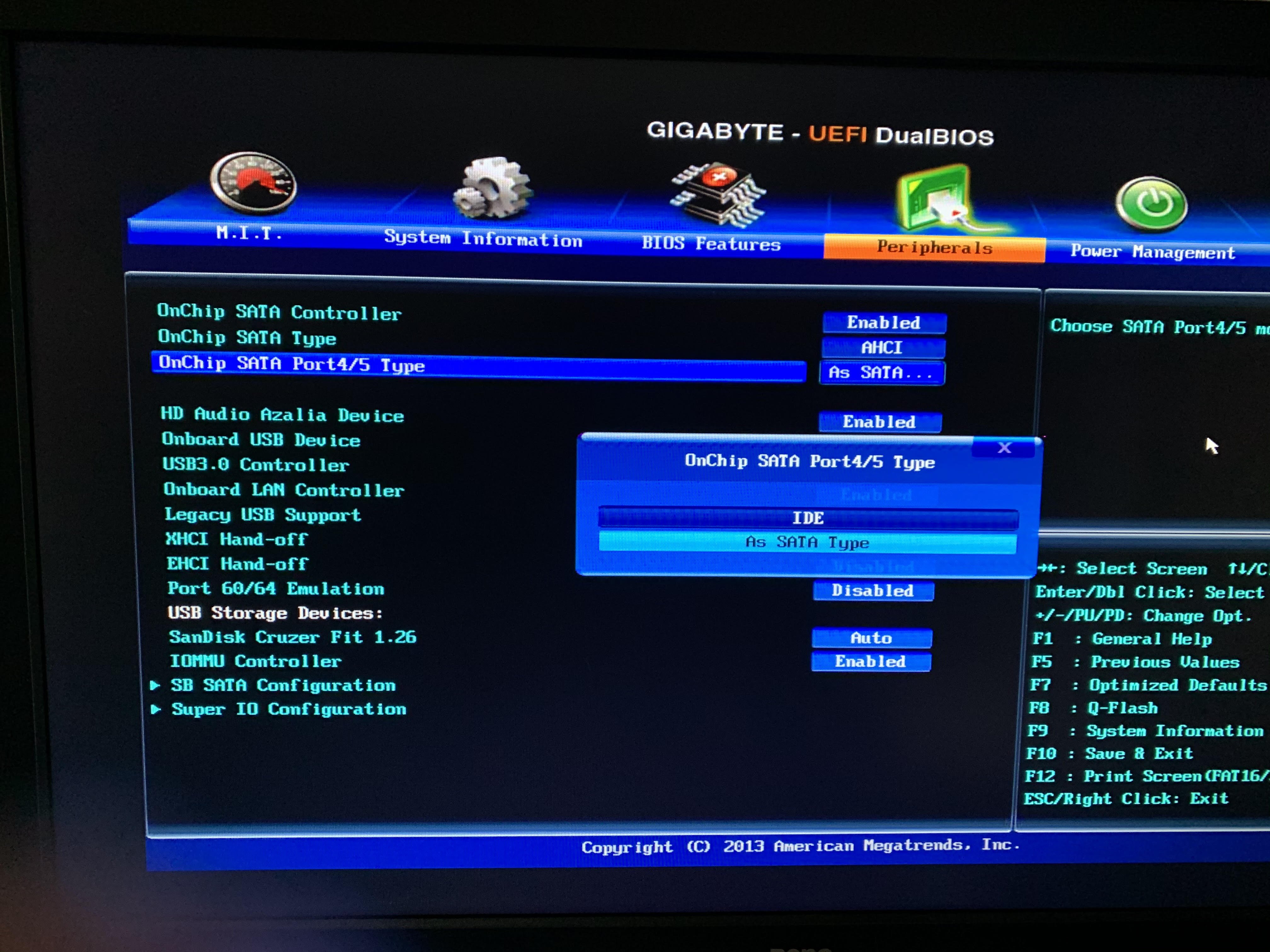

These chipsets have a separate BIOS setting for SATA ports 5/6, set them to AHCI, they have known issues in IDE mode.
It appears there is no "AHCI" Specific setting.  They were set to As Sata Type but I tried switching them back and forth anyways.
I also tried disabling IOMMU because I read elsewhere on the forums that people have seen issues arise because of that.
Any other ideas?
Set them as SATA as post diags after boot.

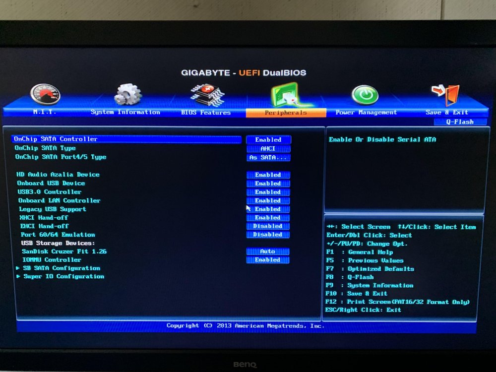

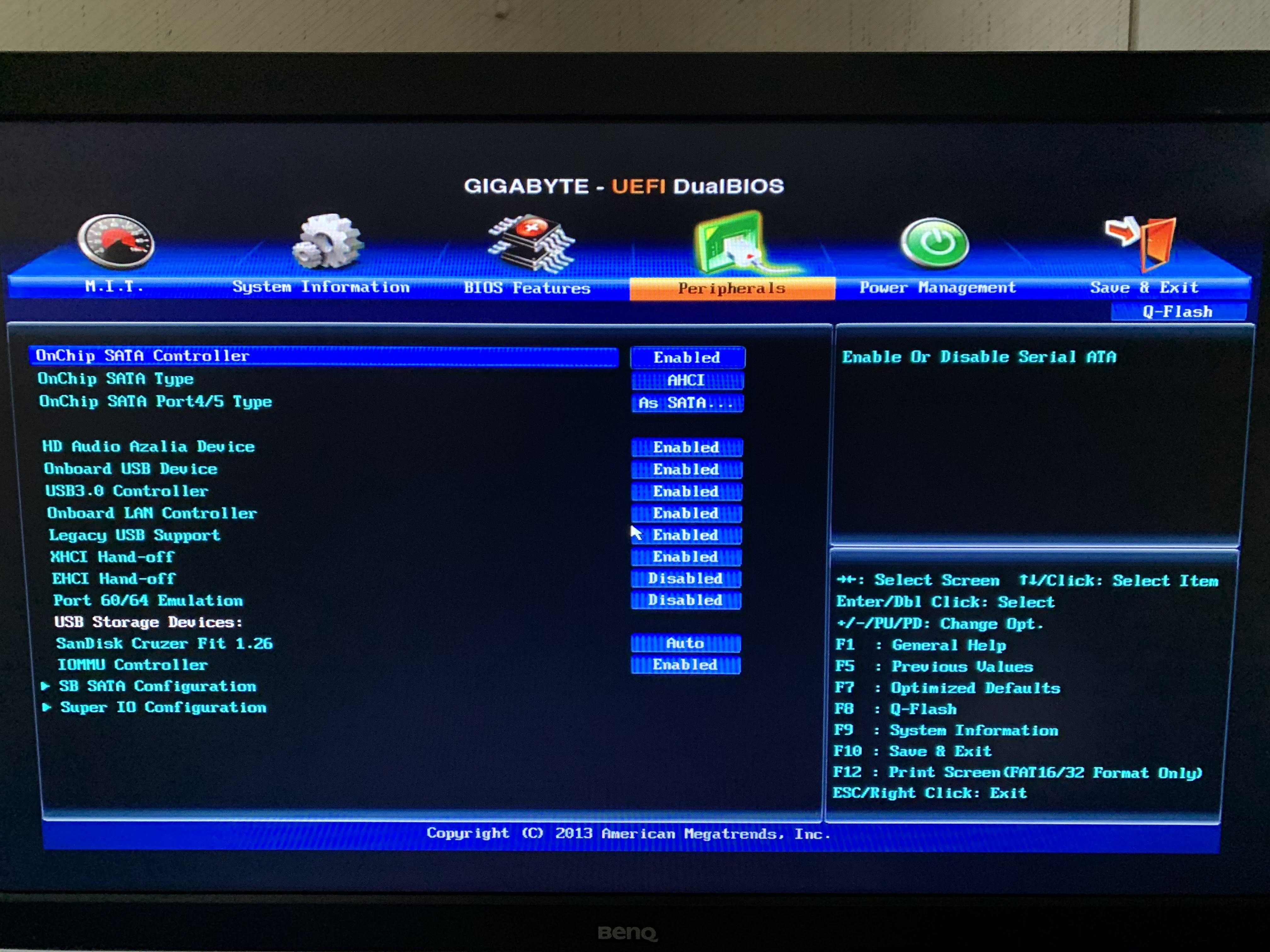

All 6 ports are set to AHCI, you appear to be having flash drive issues:

All 6 ports being set to AHCI is the desired setting, correct?
Yep

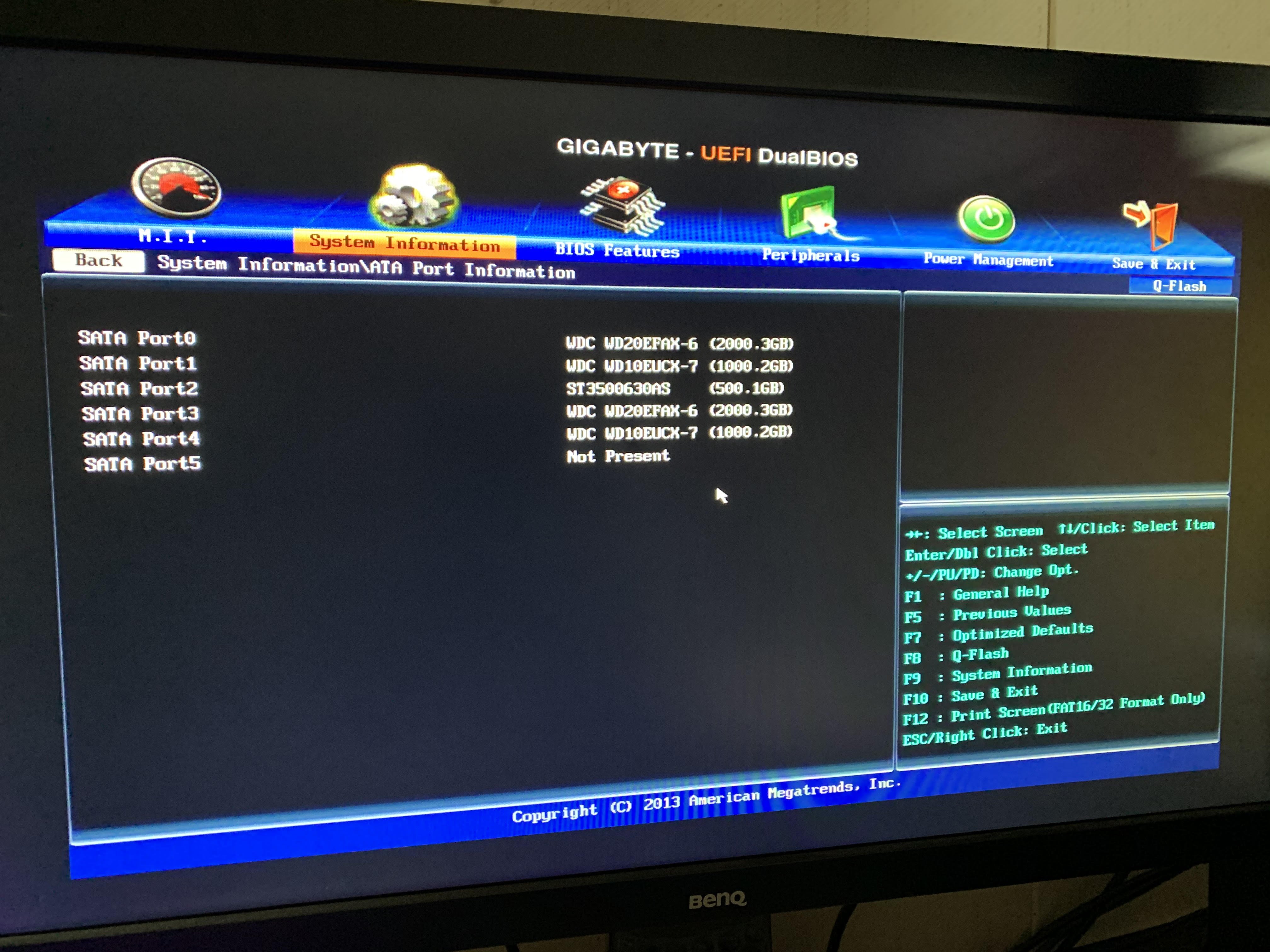

WOW - I believe this is actually a drive issue.
Started a "non-quick" format to be thorough and in the mean time started troubleshooting the drive issues:
Switched this drive into one of the slots of the working drives (SATA0 thru 3 don't remember which one) but the BIOS still didn't recognize it.
