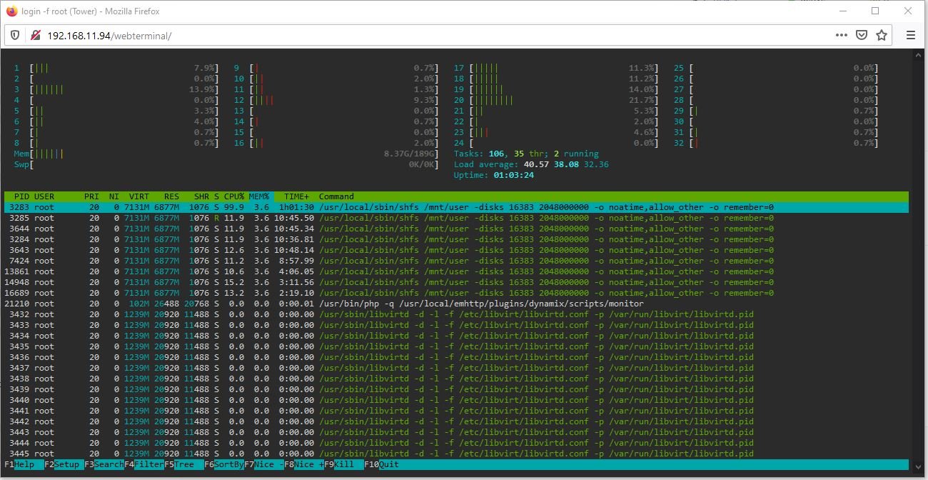

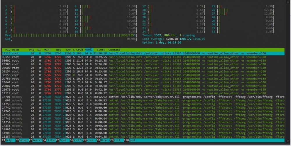

I was hoping to get some help with this memory issue I am having.  About every 24 hours I have to reboot my server because the memory keeps maxing out.  when I run htop in the terminal and sort by mem % i get the attached picture.  It has been going on for a few weeks.  I haven't changed anything hardware wise with the server and I don't recall any unraid updates triggering it.   It happened with 6.8.2 and 6.8.3.  Attached are a screenshot of the terminal window with htop running and my diagnostics.  Any help would be greatly appreciated.

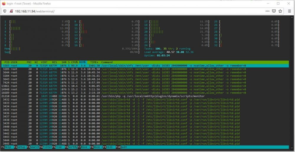

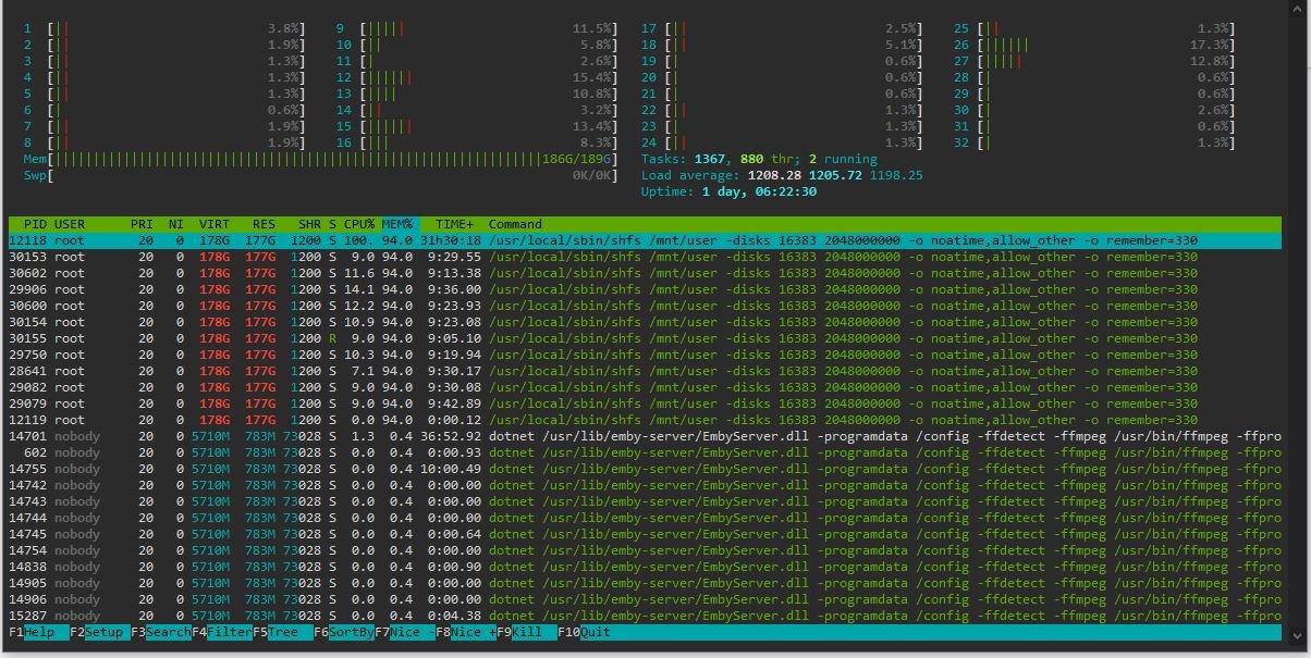

booted into safe mode with web GUI.  With the array not started everything ran as expected.  System idling with shfs not showing up.
As soon as I started they array, shfs processes started and ram utilization has been slowing going up.   I know shfs is a normal process and is expected to run.  However i have multiple instances of it and they all slowing eat up the ram.  Again this is in safe mode with web GUI enabled.
I am observing all this by opening a terminal window and running htop and sorting by mem%.   I assume this is an acceptable way to monitor this.

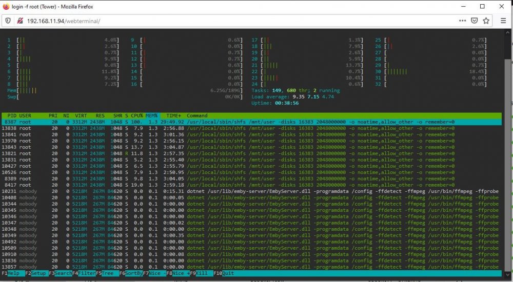

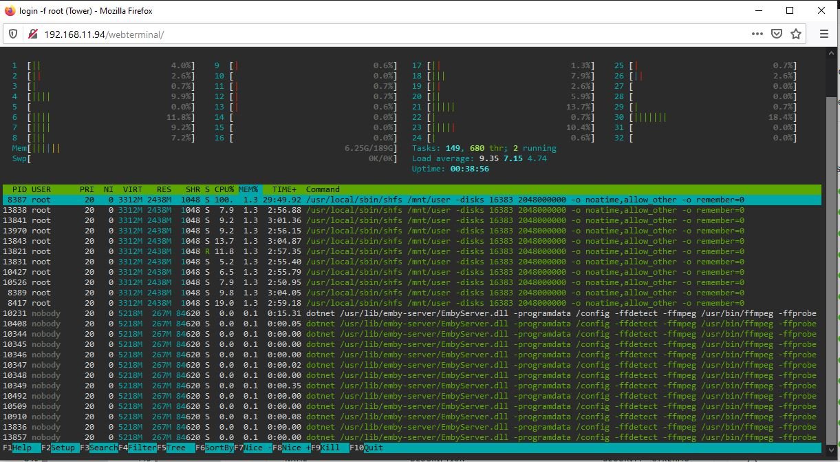

Ok, I restarted with docker set to off, no plugins installed, and no VMs.  After starting the array i saw 1.8G of memory being used.  30 minutes in it was at 4.59G.  40 mins it was at 6.06G.  And at 1 hour it was at 8.36G of memory used.  So a steady increase.  I beleive this would go on for about 24 hours until it maxes out the total 189G available.    I attached a screenshot of htop again sorted by mem% and also added another diagnostics file.  Any ideas or help is greatly appreciated and thank you for the help so far.
