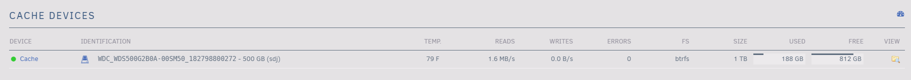

Yea something weird is going on with the cache drive I just noticed that unraid is report that the 500gb ssd is 1tb.
