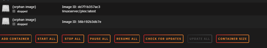

OK so I found a new piece of the puzzle (for me at least):
Just as you, both my docker image's data is still visible in the 'app data' folder.
When I switch to 'advanced view' in the Docker screen, my missing containers are now displayed at the bottom as "orphaned images".
Not sure what happened, as I had just installed them and not done any custom configuration. I had simply started them...
I guess the easiest will be to remove the orphans and reinstall... I'll remove the app data as well just in case...
I never saw any orphaned images, I always keep it in advanced view. I'll see if auto-updates disabled keeps them in longer. I imagine something is corrupt somewhere causing updates to fail... unless someone comes up with a better reason.

I have a similar problem with plex and one more docker.
how can i recover them and why did they disappear?
Edited by Harlequin42
In my case the plex docker was gone, but the appdata folder was still there with all the data.
i managed to reinstall the docker.
Here is what i did:
1. Backup appdata\plex and renamed it to be safe (i also have backups from the last 7 days of appdata folder)
2. Installed the same plex app again and made the settings of the app again
3. Stopped the docker
4. Deleted the new plex folder and renamed the old one to "plex" again
5. Started the docker again
Everthing was fine again.
I don't know which the other docker was which is also gone, but i think i deleted it already.
Maybe that's why there is no name on the docker id.
But the Question remains: What happened?
