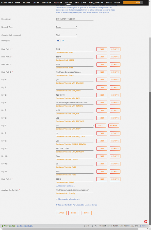

I use binhex's DeglugeVPN docker, because I don't use any torrent client without a VPN. This one has leak guard and a few other things that make it work well.
Works with Sonarr and Radarr, I have it set to copy the torrent upon completion to the actual shares, and leave the torrent in the download folder until a 2.0 ratio has been met. Once that ratio is met, it will delete the torrent and data from Deluge.
Edit: have you checked the logs to see if any errors or warnings stand out to you?
Here is a picture of my setup:
Edited by brimnac
Asked for log information, include image of my DelugeVPN setup. Make sure to use a better password :)
