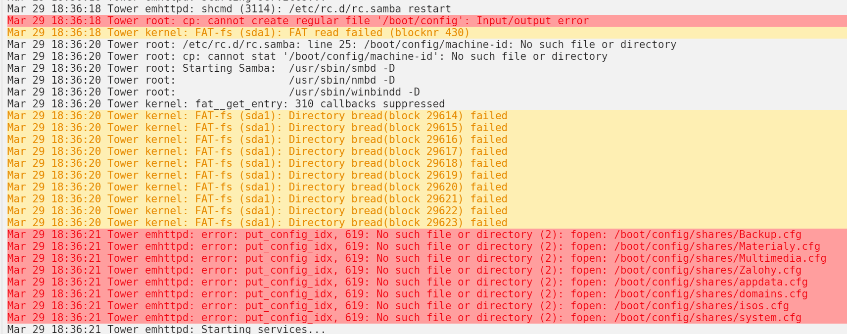

I am sorry I am a noob and have noob problems. The server crashed on me today during a file transfer to my VM.
I dont know what happened, but I am getting the following errors in the syslog now:
root: cp: cannot create regular file '/boot/config': Input/output error
As a result. My Ubuntu VM wont boot now, because it waits for some data from cache. the cache can find presumably the share config.
Any help would be appreciated.

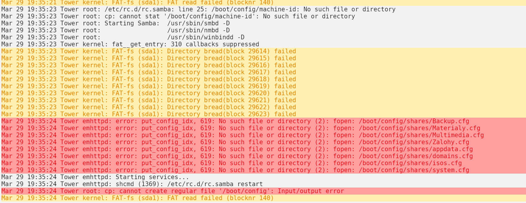

That rounds like a problem with the flash drive (as that is what is mounted at /boot).   It may have dropped offline, been corrupted,  or something like that.   We would need the system diagnostics zip file to be able to confirm that.

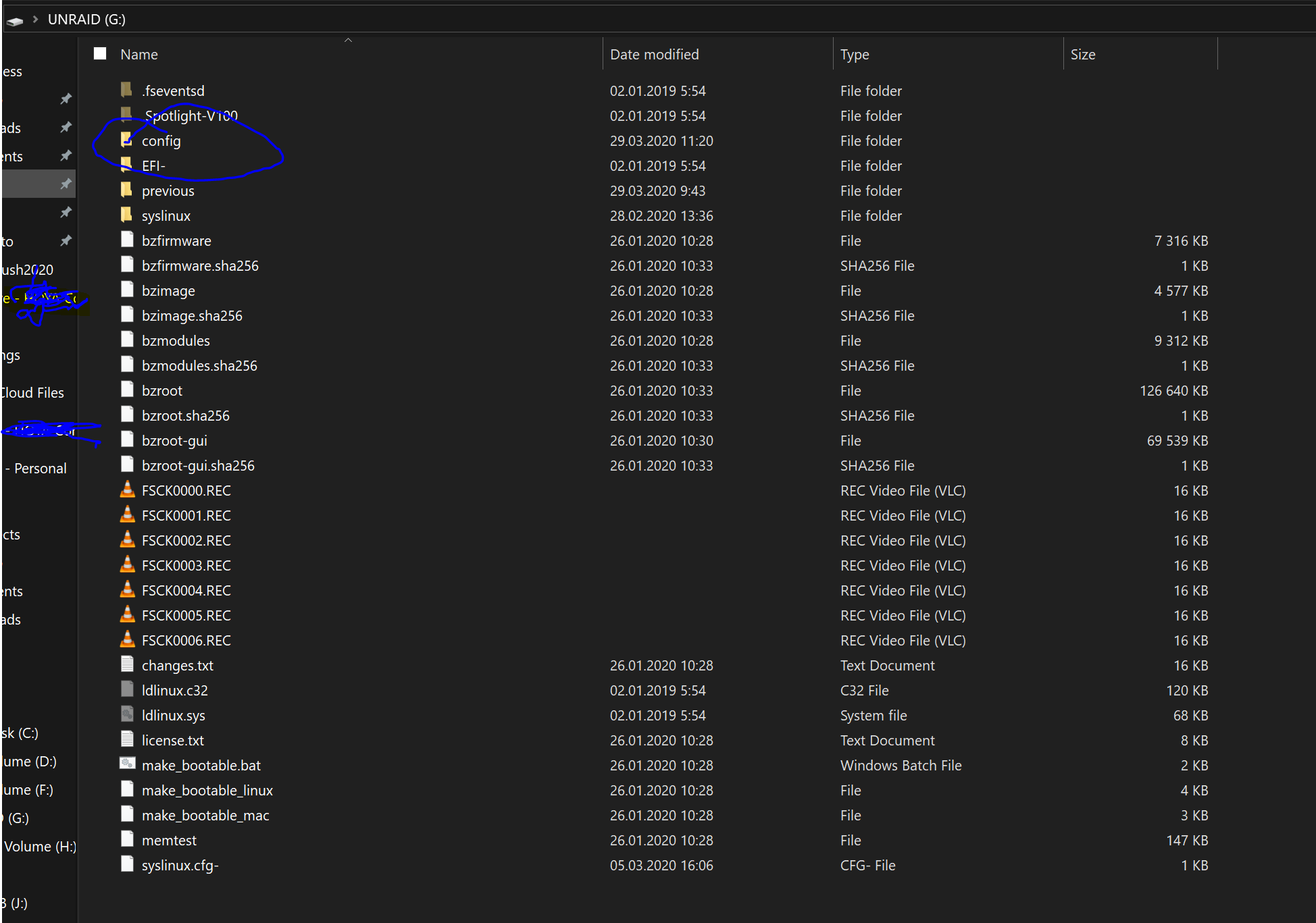

I would suggest putting the flash drive into a PC/Mac and running a check on its contents.
thank you. I tried that and all the files seem to be there.. before i mount the array I can even browse the specific location in the terminal and i see the files there. When i mount the array the boot folder turns to be empty

The presence of the FSCK type files indicates you have had corruption and the contents must be treated with an element of suspicion. The fact it seems to drop offline on starting the array would lend some credence to that.
If the /boot folder is ever empty then you can expect Unraid to start misbehaving as all configuration information is kept under /boot/config.   As was mentioned the system diagnostics zip file would be required to give any meaningful feedback on the cause.
I would suggest that you make a backup of the flash drive (in particular the config folder and all its contents) with the aim of recreating it as a fresh install and then copying the config folder back to get all current settings restored.

Those error messages show failures reading the flash drive.    Maybe the flash drive is starting to fail.

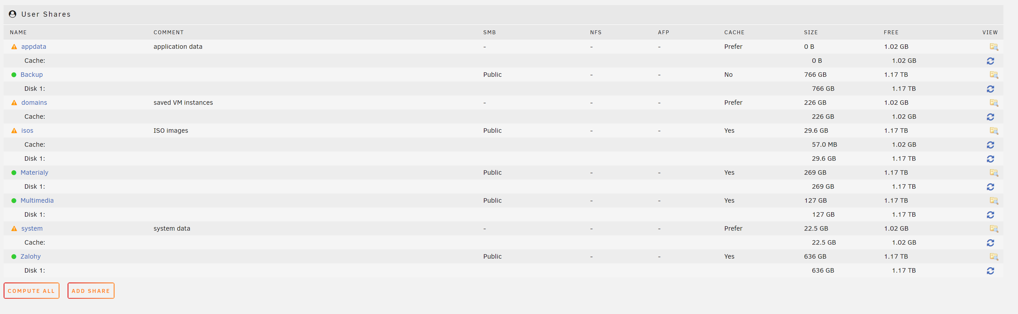

Doesn't look like you are having any flash problems in those. Are you booting from a USB2 port? Recommended.
Your cache is full and that is probably how you corrupted libvirt.
Your isos share has files on cache, but it is cache-no. Mover ignores cache-no and cache-only shares. Set it to cache-yes and run mover.
The only other things on cache are appdata, domains, and system, and those should be on cache. Not clear what could be filling it unless you just have things setup wrong and are writing a lot of stuff into appdata. But dockers are currently disabled, don't know if you had some running before or not.
Go to Shares - User Shares and Compute All. If it doesn't produce results after a few minutes, refresh the page. That will show how much of each disk each user share is using. Post a screenshot.

I think i have solved it. The cache for domains was set to prefer. That s the reason why it was full. I switched it to yes and then invoked the mover. The mover moved almost everything out and now I have a healthy 80GB cache utilization.
I have learned a lot. Many thanks. You can mark this as solved.
