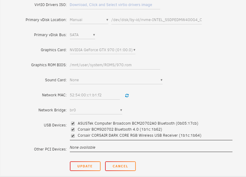

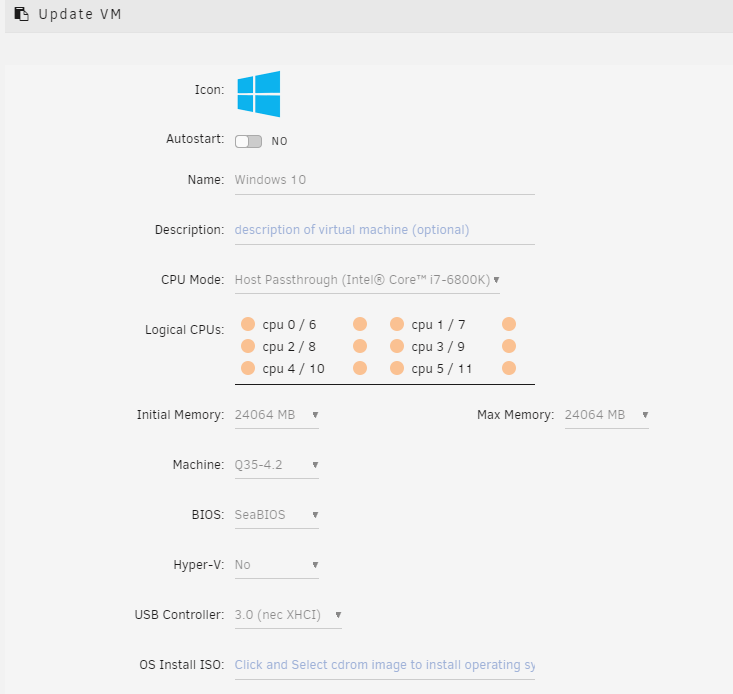

At the moment the vms is setup that way: (I wish I had an xml I could send you guys but I can't find any).
CPU Mode: Host Passthrough
Logical CPUS (all 12 threads)
Initial - Max Memory :  24 / 24 GB
Machine: Q35-4.2 ( As suggested in guides and threads I have been reading)
Bios: SeaBIOS (Again, as suggested in guides and threads)
Hyper-V: No
USB: Tried all of them and did not change anything but at the moment set to 3.0 (nec XHCI)
Os Install media: NONE
Primary vDisk Location:  /dev/disk/by-id/nvme-INTEL_SSDPEDMW400G4_CVCQ54360060400AGN
Primary vDisk Bus: *SATA as Virtio was not working
Graphics Card: NVIDIA GeForce GTX 970 (01:00.0)
Graphics Card ROM: Custom Rom where I edited the HASH from a tech republic ROM file that matched my GPU where I removed few lines as per community guide on youtube as there is nothing about that on yoru forum, or wiki (why?). that seems to work ok for

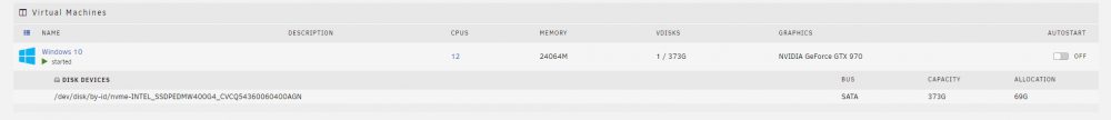

Before I finish this thread here are the result of a reboot:
Before reboot:
image.png.04d08abf303c1e2a03cadec3ff53c0af.pngimage.png.3c154bd14ac0279d3a1da4372c98bc43.png

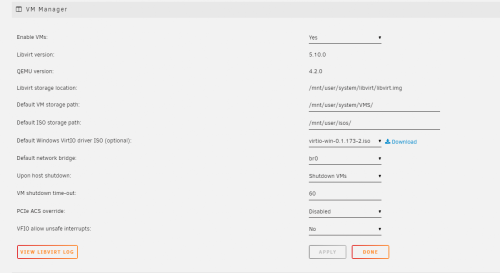

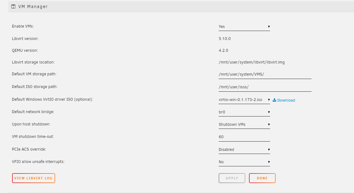

And the VM Manager setup

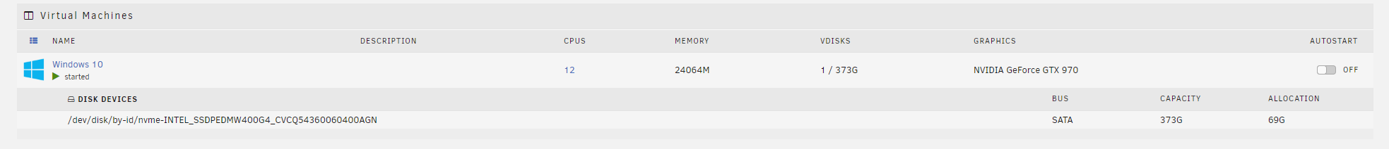

ok so now for the reboot of the host.
Oh well. It appears the vm is there now.... Which is not really what I was looking for as there is nothing I have done this time different than the last time I rebooted.
However even though the machine is set to auto start. It did not. Its one after another. I guess I am too dumb to use UNRAID.

libvirt.img was created at boot, which means it didn't exist before, not the that explains it but any reason you're not using the cache for that?
Try moving the system folder to cache (set to cache="prefer", disabled services and run the mover), then set libvirt path to /mnt/cache/system/libvirt.img instead of mnt/user/system.libvirt.img, then reboot and post new diags if it happens again.
