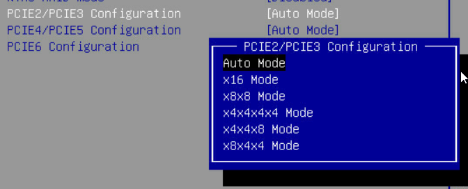

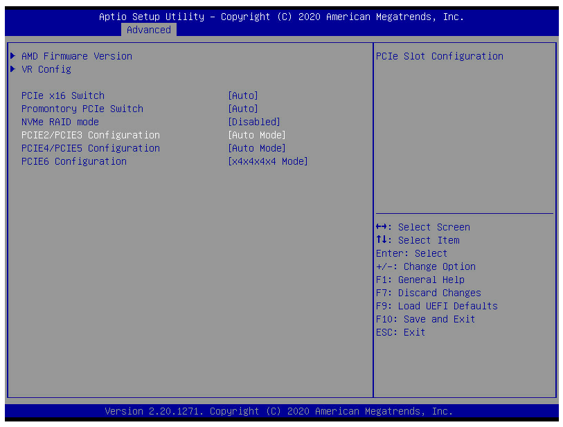

July 7, 20215 yr 17 hours ago, cybrnook said: Bifurcation was supported in BIOSes already prior to 1.37. What 1.37 gave me, and is what I asked for, is PER SLOT bifurcation options. Prior to 1.37 bifurcation worked in groupings. I flashed BIOS 1.37 and am seeing bifurcation still existing in groupings as seen in the below screenshot. The only PCIe slot with separate bifurcation settings is PCIE6. Is this what you are seeing as well?
July 7, 20215 yr 1 hour ago, ryanhaver said: I flashed BIOS 1.37 and am seeing bifurcation still existing in groupings as seen in the below screenshot. The only PCIe slot with separate bifurcation settings is PCIE6. Is this what you are seeing as well? They are grouped, yes, but options other than "Auto" let you specify what each slot is at. For example, for PCIE2/3 here I can set it to x8 x8 or x8 and then x4x4, or x4x4 and x8, for example. Before you could only choose x8x8 or x4x4x4x4 and that would be assigned to both slots. I hope that makes sense. Anyways, looks fine and good luck, enjoy the board.
