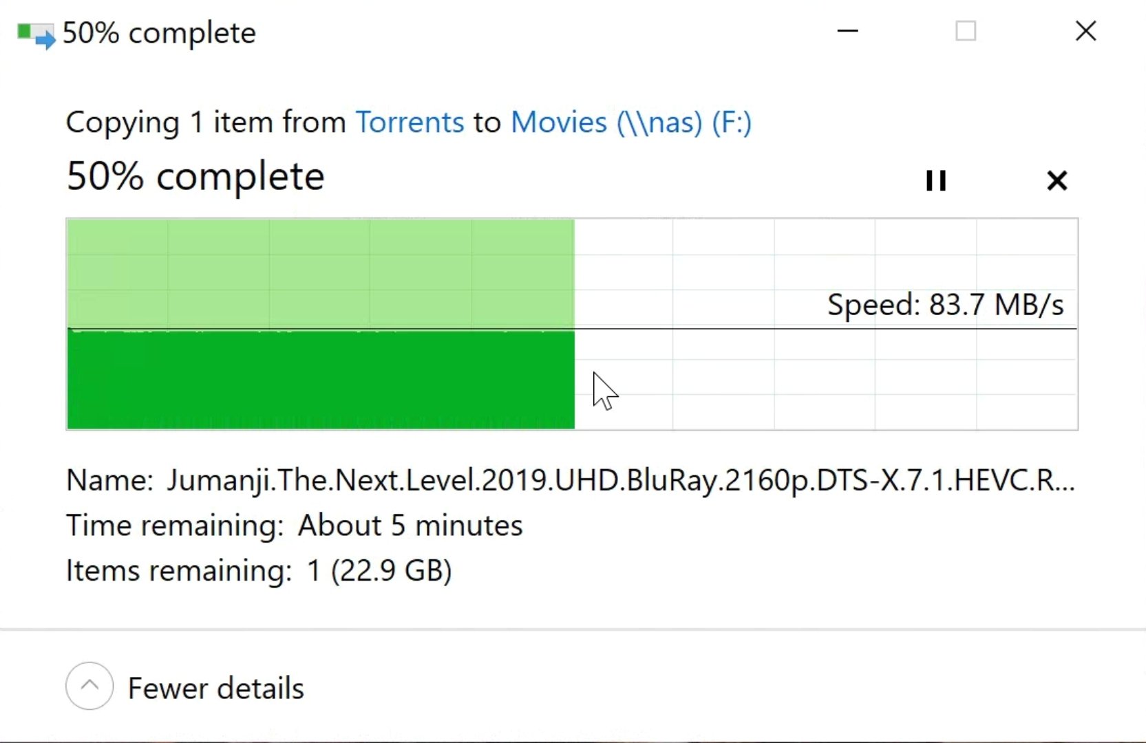

I transfer mostly video files, ranging from 1GB to 60GB and they always max out at 84MB/s now. The screenshot shows a transfer I just did. As you can see it hits 84MB/s right away and sits there, almost like there's a bottleneck somewhere. I am positive it's going to the cache drive. I monitored the cache drive temp in Unraid during the transfer and it stayed 88°F the whole time. I have the SSD trim app installed and set to run every 4 hours.
This suggests a network issue, since the first couple of GB are cached to RAM and should be transferred a max lan speed (assuming source is capable of that).
