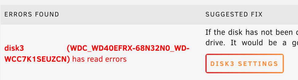

Hello Community,
I have read errors on one of my disks.  I have attached the SMART report (ran the short version) which shows no errors.  Also attached the system log that does show the disk error.
1.  Should I be concerned?
2.  Actions to take?
I am somewhat challenged to put my hands on my server, as I am in the USA and my server is in my house in China (yes, I am a Covid refugee).  I am accessing my server using Zero Tier.
Thanks for the advice.
SH
hal-9000-smart-20200330-2223.zip hal-9000-syslog-20200330-1435.zip
Next time please post the complete diagnostics, it includes the syslog, SMART reports as well as other useful info.
Iit's logged like an actual disk problem, but these can be intermittent, you should run an extend SMART test.
No extended test logged, only a short test.
It passed so disk is OK for now, keep monitoring.

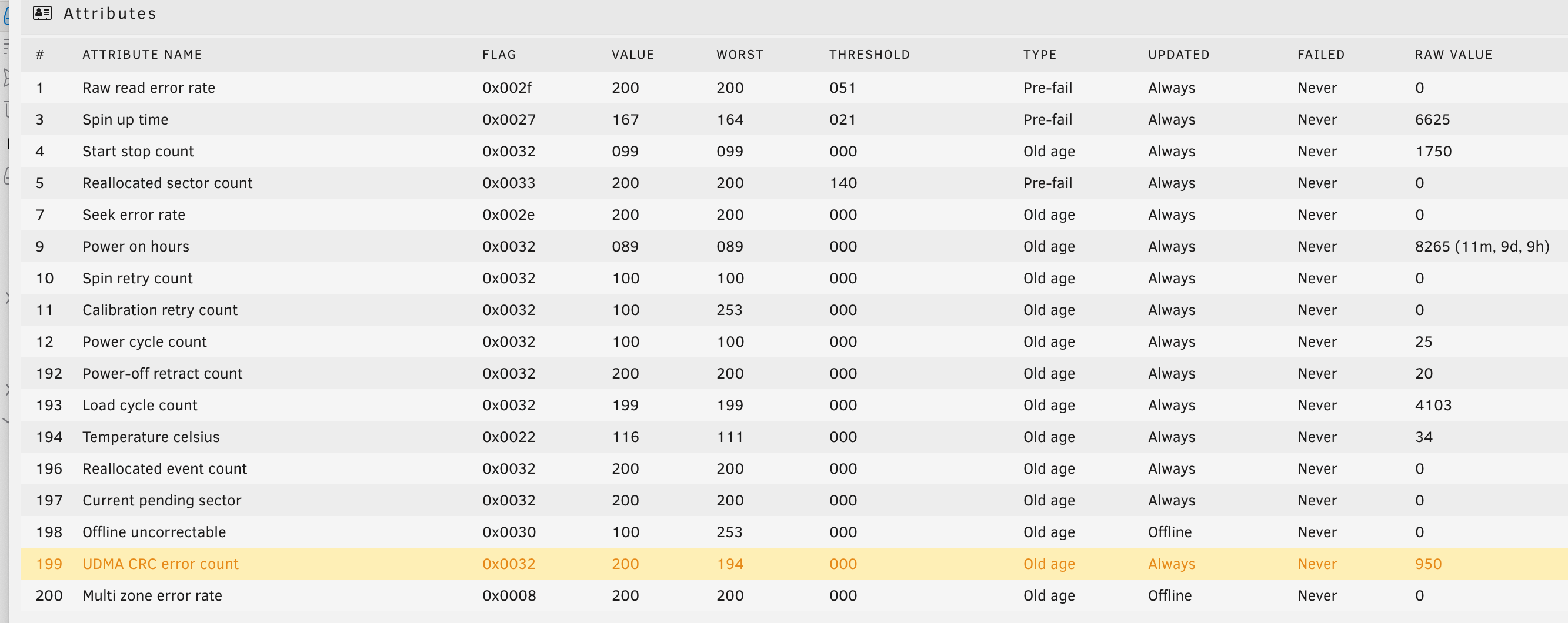

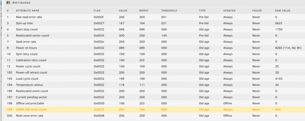

I have a disk with UDMA CRC error count warning.  Have run a SMART test which passed.  Should I be concerned or just monitor?
Thanks in advance.
SH.
hal-9000-smart-20200608-1145.zip

The CRC errors are connection issues and typically relate to power/SATA cabling.    The never reset so you just want them to stop increasing  (or increasing very slowly).
CRC errors are a connection problem, most times the SATA cable, but it can also be the controller, backplane, etc, start by replacing the SATA cable, and note that the attribute doesn't reset, so as long as it doesn't keep increasing the problem is solved.
