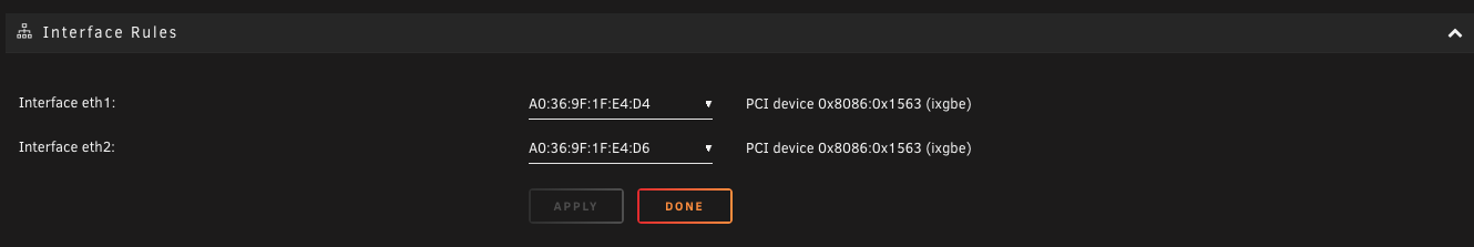

This is all I have under Interface Rules in Network Settings when the Array is Offline. No option to switch what Unraid uses as eth0.

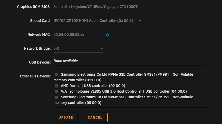

if the device 0x8086... A0:36:... is your main NIC for unraid then that is correct. your eth allocation is a bit jumbled up but its fine. if you assigned your NIC correctly you should see it in your list of devices under "other PCI devices" when you edit your VM. for example like this NVME PCI SSD and USB controllerimage.png.3351f2dc8179f28382647f53e1287904.png
If you don't see the Network PCI device then you must assign it, i recommend you do it with virt manager for your own sanity.
Unraid will automatically give over control of that PCI device when you turn on the virtual machine
