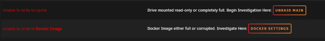

Slowly this has been getting worse, and it seems like I may have to scrub my cache pool. Can anybody help me with the follow errors. I can seem to do anything in relation to my dockers and they are not responding?

Mar 30 14:07:23 eMu-Unraid root: Fix Common Problems: Error: Unable to write to cache
Mar 30 14:07:23 eMu-Unraid root: Fix Common Problems: Error: Unable to write to Docker Image

Please post the diagnostics: Tools -> Diagnostics
I ran a scrub on the pool and it seems to be stable, but when I try to delete a certain folder in appdata, it freaks out and gives these error. I have ordered a 1tb NVME drive for use with my cache to get the sata ssd's out of the system, but would be interested on if i can delete the folder before i migrate to the NVME
also I know disk 5 in the array is bad, waiting until the nvme is here to take out and rebuild the array :)
as asked diags attached emu-unraid-diagnostics-20200330-2123.zip
Edited by emuhack
Cache filesystem has issues, best bet is to backup all data, re-format the pool and restore the data.
Yeah I'm going to switch to a nvme this weekend, I have a backup of my appdata folder and will restore the dockers when I install the nvme. I appreciate the help and the time spend on looking at the diags.
