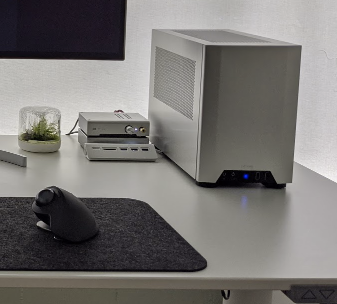

Adding an image of the itx machine to add some color to this thread lol.
image.png.657df0809f6ecb88d75065ff7bf648eb.png/
