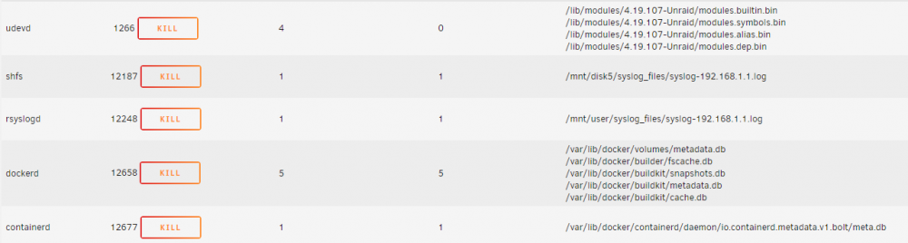

edit - added screenshot of openfiles plugin.

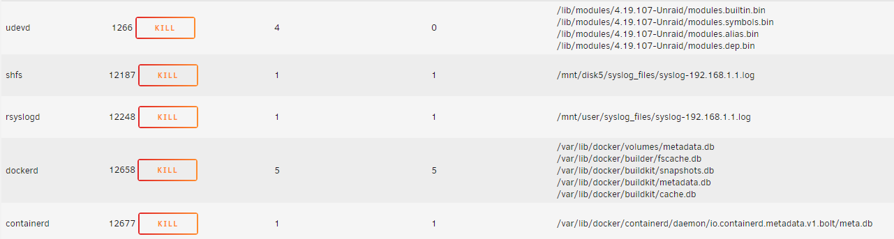

The open files shows it on disk5, that will prevent spin down.

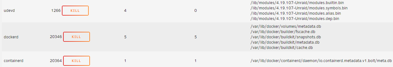

Update:
All dockers off.
Removed any syslog writing/syslog server
Attached are the only things open
Press "spin down" and within a minute all disks are spun up.
