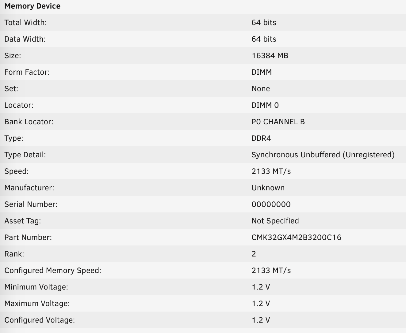

This is how the RAM is installed:

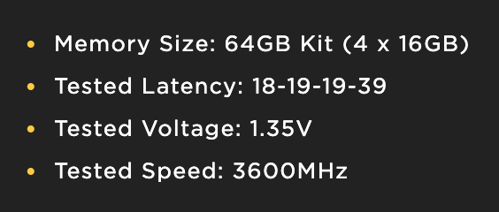

This is the from vendors website:
Do you have any suggestion as to how it should be set in BIOS?
