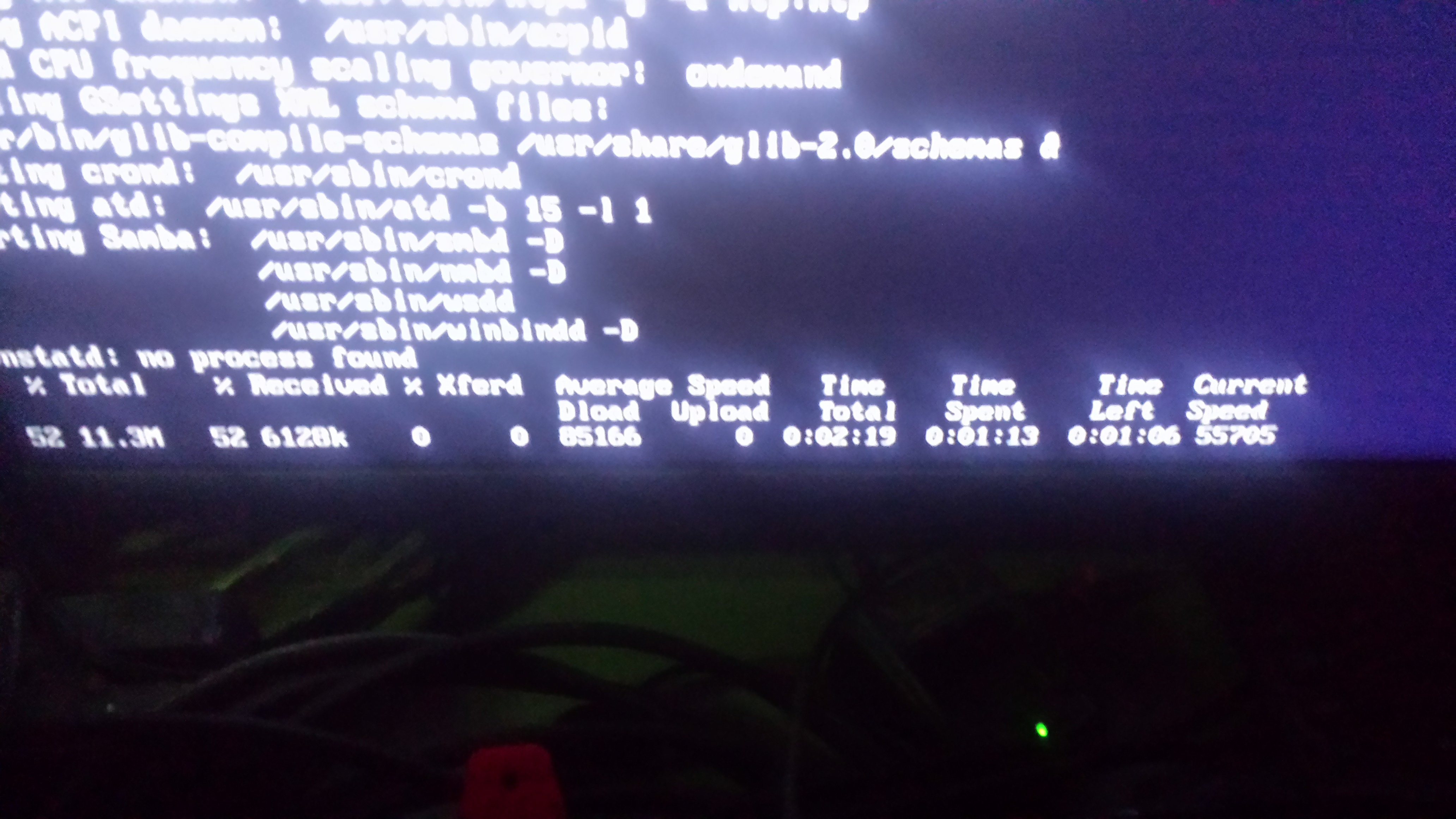

so I rebooted.. I cant get my pic off the phone I took of the console  of some errors and the like timer or hard drive checking it does

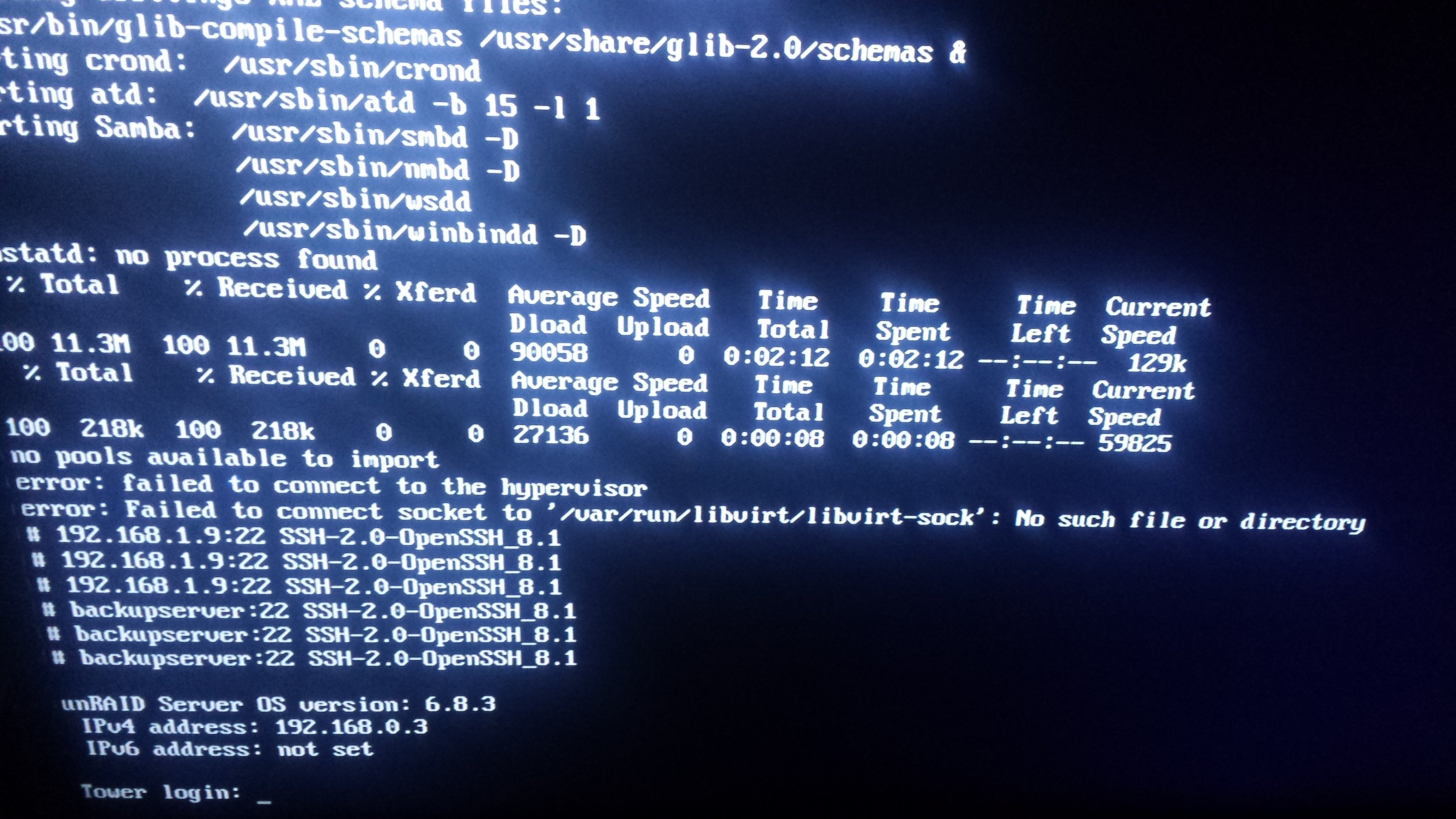

so couple questions.. I haven't rebooted my server with that 2tb Seagate out to see if that's the xfered is gone as im guessing that and my 4tb external  Is just a smart check on those drives as that's what I guess
but the 2 errors  below it
failed to connect to hypervision  what is that?
failed to connect to libvirt   folder  is that important file  location  what do I uninstall and install
