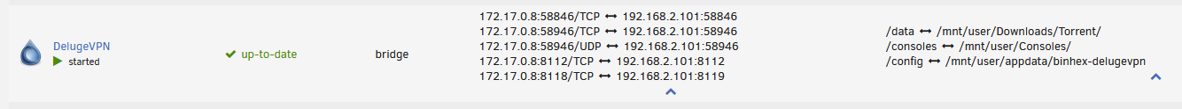

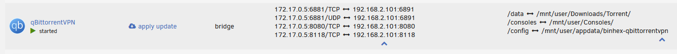

Hi.  I'm trying to run both a qBittorrentVPN and a DelugeVPN (both by binhex) docker simultaneously - that way I can use two different sets of configurations.  This doesn't seem to work though, either one or the other downloads, the other will invariably time out.  Shouldn't this be possible?  I've attempted to set my ports so that they don't conflict:
783432266_unRAID-Docker-qBittorrentVPN.thumb.png.36657dc65d25355337c69d2bec379f02.png1079490583_unRAID-Docker-DelugeVPN.thumb.png.e7ad67af090b6afb7203905d9d8d4388.png
192.168.2.1. is my server's local IP.  I've set up qBittorrent to use port 6881 internally, and Deluge using 58946.  Is there anything obvious I am missing?  Thanks for any ideas...

Did you ever figure this out? I am having the exact same problem right now. I cannot start both at same time though. If one is started, the other wont start.
Did you try different endpoint for each?
Sorry, new to unraid, only know what I can watch a video on and do. No clue what you mean by this. How do I do this and What are different endpoints so i know for the future. thanks
Talking of checking your plan with your VPN provider. Maybe your account with them doesn't allow for 2 simultaneous connections, maybe it does but both cannot be through the same location,...
When you setup Deuluge vpn you had to download ovpn files from your provider.  Each file is listed for a different country.  Take a look on youtube at Spaceinvader ones old DelugeVpn video.  It will give you a good idea about endpoints.
