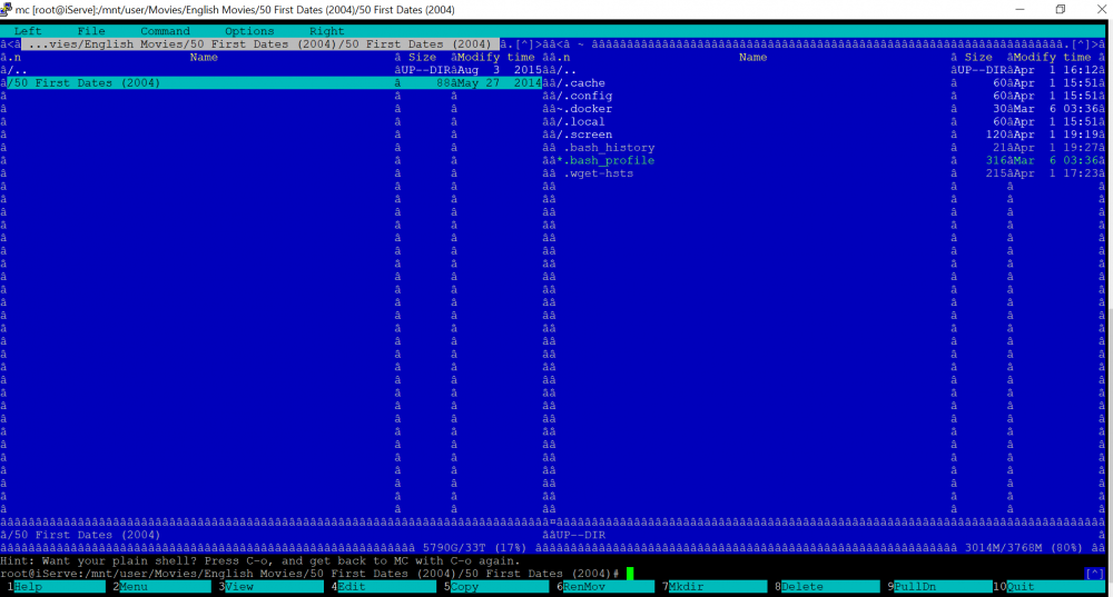

Sounds like you must have created a recursive link somehow. Post a screenshot of the folder contents from MC.
mc1.thumb.png.f7c7d507b04e39ee0cca1687a82d1fb6.pngscreenshot attached.

That looks like there really is a subfolder in that folder with the same name.

Are you sure you don't really have folders within folders within folders...
