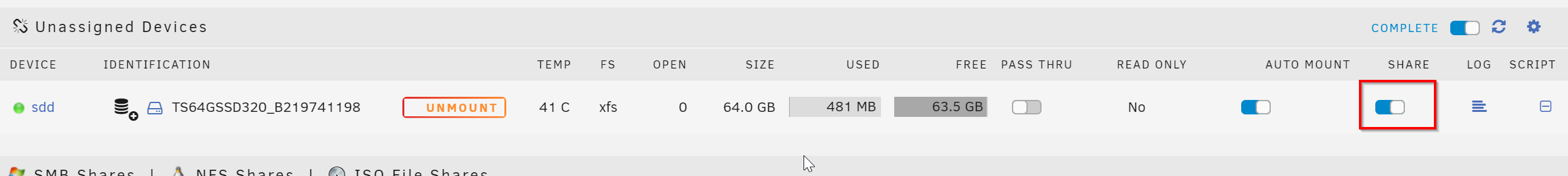

I have a problem with small files too. According to my investigations, this is unRAID SHFS problem and not SMB. You can try to create a share on an unassigned SSD drive and compare it to the normal share (even with cache only). In my case, it is much faster. It would be very interesting to hear about your experience. I like unRAID as a media server, but it is almost unusable as network storage for small file projects.
This is interesting and sounds plausible. How does one create a share on an unassigned drive like this? I don’t happen to have another SSD lying around to test this with, however.
It did seem like I got much better performance with a small test using only an SSD cache and a single hard drive with no parity back when I was still evaluating UnRAID. I get quite decent performance with something like Reslio Sync (Averaging over 150-200 MB/s) but trying to transfer files over SMB to Unraid is painful - either sub 1MB/s speeds or hang ups and pauses that require me to reboot something.
Enable share is easy. It is a temporary solution for me now. One problem you cannot use standard share UI and create different share folders with different parameters and only share the disk as a whole.

I installed the Unassigned Devices Plugin and tried enabling a share on an old 32GB 15K RPM SAS drive I have. Now the drive probably only does around 80MB/s writes or so, so I wasn't expecting much. Here are my quick and crude test results:
Doing a large file write (10GB over 10Gbit) to the SAS HDD was kind of sluggish and bursty, taking a few minutes, where it'd probably write to the SSD in a minute.
Writing a folder with 100MB of small files only took about 3 minutes, however... doing the same write directly to the NVMe SSD cache took about 4 times as long. This is fascinating that it's 4 times faster to a drive that only runs at a tenth of the speed. Something is clearly very not good in Unraid. Is this possibly because I'm using two parity disks? Would I expect a performance increase by using only one?
