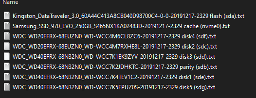

So my usb stick with the boot drive is dead. I have tried everything and it wont boot up. I don't have a Recent enough backup so I am not going to try that. Thats where a new drive comes in. I have flashed it and gotten the key file but I have read that you have to be careful selecting the correct Parity drive. I however am not sure witch one is my parity drive and was hoping for some help.
Luckily I have a recent enough Diagnostics report for an unrelated issue and was hoping that somewhere there I could tie the parity drive to the serial number but I don't see where that is. Could someone help me identify my parity drive through this Diagnostics report?
From SMART report: heimanas-diagnostics20191217-2329.zip ==> heimanas-diagnostics-20191217-2329 ==> smart
You can also find it here
heimanas-diagnostics-20191217-2329.zip ==> heimanas-diagnostics-20191217-2329 ==> system ==> vars.txt
