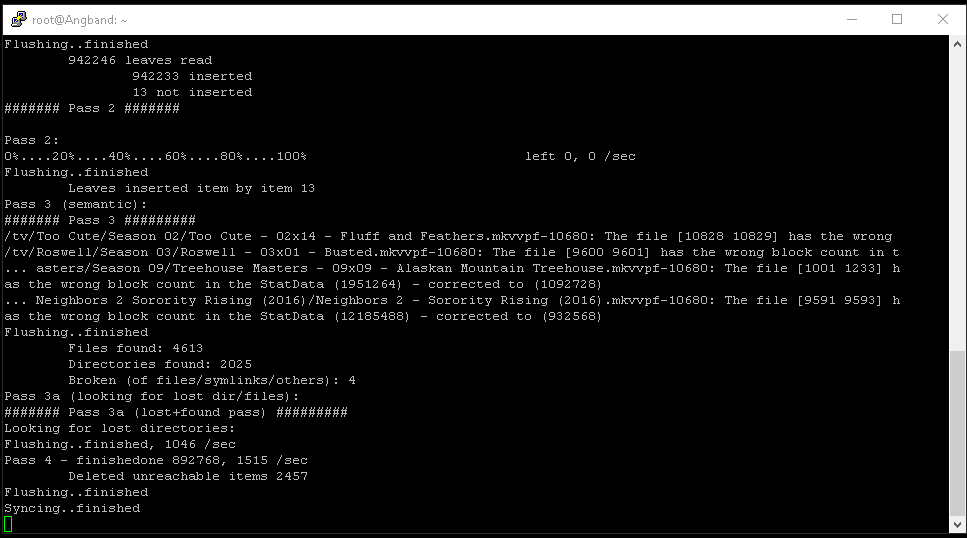

Took the array into Maintenance Mode three days ago, ran the resierfsck -- check and it told me to rebuild the tree.
So I did, it ran (took forever) and then it finished "Flushing finished....  Syncing finished... "
Since then it's been sitting at that window, not "Completed" (ie, no prompt, still running) and the dashboard shows the disk being written to (along with parity) for the last two days. Le ugh. Do I just let it limp along?

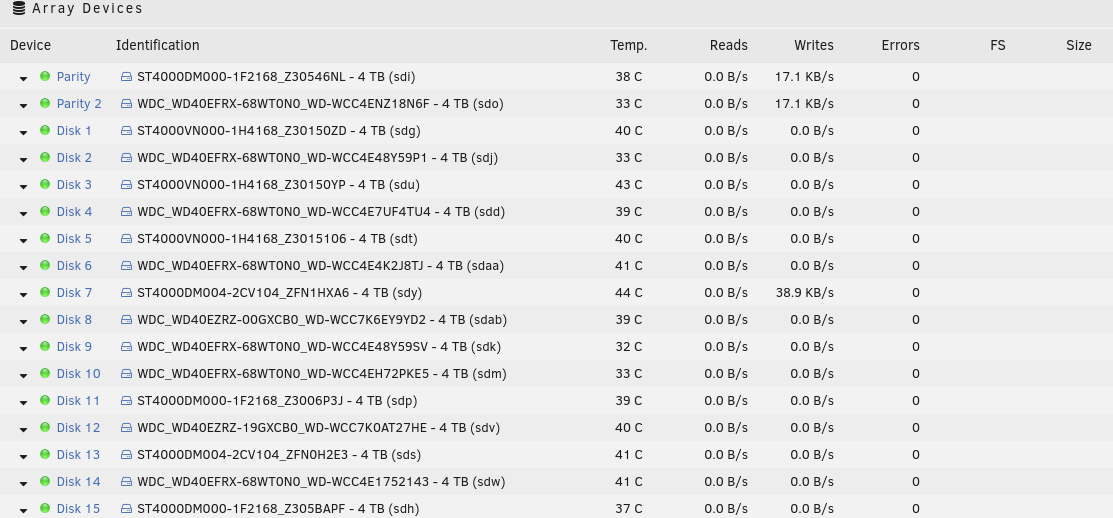

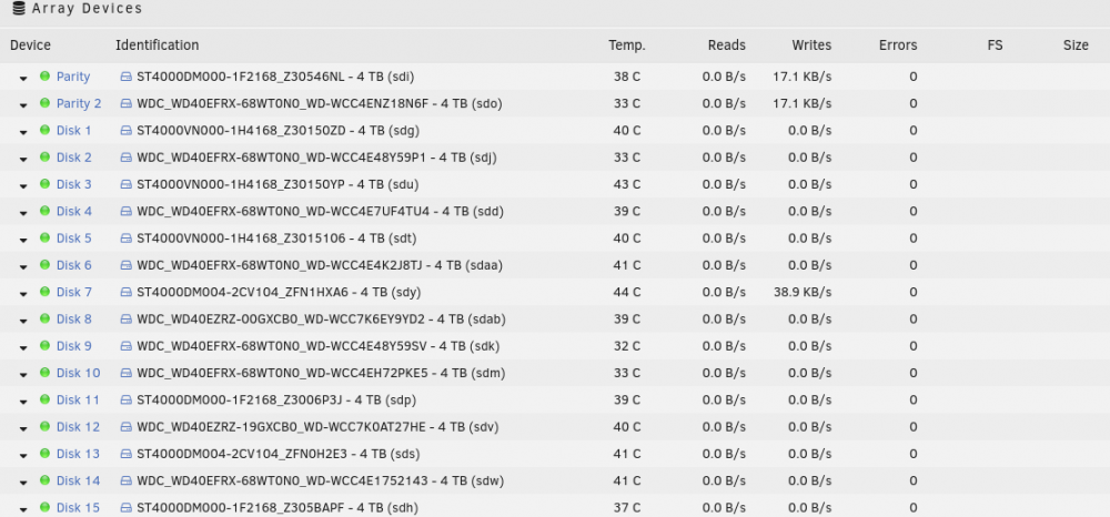

Just for completeness, a shot of the entire array being read... image.thumb.png.83752d8bce410c6bc18caf4f5871f9e1.png

Other disks being read is normal since you have turbo write enable.
Thanks for the reply.... it eventually DID finish, just took 3.5 days... I think I'll replace the disk? I dunno.... very weird.
For some reason there's no SMART report for disk7.
