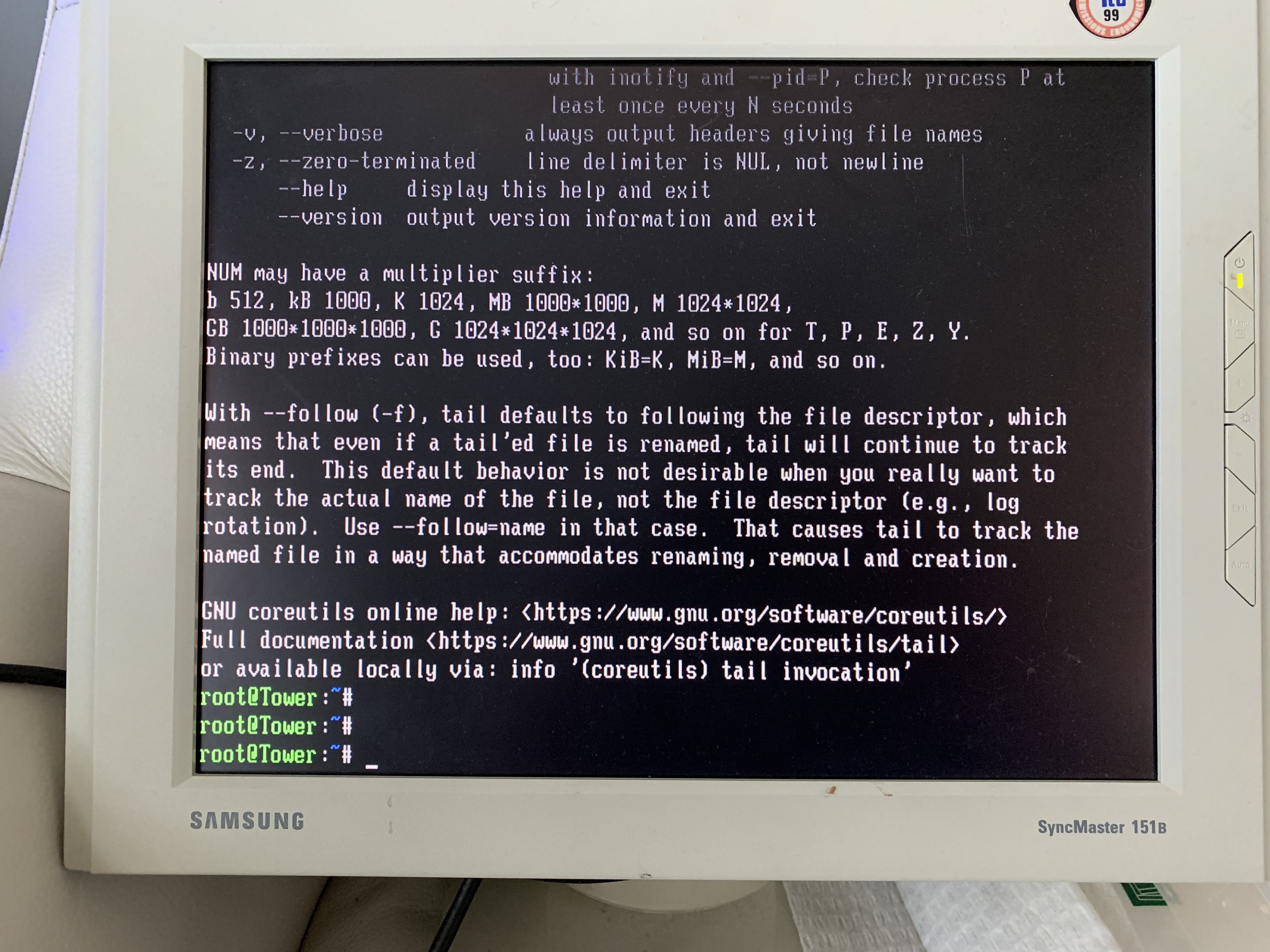

Ive been trying commands like - tail -f --lines=99 /var/log/syslog etc  on root@tower
not with much success I might add

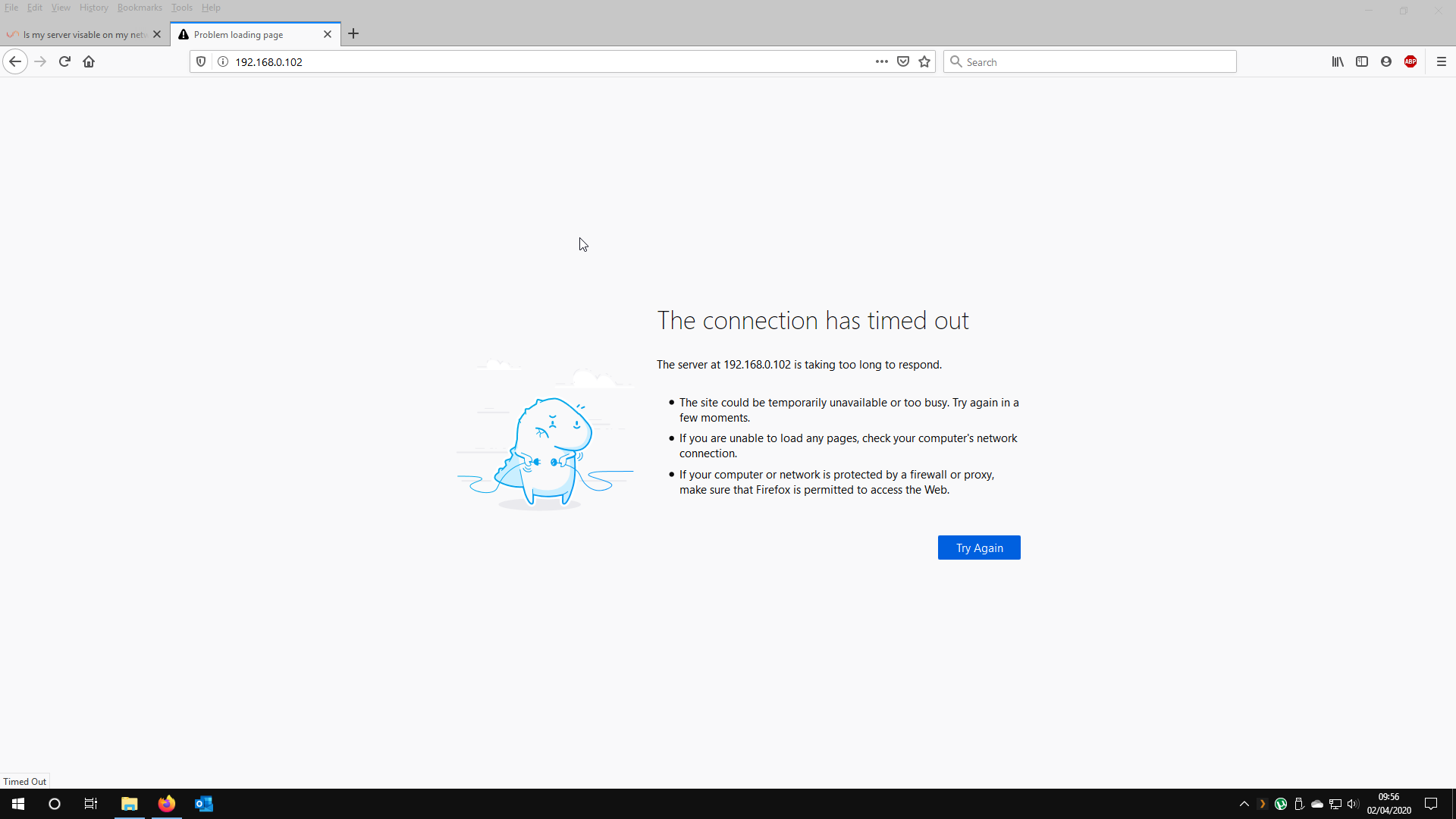

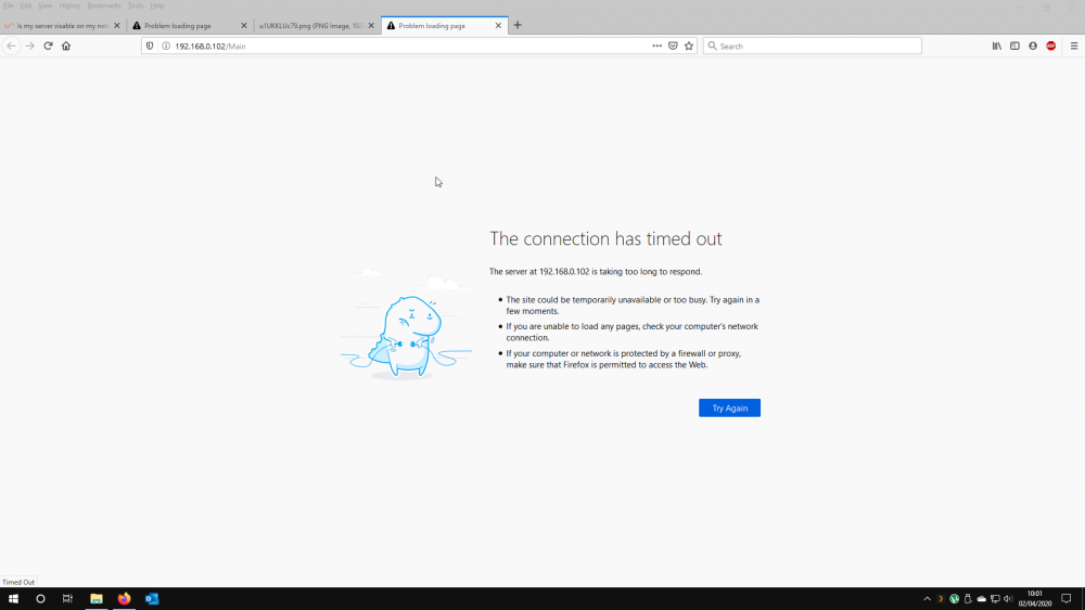

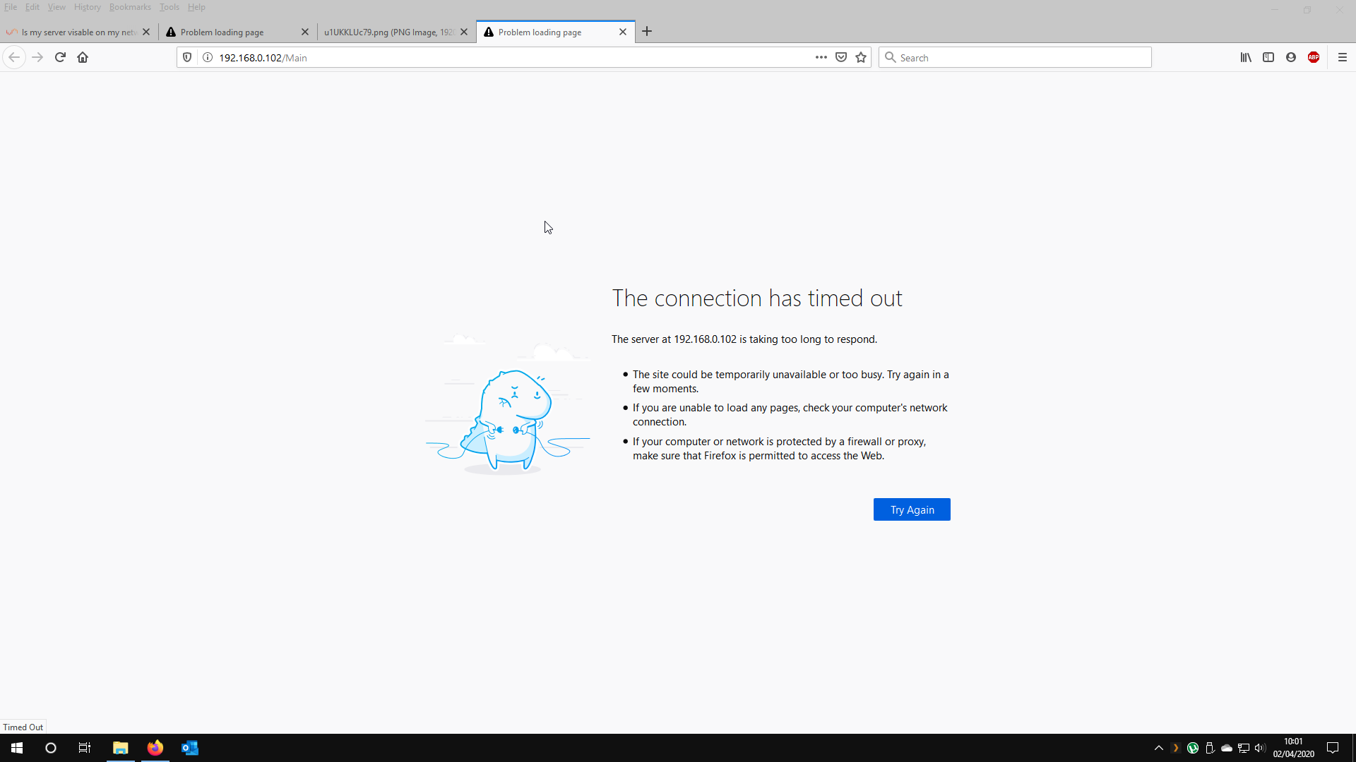

 I am unable to log into my server via a browser or any of my devices. so when i type 192.168.0.102 or 192.168.0.102/main which is my desktop shortcut - see pictures
I have chaged my cables - reset router the only access i seem to have to my server at the moment is the screen connected directly to the server.

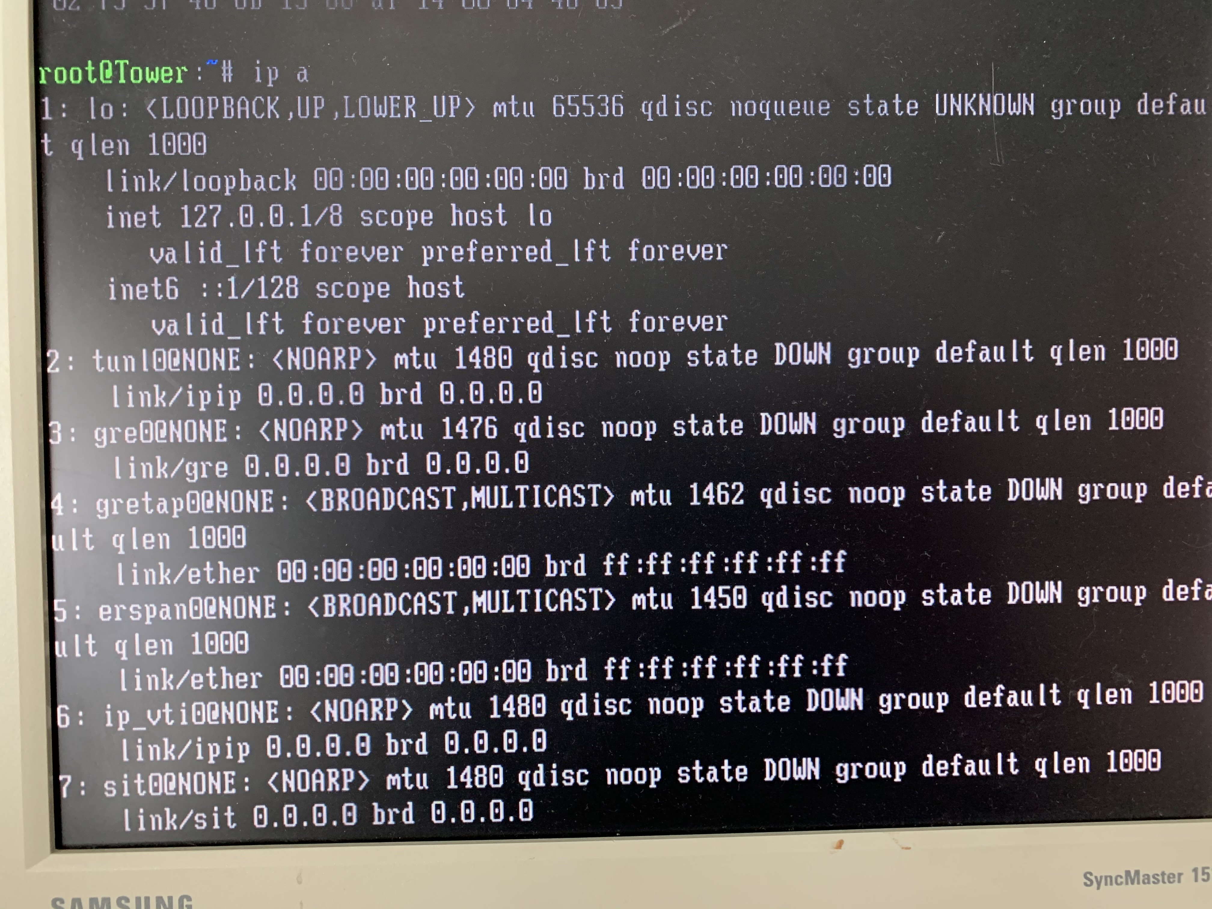

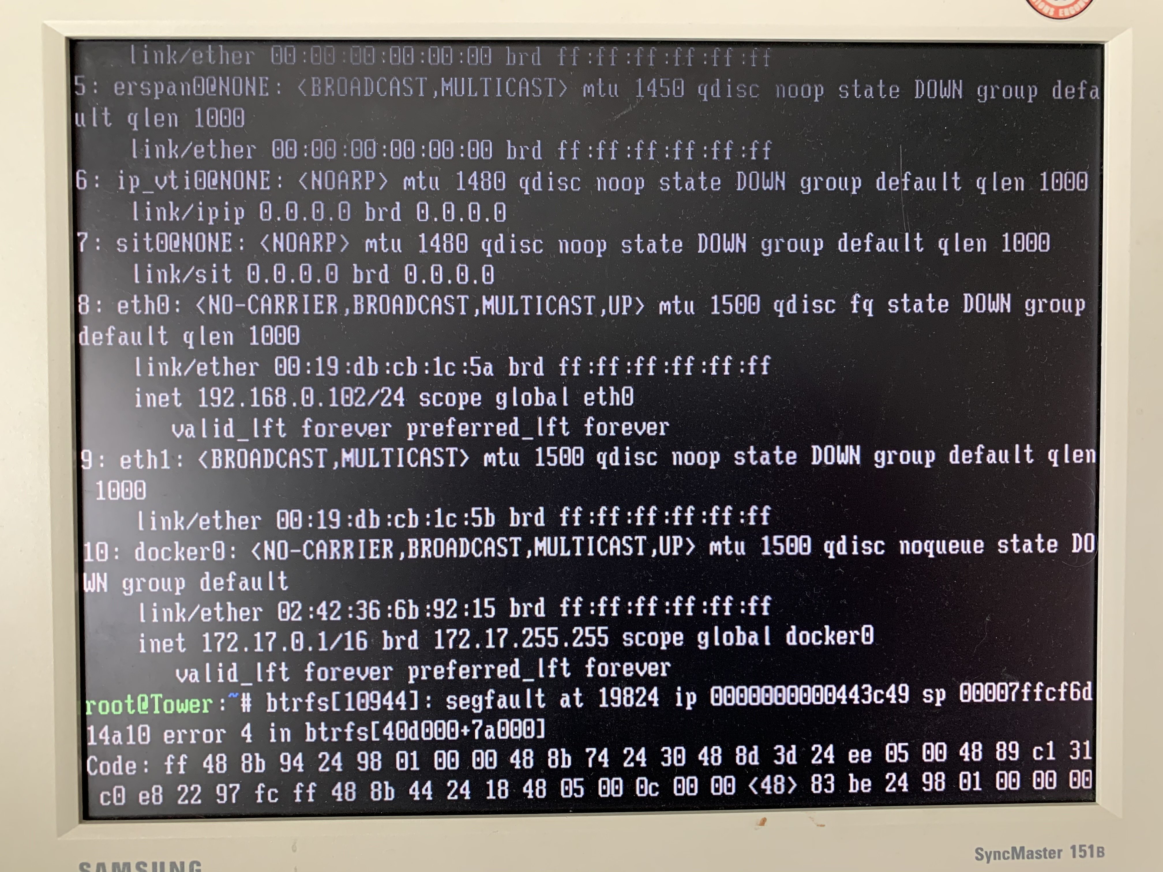

Did you checked with "ip a" that your ip is still in place?
Do you have a VM setup with autostart on server boot and a device passthrough active?
After spending ages trying to find out how to scroll up on my terminal - here are the scren shots..

Okay guys I have connected my network cable to my second port eth1 and the router has assigned and address of 192.168.0.22 which is good news. It looks like the other port eth0 is not working? I changed them over when I first had this issue but i did not reboot?  Am I a donut?
