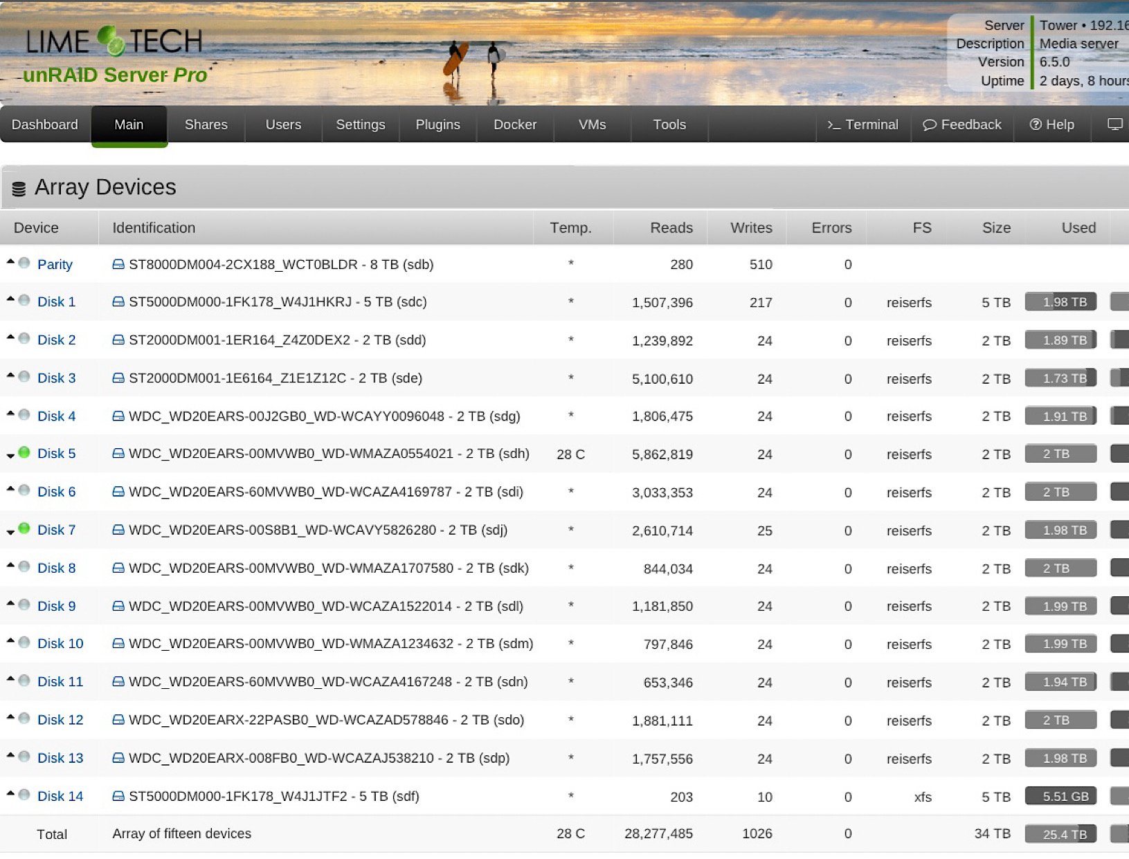

yes, 100% all were reiserFS (took screenshot before i played with server just in case). Most drivers were loaded on unraid 4/5 and reiser was default so i stayed with it. The only one not is xfs is one of the 5TB drives.

Attached screenshot i took before taking out drives. They were attached to other machine via standard sata ports on motherboard, no controllers. On MY machine, i use a controller just to add the extra disks (i.e. this style thing, cant recall exact model;
