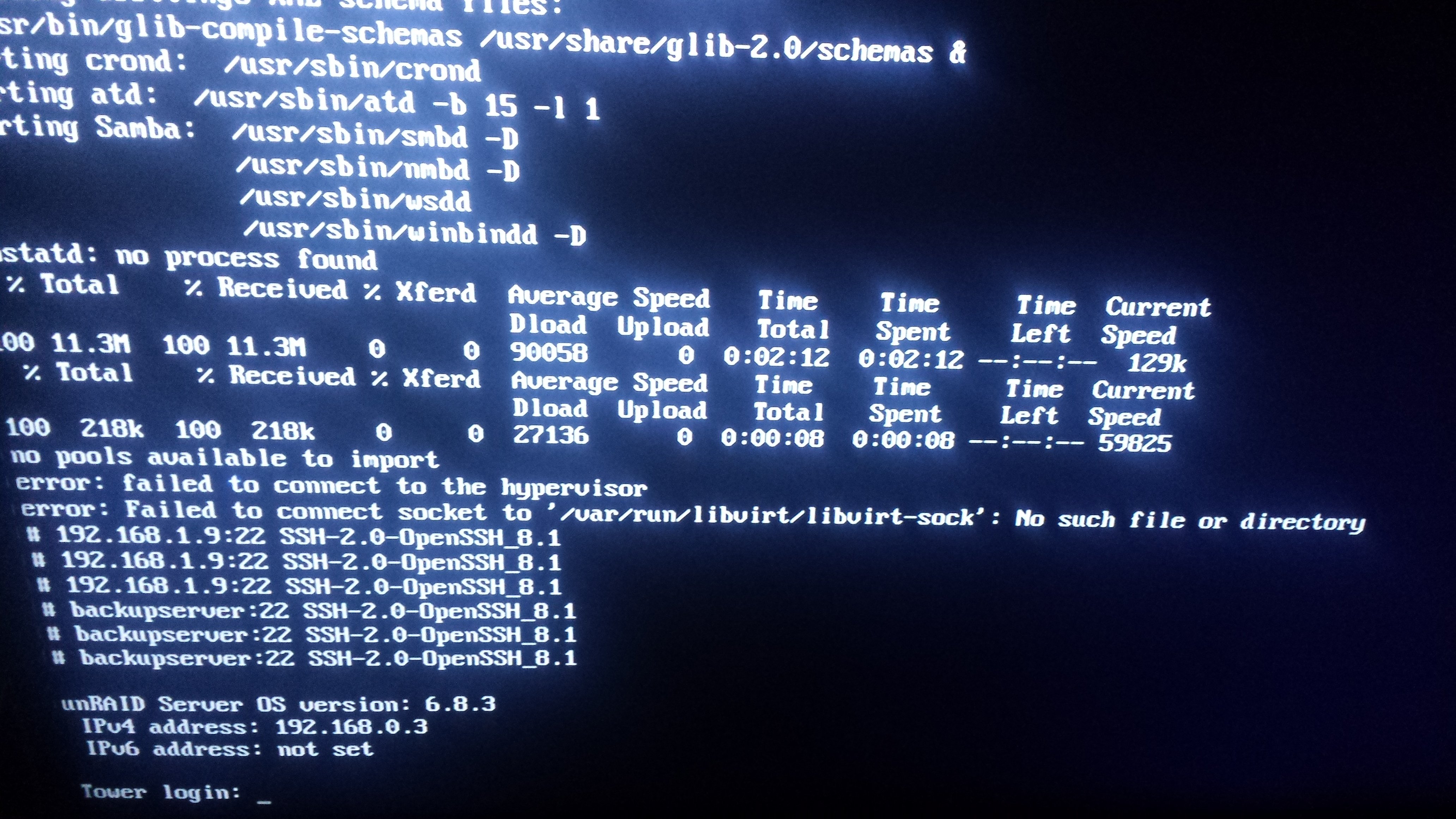

so I recheked  let it run for like 2 hours as I had other things to do..  so those errors are not there...  but I see couple other errors.. and I also show when it boots up there is some data verifying and errors around it but what is that?.. also I just decided to check my sisters unraid.. and its spouting warnings and errors.. maybe you can tell me whats going on with hers..  last time I check it had no errors just the like regular 10 warnings but now I seen its gone haywire

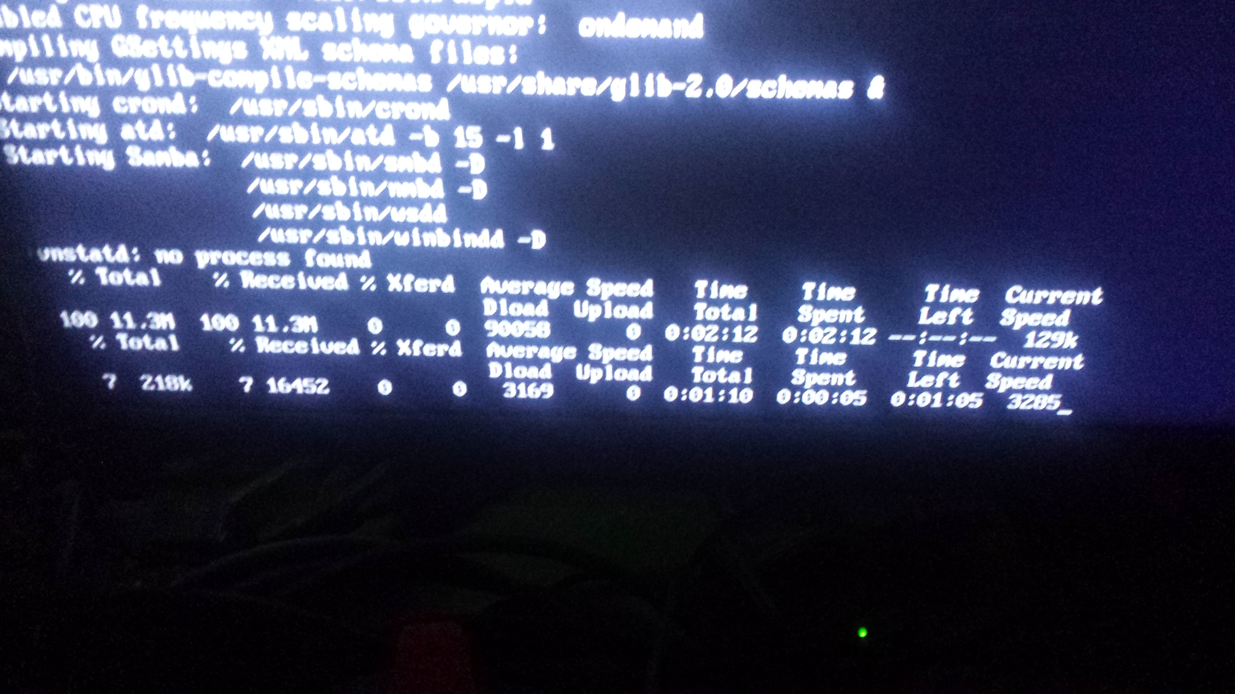

also  in the image I sent the 2 xfered. is that the 2 usb hard drives I have plugged in  is it doing a SMART check there?
