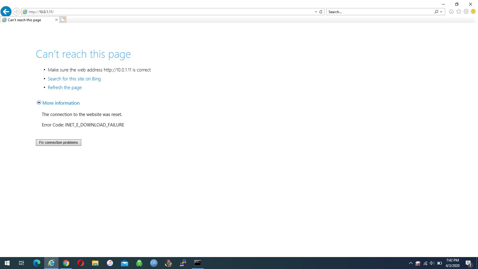

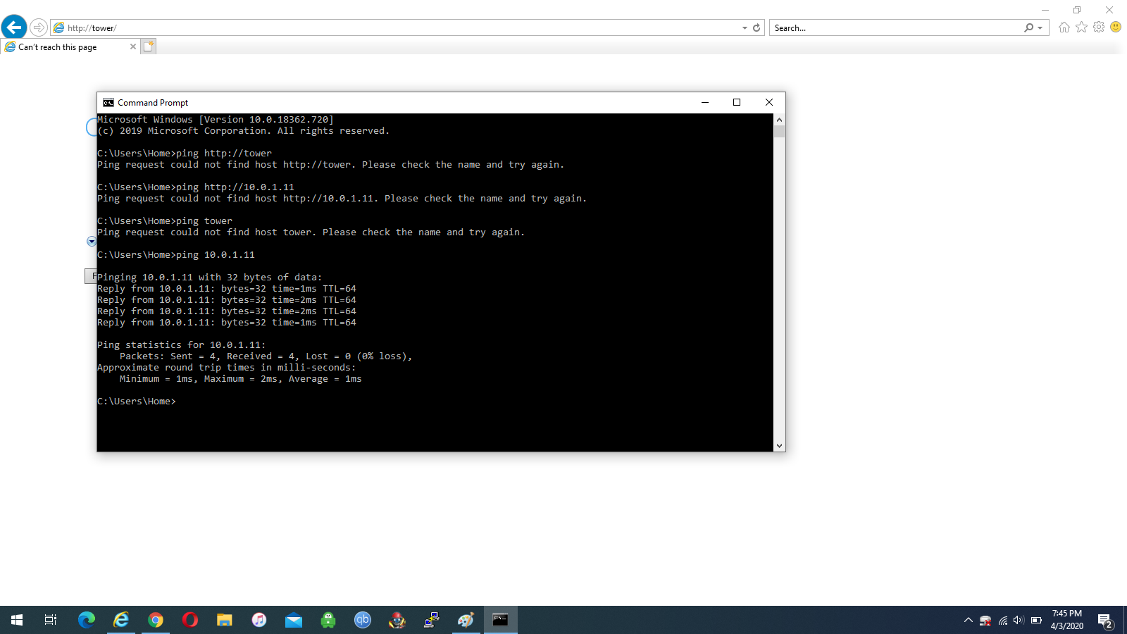

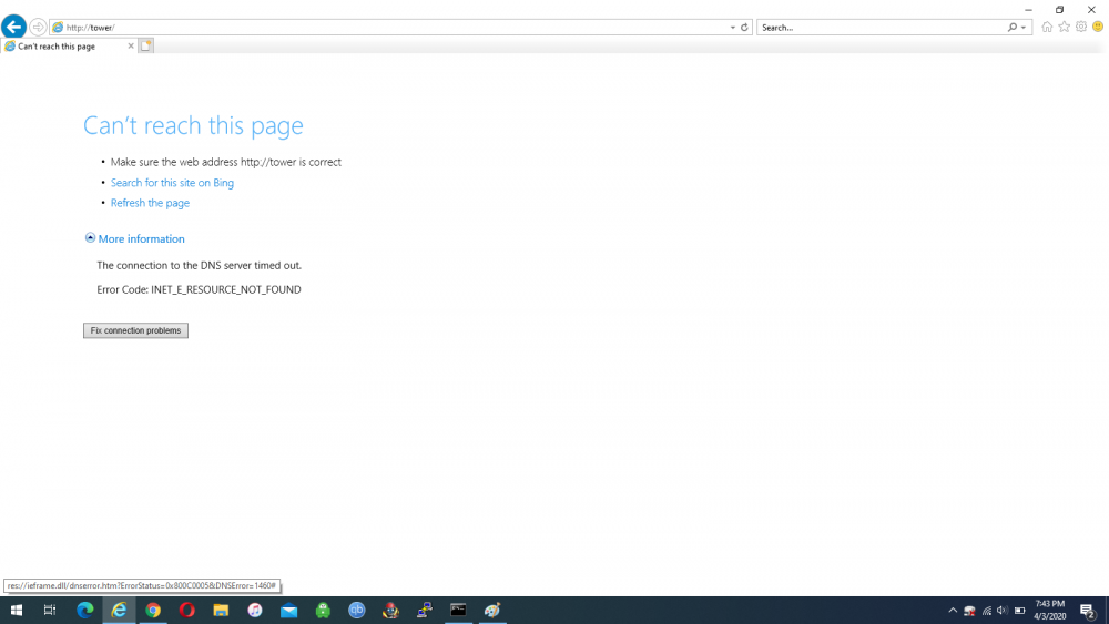

I built an UNRAID server about 5 to 6 years ago and I believe the version is the free version of either UNRAID 4 or 5.  I haven’t used the server for over 3 years due to different life circumstances.  About a month ago, I tried powering it up and the lights on the front of the server blinked but nothing else.  Since the server wasn’t powering up, I decided to upgrade the hardware (CPU, motherboard, ram, CPU fan, power supply) and reuse the old hard drives (2 drives for data, 1 drive used for parity) and reuse the UNRAID usb flash drive from the old server in hopes that I could then access my data.  I built the new server, connected the server to the router using an ethernet cable, turn the server on, enter root at the command line, enter ifconfig eth0 and received an IP address, the router also sees the server and I can also ping the server from my laptop but when I open either Internet Explorer or Chrome and either type in http://tower or http://ip address of the router, the web management page fails to load.

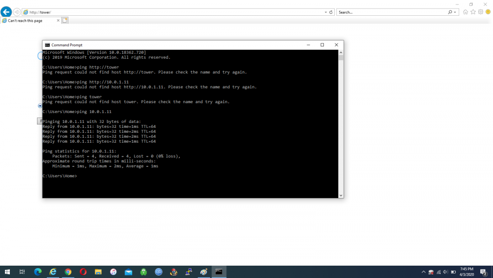

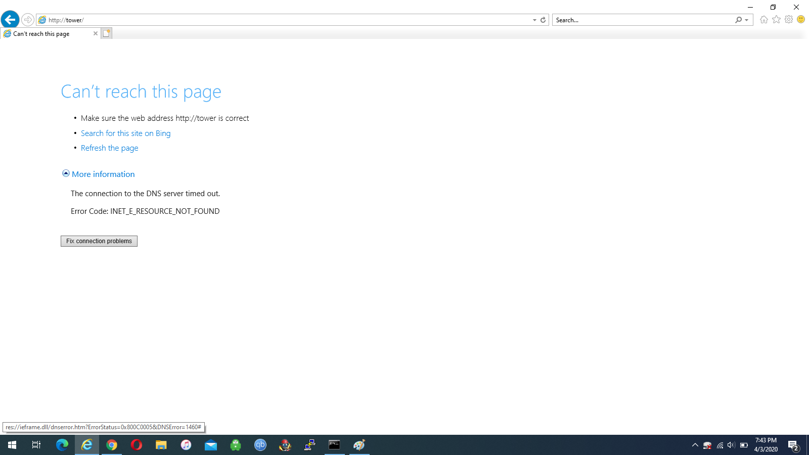

Hi Squid, trurl,
I tried changing my go file (/config/go) back to defaults as you suggested, reboot but did not fix the issue.  I also tried safe mode after making changes to the go file and that also did not help.
Also, when it comes to editing the go file, is it ok for me to plug the flash drive into a Windows 10 PC and editing the file using a text editor or is it best to edit using putty and vi text editor application?
I have attached screenshots when I try to access web management and me pinging the server.  Are there other suggestions I can try before I try upgrading to UnRaid 6?

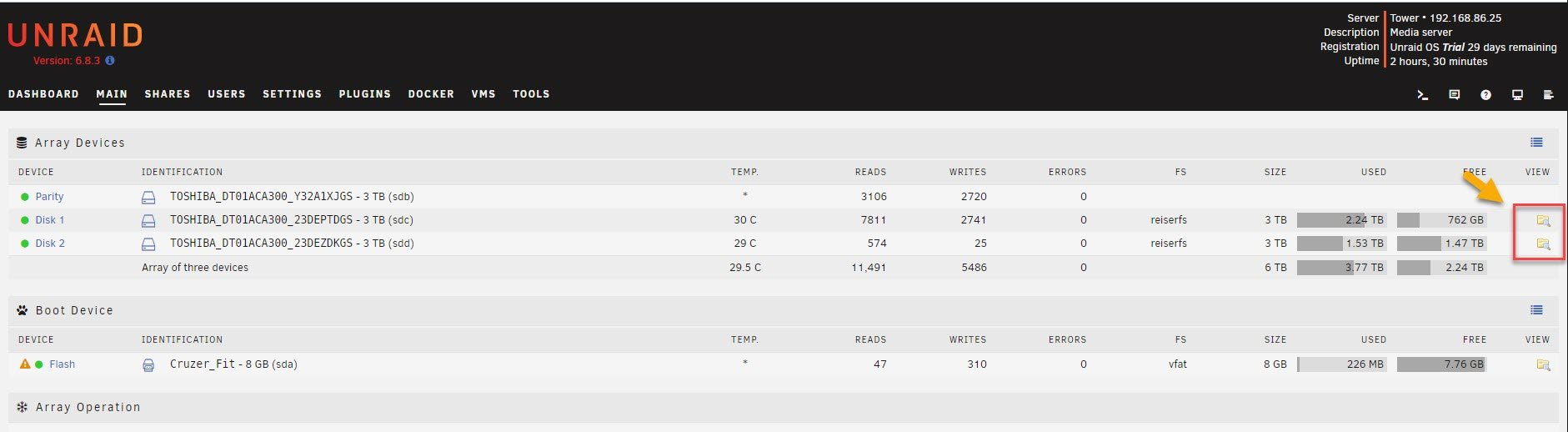

Hi @trurl @Squid,

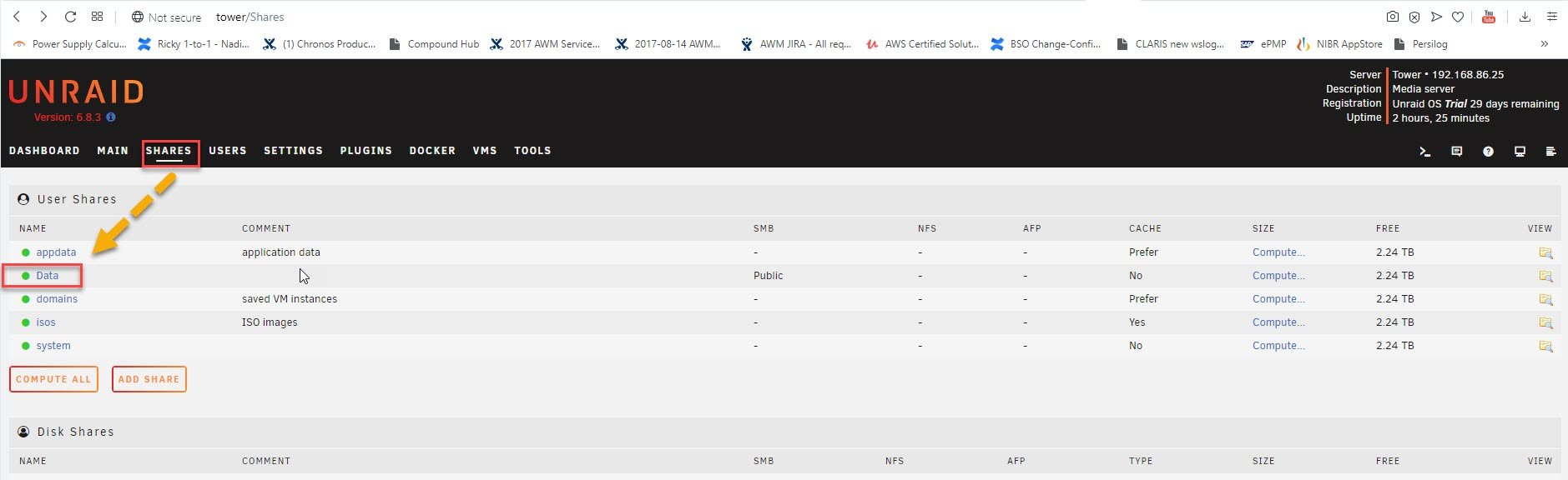

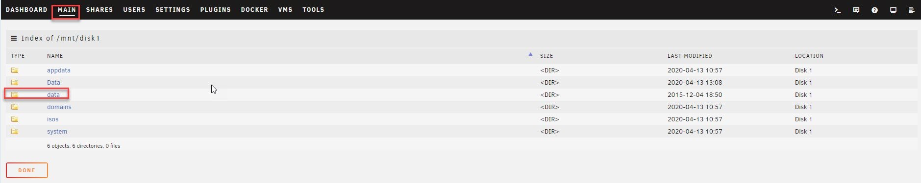

Thank you both for your help.  I followed the steps from Frank's short and sweet instructions from the upgrade page and now I can start the arrays, view the Shares from the Shares menu but there's no data in the shares (Data share.jpg).  I enabled export on all the shares and the only folder that contained files is the system share.  If I go to the Main menu, click on the view folder of either Disk 1 or Disk 2 (data.jpg), there's a data folder there that contains all my data (data 2.jpg).  How do I make this data folder accessible to the Data share folder?   Can I add a shortcut of the data folder to the Data share or is there something else I can do to make this data folder accessible?
Regards,
Ricky

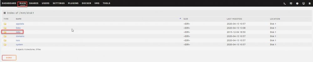

All top level folders on cache or array disk are automatically user shares, whether or not you have explicitly created them.
You are going to have problems with 2 top level folders that have the same name except for upper/lower case.
Which should it be, Data or data? Do both have files in them? Are both on both disks?

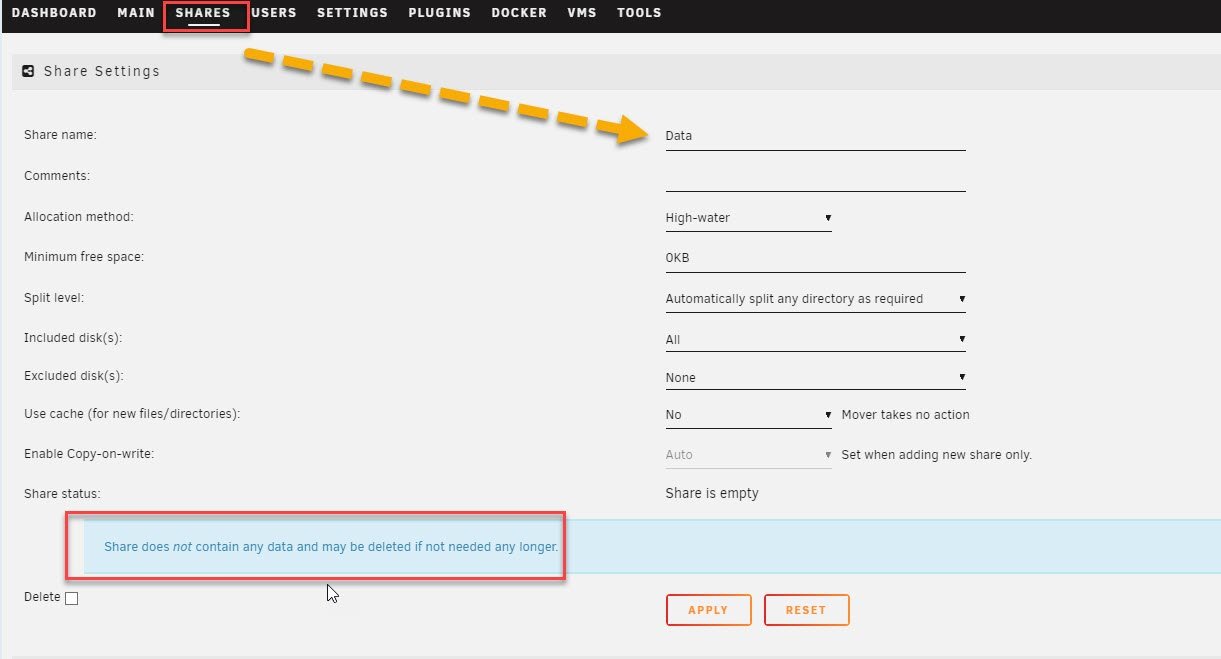

Hi @trurl,

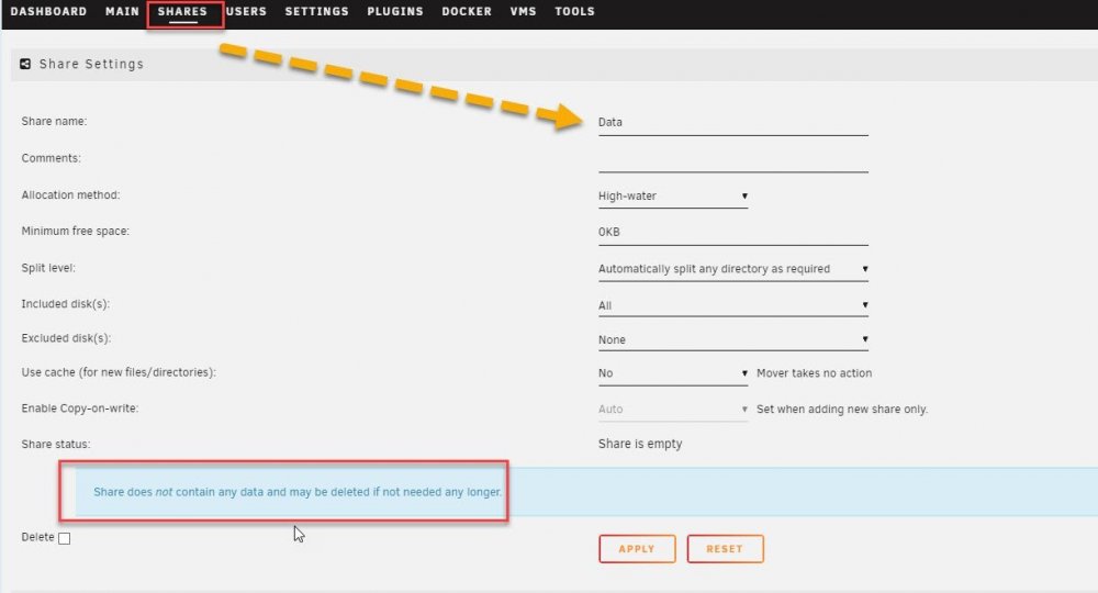

There is no files in the Data folder.  The Data folder is only on disk1 (disk1.jpg), where the data folder is on disk1 and disk2 (disk1.jpg and disk2.jpg).  I see that I can delete the Data share since there are not files in that share (Data share 2.jpg).  Do you think if I delete the Data share, would the data folder be accessible?
Regards,
Ricky
Probably.
Another way would be to manually delete the Data folder from disk1, then stop and start the array. Looks like Data has default settings so I'm not sure it has a .cfg file in config/shares on flash. You should also clean that up, probably by deleting both .cfg files if they exist. Then the only share that will still exist is the data share, and it will have default settings until you change them, with no .cfg files leftover to confuse things in the future.
It does bring up the question of how these got created in the first place though. Did you create that Data share in the webUI? Or did something else create it? Using the wrong upper/lower case when specifying a path will often do this. This is very common when someone is setting up their dockers.
Hi @trurl,
I renamed the "Data" folder under Shares menu now the other "data" is now accessible.   Thank you so much for your time and help!
