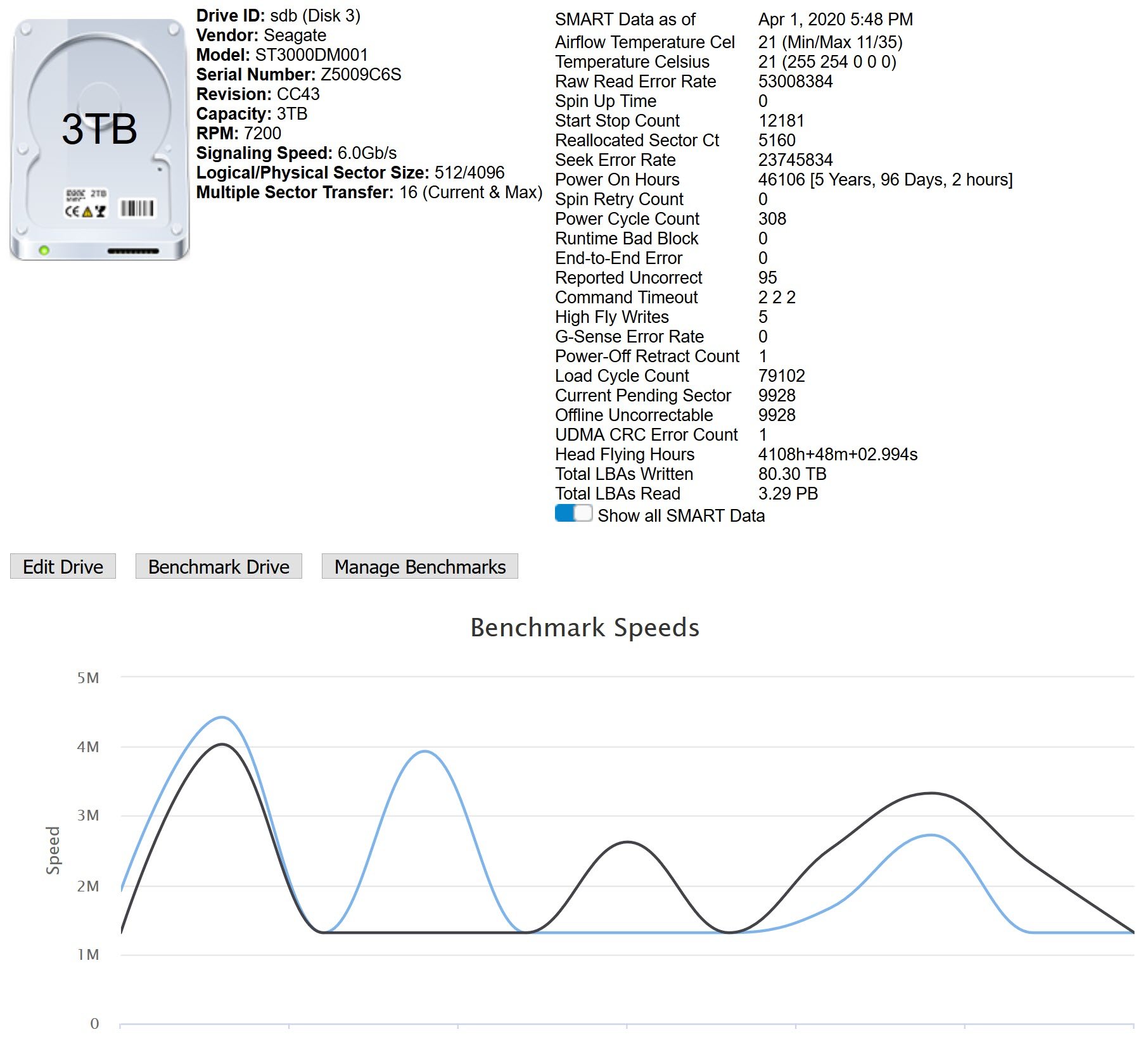

3TB array drive is super slow, can it be 'fixed'?
I've started seeing some errors on Disk 3, so I've decided to move all the files from that drive to my other drives, and to eliminate that drive, and do with fewer drives in the system.
I'm currently seeing about 2MB/s transfer speed from that disk, which means it will take about a week to move 1TB off the drive.  The drive in question is on a separate controller from the other drives in my system, and I'm wondering if I can move it to the same controller as the disk I'm trying to copy to to improve the transfer speed, but I'm not sure how that will affect the array if I move the position of 2 drives.

ChristopherBaber_20200402_102340.tar.gz media-diagnostics-20200402-1043.zip

7 minutes ago, JustinChase said:
Any guidance, or suggestions to speed up the drive would be much appreciated.
Unlikely to get better, I would replace it now, especially considering it's the infamous ST3000DM001
Thanks, I just ordered the new drive to replace it, but my current concern is how to get the data off more quickly than at 2.5MB/sec.
Any idea if moving to other controller, next to the disk I'm moving files to, will speed up the data movement?
