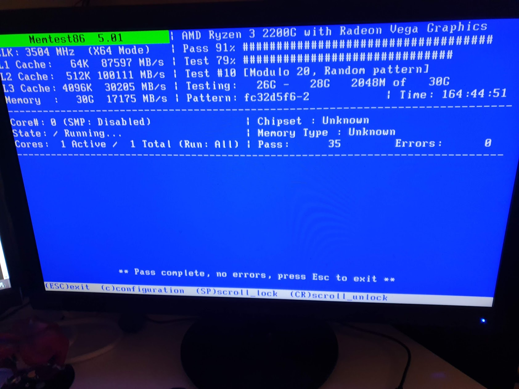

I have been running Memtest on the 32GB RAM Modules on the old board (where the same issue used to occur) for 2 weeks now. One week of memtest86, and one week of Windows Memory Diagnosis on max settings. Both resulted in no errors. I even ran the memtest tool @Benson suggested but again no errors.
Here is a picture:
Edited by permissionBRICK
I just realized that it shows 30G of RAM, shouldn't it show 32?

I think memory already prove not a problem (no error and no crash)
Some be share to IGP.
