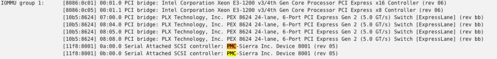

Hello, I am trying to get help. I just bought a DS4246 and a QSFP SFF-8436 Linux Server PCIe Quad PT SAS Card. I also have the cable that was used for this system. I have the card installed and hooked up by following THIS POST. The issue I have is that when I look up the system log and search Netapp nothing shows. I do see the PMC Sierra controller card which this is. is there anything I can do to make unraid see/use this card>
Please post the diagnostics: Tools -> Diagnostics
