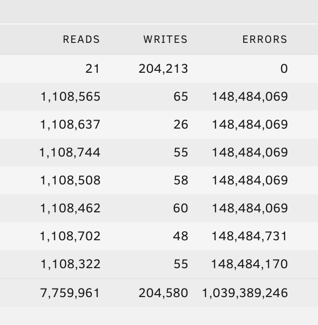

Something terrible seems to have happened to my server while I was performing some upgrades 😨
I wanted to replace the existing 10TB parity drive with a 14TB one so that I could add larger capacity drives to the array. I ran a parity check beforehand, which reported 0 errors.
After replacing the drive, Unraid began a parity rebuild, but didn't get very far before all drives in the array began spewing errors into the system log. I've tried the process a couple more times & the same thing keeps happening. After stopping the parity check & attempting a recursive ls on each disk, some files/directories can be accessed while others fail with "Input/output error". I can't view the SMART status of any of the drives either; it just says that "a mandatory command failed".
What the hell has happened?? How could all 7 disks in the array simultaneously go bad, after a full parity check beforehand not report any errors?
