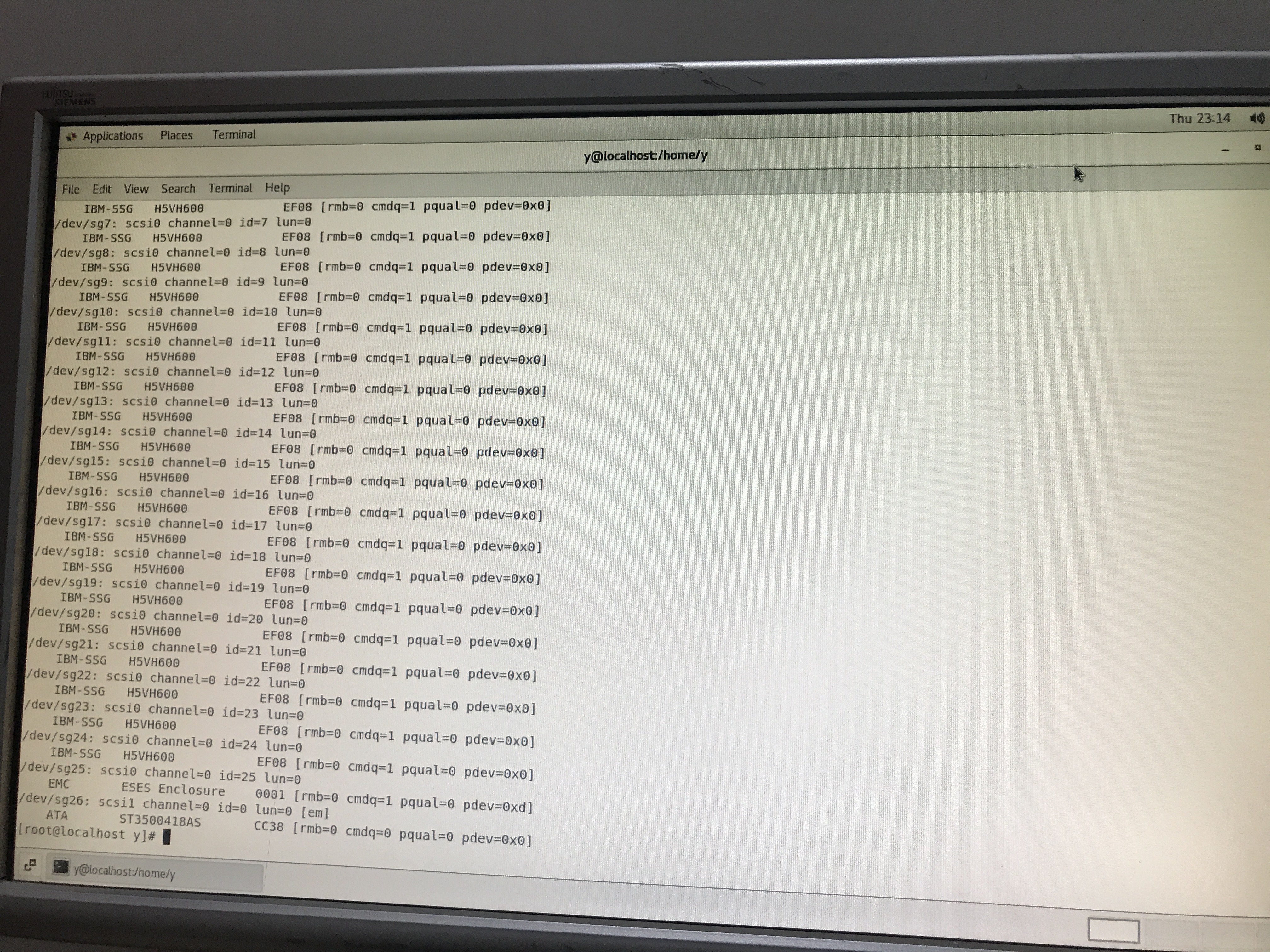

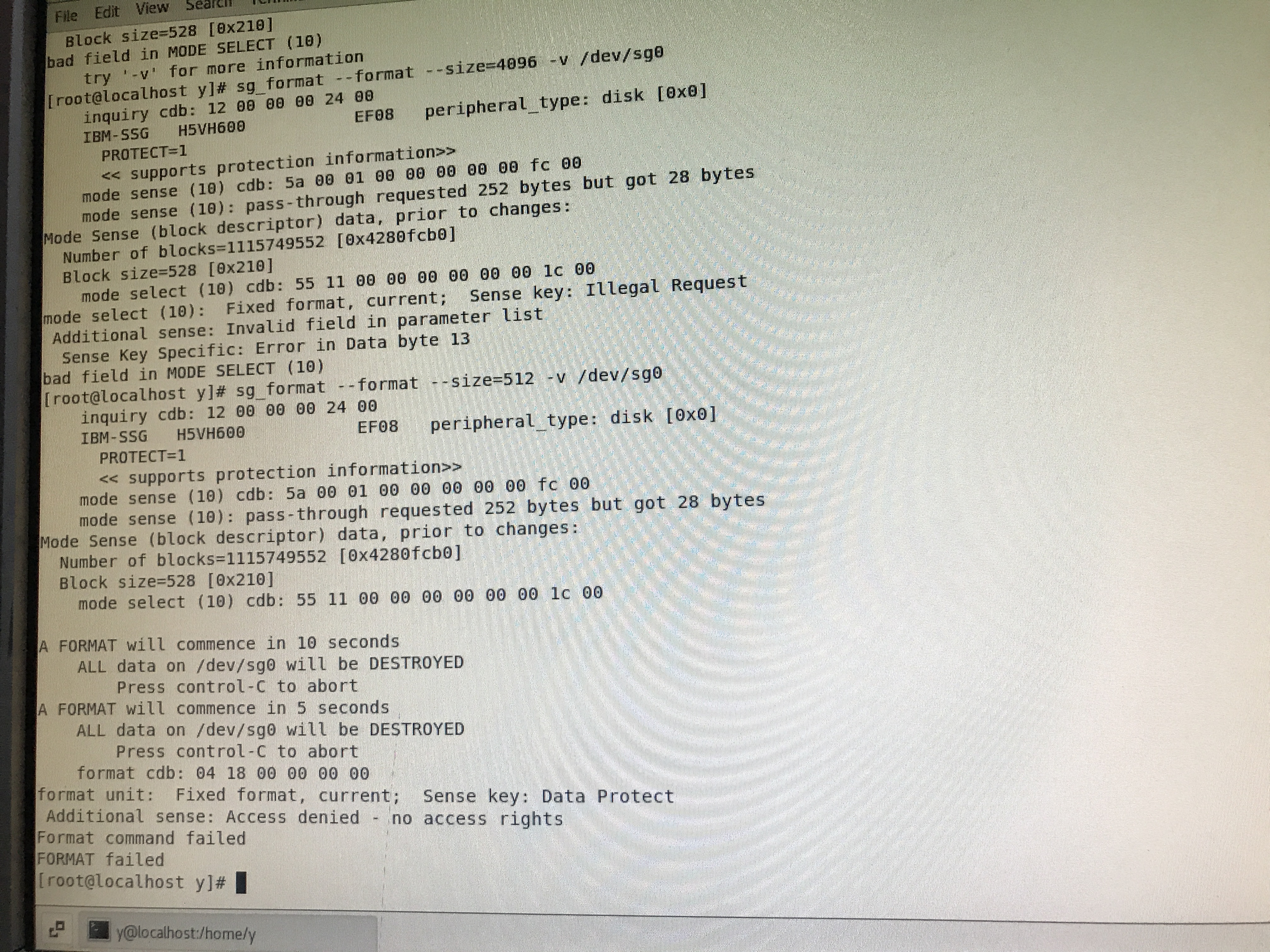

I've 50 units of IBM-SSG H5VH600 same error or issues. I think it's some compatibilty issues. Please help me if anyone have solution. Thanks in advance
