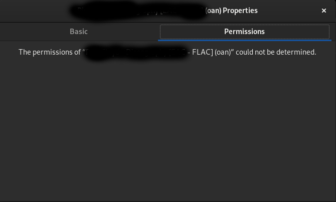

I just moved my main pc over to Fedora 31 loving it so far but having some issues accessing my media on my unraid server. I'm unsure if i need the smb shares enabled anymore as I doubt use windows now. It seems I can add new files (only tried 1) but can't delete anything.
Things i've tried
1 adding the user
2 setting it up with read/write
3 Tools > Fix perms
I've attached a pic and my logs/ diagnostics.
Thanks in advance!!
gizbo-diagnostics-20200404-0928.zip gizbo-syslog-20200404-1429.zip

Made a test share that's public using SMB. I copied over a random document and I can delete that, even though the perms could not be determined
Edit: So my user that I want to be able to delete things should be "guest" that last part has be a bit confused
Why do you need to know the permissions of the files on the Unraid server?   Unraid should be controlling the type/extent of access to the files in Shares when you are using either NFS or SMB.   And those permissions don't make a lot of sense from the standard Linux OS permissions perspective.
If there is a access issue to files on the server from your PC, the file/directory permissions on the server will often be checked-- to make sure some Linux process (running on the Unraid server) has not screwed things up!  But you have to do that more from the command line running as   root   than directly from a file manager on a PC.  (That is because the Unraid Share service layer is hiding them from you.)
You made the change from Win10 to Fedora.  (I assume fairly recently.)  Did you actually read whatever Documentation that they have provided on networking?  Hopefully, it will contain the answers you are looking for and give you some inside into how the underlying things work.  You may have found some 'gotcha' in Fedora.  (With Win10 and SMB, the Collective has figured things pretty well out.  Most of the 'gotchas'-- and their workarounds--  are now known...)
PS--- By the way, Windows has a 'service' where it will automatically log you onto a server.  (That can cause all manner of problems.)  Windows also limits you to a single connection/login to SMB on a server.  These are often the types of things you have to be looking for...
