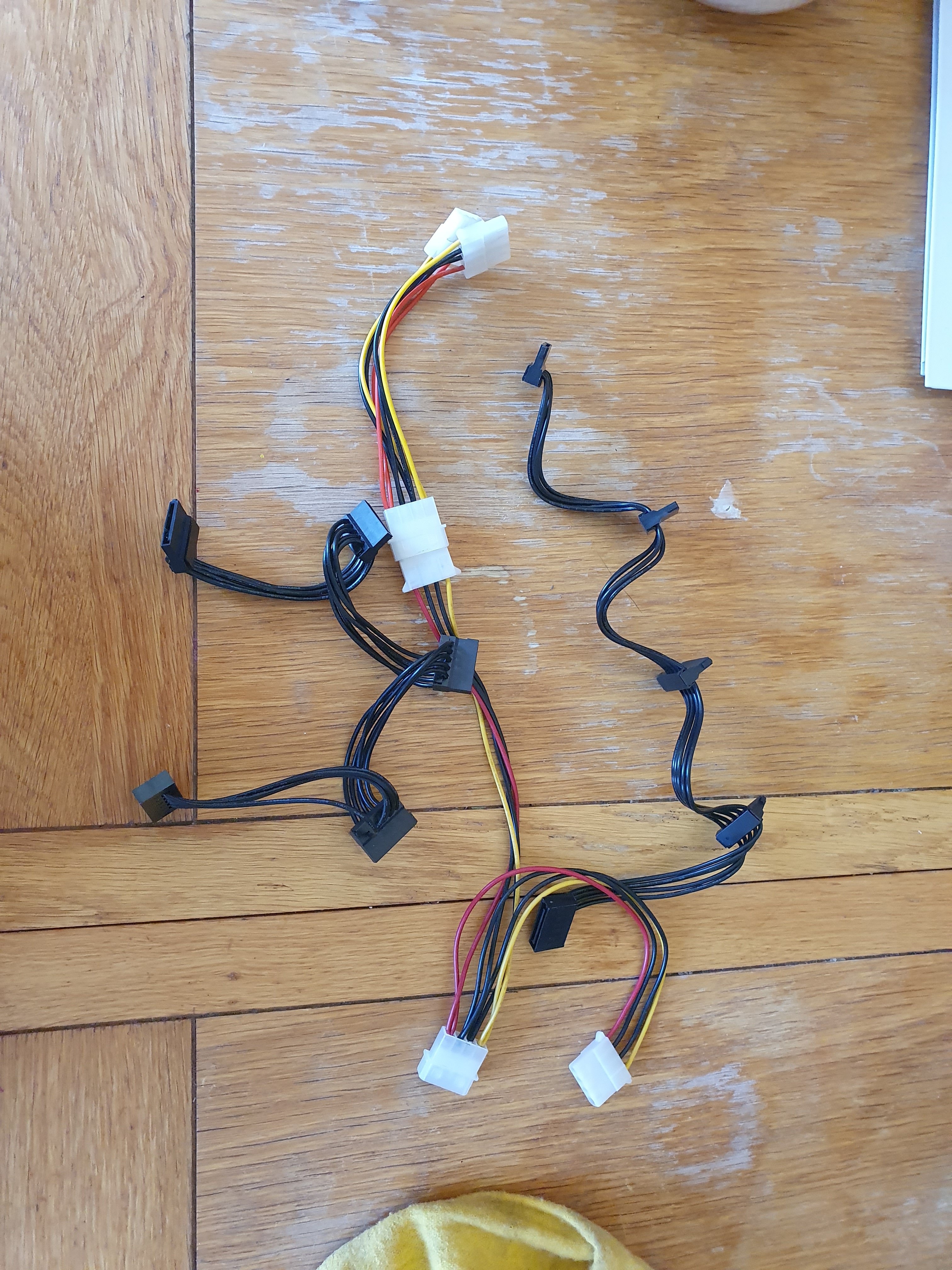

Removed all of my molex to sata splitters and got proper sata extenders by cable matters.

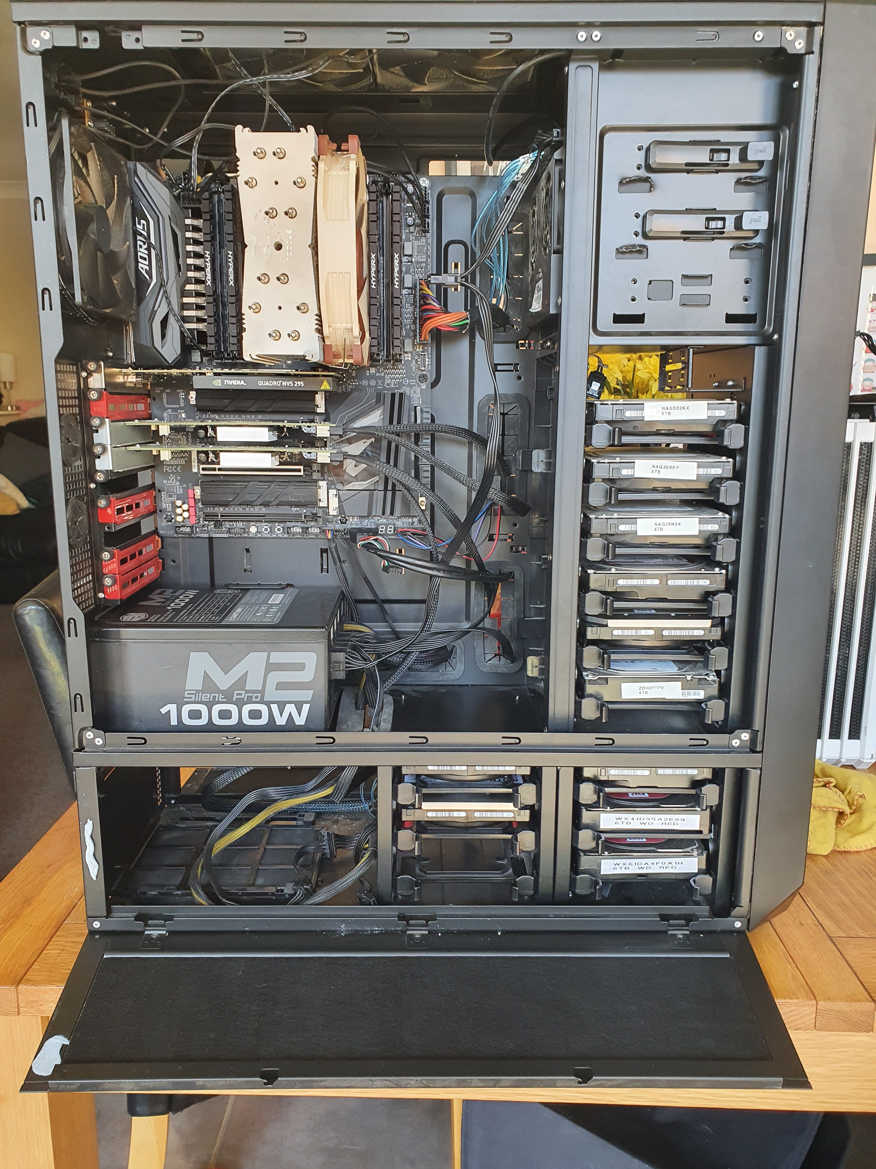

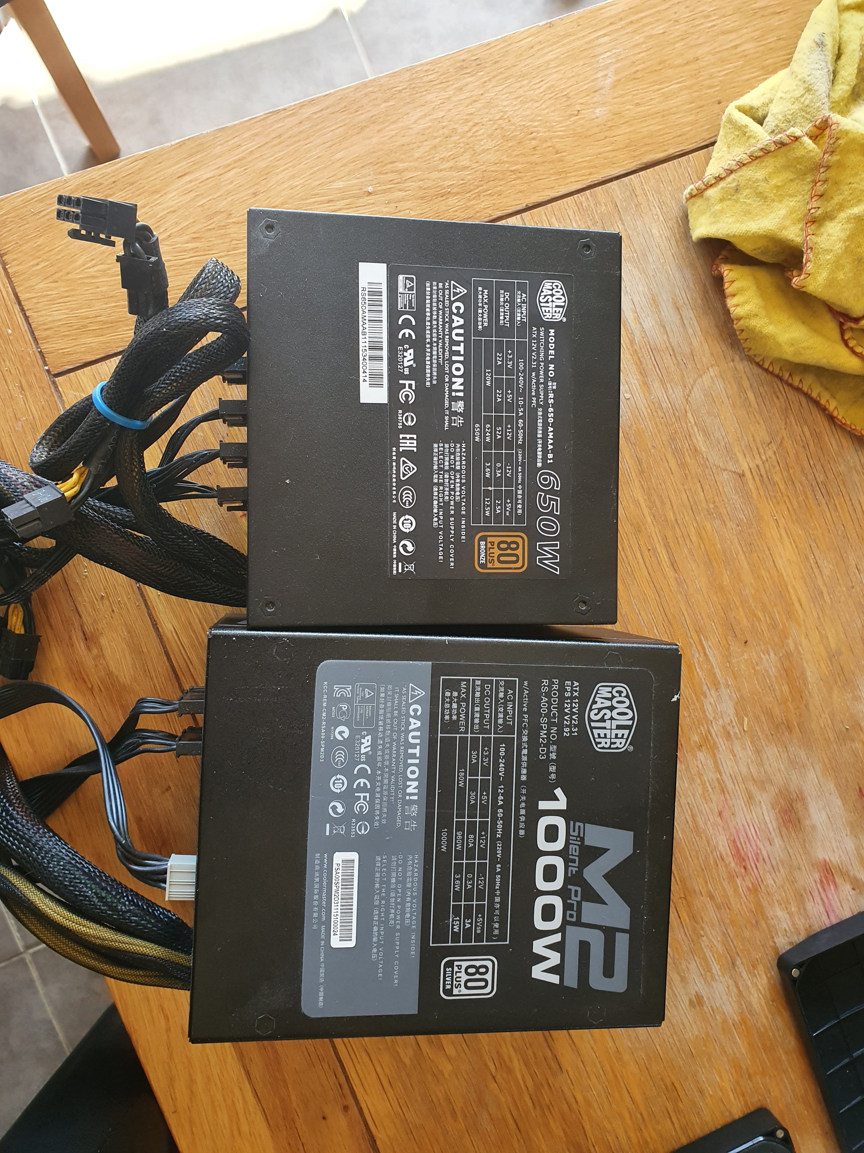

OK so I have swapped out the PSU's from my unRAID machine and my Gaming machine. I do not have a Corsair 650Watt as per the original post it is a cooler master 650Watt same as my 1000Watt Cooler Master in my gaming Rig(Photo below of the 2 PSU's).
Put the 1000W in the unRAID machine and also removed my Sata extenders as I have 16 x Sata connectors on my 1000W PSU. I was also able to remove my Molex splitter as the 1000W PSU molex can reach as I have put the PSU in the top chamber of the case where I had the other one in the bottom (Antec 1900)

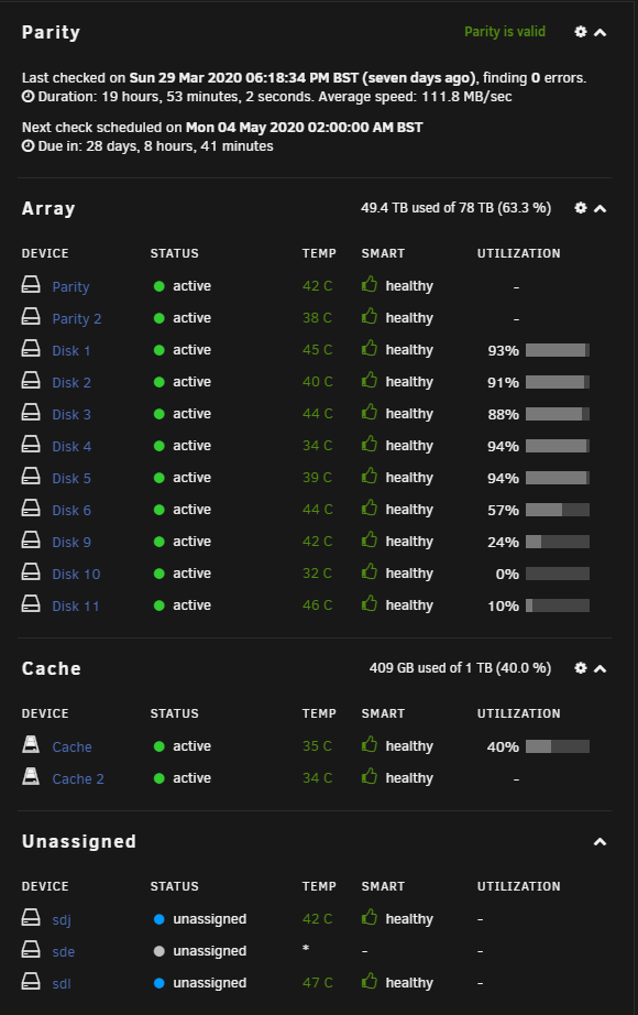

I turned the unRAID box back on and let it do the Pre clear on the 2 "Dead" drives. I have also plugged all drives into my Dell H310's now so none of them are on the motherboard at present. Photos below.
But as it is a lovely 20c in Isolation today we decided to have a BBQ (Last photo) so the Gaming PC is still in bits and will put it together tonight or tomorrow.
For now the unRAID machine is showing 0 errors so will wait and see how it goes over the next week as I need to do the Pre clear then add the drives back into the array and do a parity SYNC.

If you're not using those other 2 x16 slots, you should move one of the HBAs to them.  They get hot under full load.
Thanks @Squid I was thinking of doing that. I had a P2000 in there and a 10GB nic but took both out as not being utilized and was just going to get a 1060 for transcoding if I can get this issue sorted.

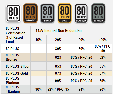

An underpowered PSU, or an overloaded PSU rail will result in overheating in few possible ways:
1- The PSU will go beyond it's efficiency curve and put out more heat
2- The wire itself will heat-up if overloaded (that is less likely because something would shut down before you get there!)
3- If the PSU provides less than the required 5V or 12V due to overloading, components could still work, but will pull more current as the tension lowers (and it is a vicious circle!). More current = more heat.
People sometimes find it stupid to get a high quality, high power PSU, but it makes a ton of sense in the end... The important thing is to look at the efficiency curve of said PSU... If your usage is in the sweet spot of efficiency, the expense will pay for itself over time, especially on a 24/7 setup! You can look at the attached image for a general sense of what efficiency ratings mean for computer PSUs.
By the way, I stopped using cooler master branded PSUs because they are, to me, inferior products... I had many issues with this brand. Their cooling solutions are excellent though. For good PSUs, I prefer Seasonic and I've had a good (single!) experience with EVGA too.
By the way, I am amazed that computer still use those cheap MOLEX adapters after all these years... You pay a lot of money for a high quality PSU to have it end with one of the cheapest connector there is! These connectors have poor contacts for their given size... But hey, they are the industry standard and will probably not be replaced in the near future! Maybe in 40 years! :D

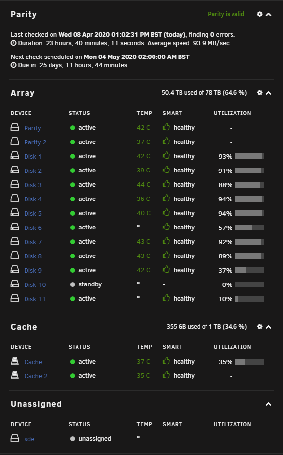

Both my 6 & 8TB "Dead" drives have now pre cleared and about to put them back into the array for a parity sync.
Also purchased 2x 40mm 12v 2pin fans to put on the H310 cards but as usual it is from China with someone pretending to be in the UK so will have to wait 4-6 weeks for it to arrive 😡😡.
Thank you for the comments @Normand_Nadon I am baffled by the temperature reduction it is amazing me that a sata splitter and molex splitter can cause this much heat. The 650Watt PSU is in my gaming PC now although it is only running a 1080 Hybrid, Ryzen 5 2600, 3 drives and so on it is performing fine.
Will let the Parity SYNC complete and get the coolers on the H310 but hope this means the issue is resolved but only time will tell really....

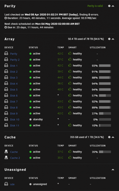

Parity check complete and all disk appear happy now.
It is 22c in the UK today and my Server is running great.
Last week with the old PSU when it was 9c outside i had 3-5 disk over 50-55c.

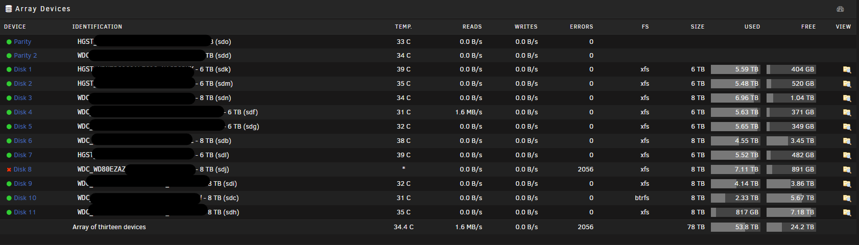

Had great uptime and performance for 10 days.
Today needed to switch the server off while doing electrical works in the house as a precaution as the UPS is still broken.
Upon powering on within 2 minutes a "failed" drive again!
Diag attached.
Array did not want to stop so had to do a reboot from the GUI.
Disk reported 2056 erros as per the screenshot
it is now out of the array doing a pre clear. I know the disk is fine unRAID is just a fanny!
Was hoping switching to a 1000W PSU and removing all splitters would solve my issue.
Had enough of this!
mufasa-diagnostics-20200420-1352.zip
Just a thought... Maybe your parity disk is going bad too? It would report data error upon checking for parity, I guess... No?
