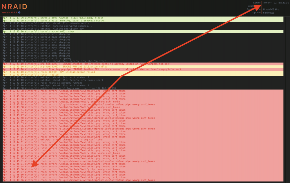

I just installed this system, I rebooted it, and now its flipping out.
1.) It keeps losing one of the cache drives
2.) started calling itself TOWER even though that's not its name.
3.) Terminal colors are missing
447621697_ScreenShot2020-04-04at2_48_43PM.thumb.png.76aa716b84450dd7849bc88cac735d87.png
rebooting does the same thing (log in screen says Winterfelll) then it get to the main page, says it missing a cache disk, then starts calling itself TOWER
tower-syslog-20200404-1948.zip
tower-diagnostics-20200404-1449.zip
update: DISK_ASSIGNMENTS.txt appears to be completely missing
Edited by wesman
I also, replaced the "go" and my_bashproile files with ones from from my backup system (as they have stuff I wanted in there)
Would that have caused this
Without even looking at anything, the only reason for your symptoms (ie: Tower vs Winterfell) is that the flash drive dropped offline.  Use a different port, ideally USB2.0 as USB3+ sucks for reliability and consistency
