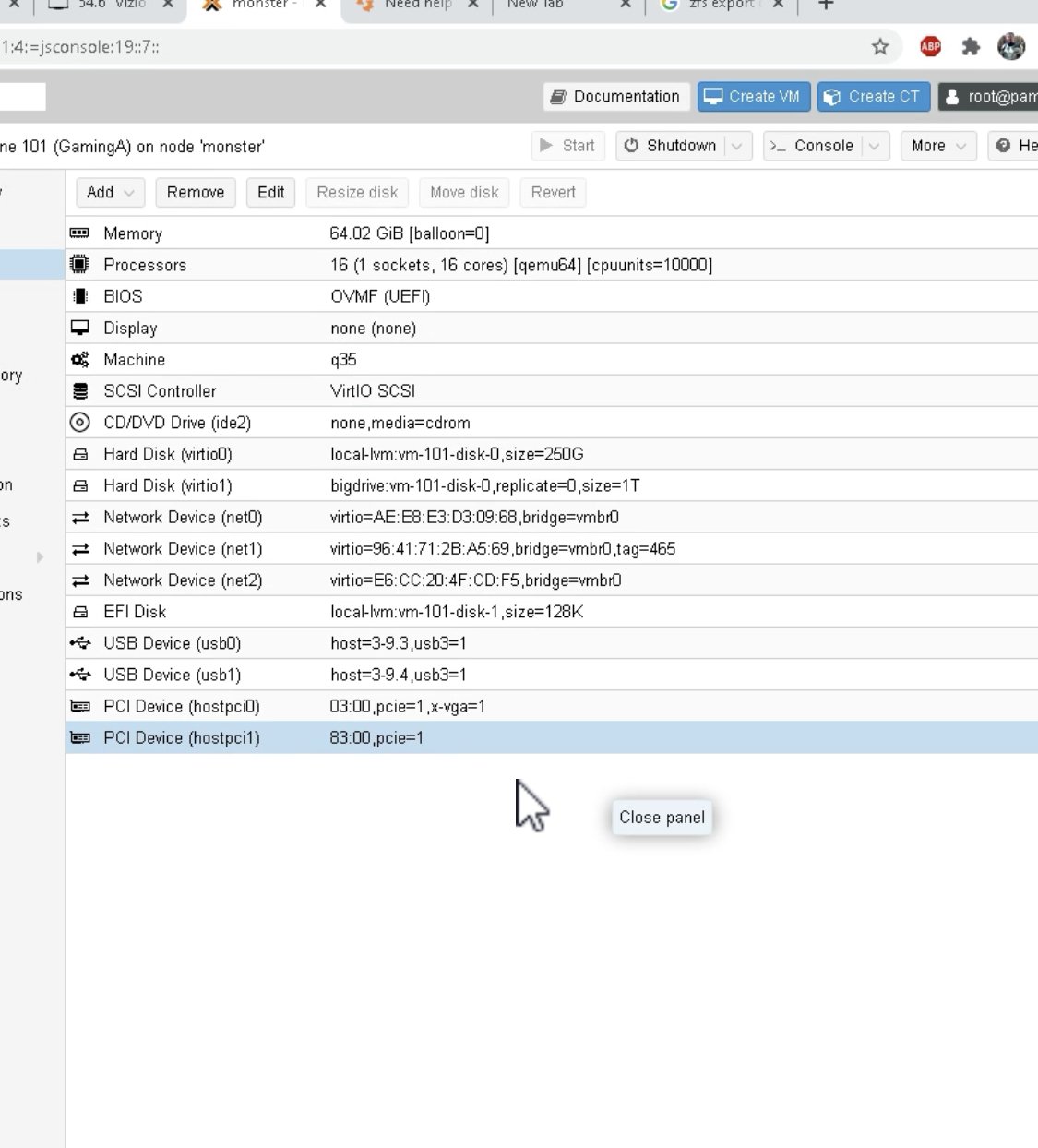

June 15, 20206 yr this worked for me, I no longer use unraid but I tested it with proxmox 6.1-3 and I passed through a Fresco Logic FL1000 USB 3.0 Host Controller to my gaming vm and was able to enable Oculus Link for my Quest. No problemo

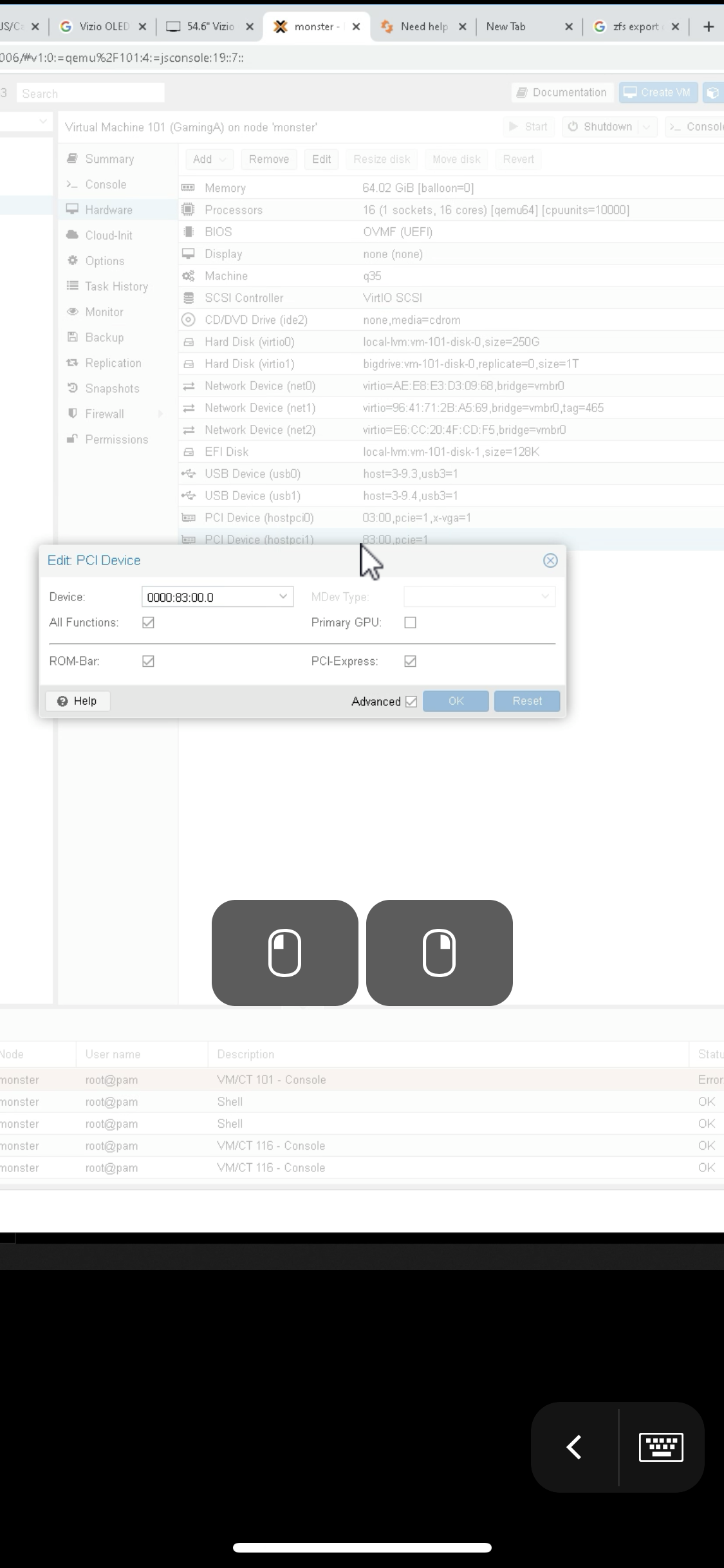

July 13, 20206 yr Hi, I bought the same card and am passing it through to Proxmox 6.1-7. Unfortunately, when I start the VM receiving the passthrough, the whole of Proxmox hangs and I have to reboot the host. I'm just using the UI for the VM and passing the PCI card through like I do with the GPU but I assume there is something I'm missing here. @Magicmissle, can you give more details on how you achieved this please?
July 13, 20206 yr 35 minutes ago, bowerandy said: Hi, I bought the same card and am passing it through to Proxmox 6.1-7. Unfortunately, when I start the VM receiving the passthrough, the whole of Proxmox hangs and I have to reboot the host. I'm just using the UI for the VM and passing the PCI card through like I do with the GPU but I assume there is something I'm missing here. @Magicmissle, can you give more details on how you achieved this please? @bowerandy I did have the freezing problem when I first started trying this I can’t remember specifically what the solution was but some of the things I changed were bios related to APCI and power management. I’m running a relatively old motherboard ASUS z10pe-d16-ws though, I haven’t upgrade because it lets me play with 512GB ram and 2x 22 core CPU’s. I did notice a huge impact moving from legacy booting to UEFI, also another adventure was figuring out that windows VM’s played much better running as OVMF especially when passing GPU’s or other PCIE devices. I spent years fine tuning unraid from 5.x-6.x and never really got the same performance:headache ratio with proxmox. It worked out of the box minus minor tweaks. I’m curious as to what your bootflags for grub are and more details about you system and configuration. I included some pictures so you can see how I’m passing my usb card to the gaming vm. Edited July 13, 20206 yr by Magicmissle
