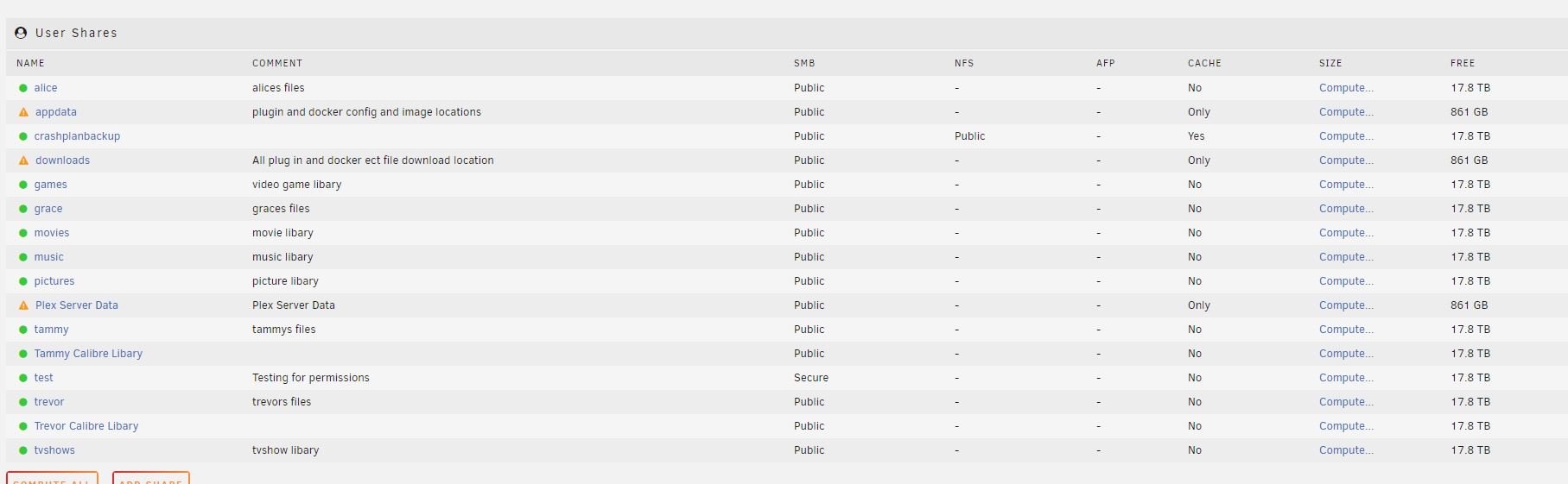

14 minutes ago, snuffy47 said:
How to I locate the lost and found folder to see what is in it.
Post a screenshot of your User Shares page
See attached screenie opps forgot to attach

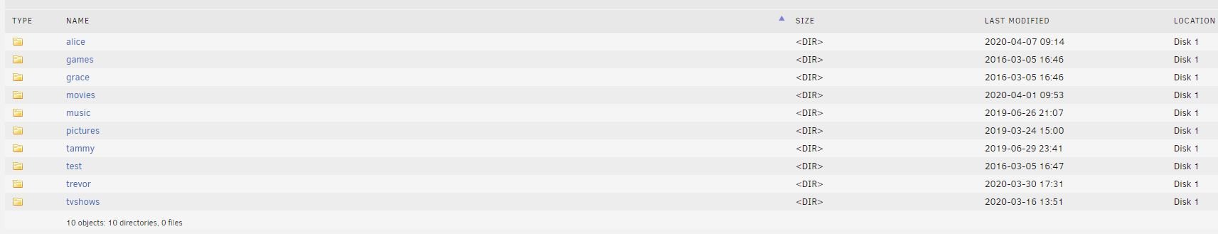

Okay after sleeping on this was thinking I should move my user shares off of Disk 1 and replace with new drive - stop me if I am thinking about this wrong
For sure the help above solved the Unmountable message and big thumbs up for that.

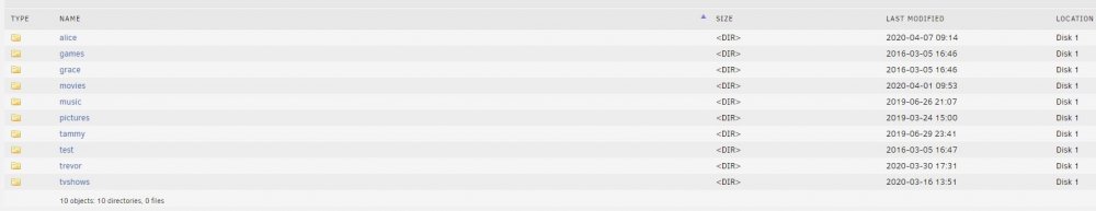

Planning on using MC in terminal and have attached my user shares on Disk 1 fr reference.  These user shares use all disks

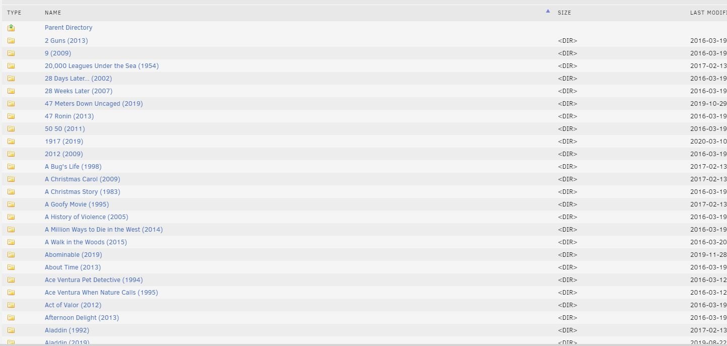

If I want to move the folder movies from Disk 1 to Disk 7 I would use MC in terminal and   mv /mnt/disk1/movies /mnt/disk7.....  Am I on the rght track here
