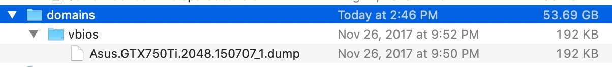

When I actually tried to find the Vdisk in my domains folder, it says my domains folder is 54Gb (which I believe is about the size my VM was taking), but I can't see the actual vdisk1.img file. See attached image.
If I can find this file (and back it up), I might be able to fix this issue.

After searching again, it looks like my domains folder is now 192 Kb. So yes, I have officially erased my vdisk and I have no idea how.
