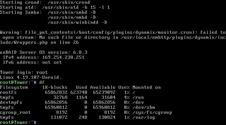

The video seems to show that Unraid is failing to find and mount the flash drive during the second phase of the boot process.     Have you checked that it has a label of “UNRAID”?   You can check if this is the case by logging in on the console and using the ‘df’ command to see if it shows the flash drive mounted at /boot.
If I connect it to Windows, yes it's labeled Unraid.  Afterall every test I've done has been using the USB Creator at which point the final product is the drive labeled Unraid before I eject it.
This is what the df command returns after login at root.
Edited by IamSpartacus
It has to be UNRAID (I.e. all capitals) or it will not be found.
the ‘df’ command output confirms that the flash drive is not mounted and until that is resolved you will not get your network up as the drivers and configuration need to be loaded from the flash drive.
if you have a choice of USB ports then a USB2 one is preferred.    Some BIOS’s seem to not be too reliable in their handling of USB drives during the boot process - particularly when using a USB3 flash drive in a USB3 port.

Just doesn't make any sense though.  If I take my other IDENTICAL flash drive that has my current Unraid install on it that I've been running for 4 months and plug it into the same port, the server boots fine.
Well it was indeed the flash drive.  So even though I did a chkdsk on it and there were no issues, something must be wrong with it.  Boots fine using another new identical flash drive.
